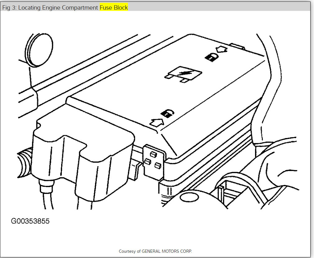

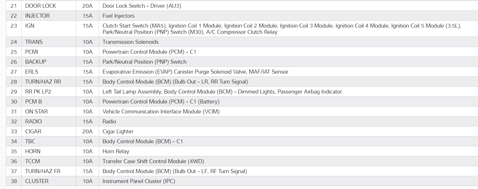

Both cigarette lighters are not working. I believe I might have blown the fuses using my D/C - A/C converter. Where do I find the fuses on the truck so I can replace them??
May 23, 2006 at 2:48 PM
LSUSSEL
  • 252 POSTS

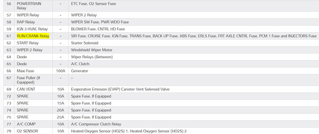

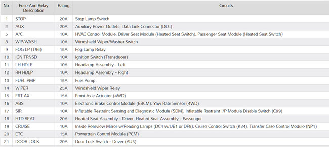

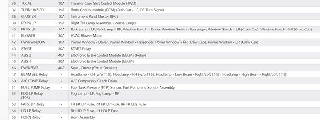

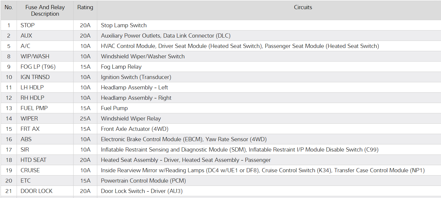

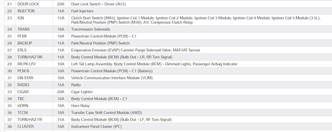

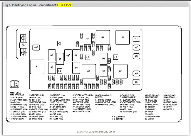

Here is a guide to help you test the fuse and the fuse location below. #33 and #2
Cheers
May 24, 2006 at 2:43 PM
Suggested Repair
Locate cigarette lighter fuses #33 and #2, test them with the fuse guide, and replace any that are blown.
