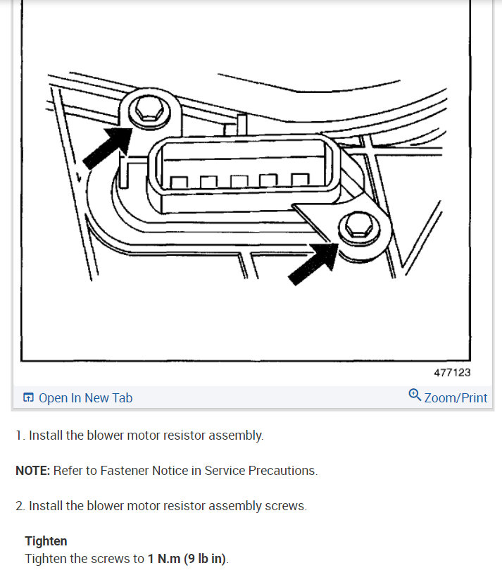

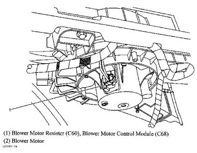

Most likely it is your Blower Motor Resistor.... Look like this....
https://images.2carpros.com/forum/automotive_pictures/188069_04malibubmr_1.jpg
Located on rear of unit......
https://images.2carpros.com/forum/automotive_pictures/188069_04malibubmrlocat_1.jpg

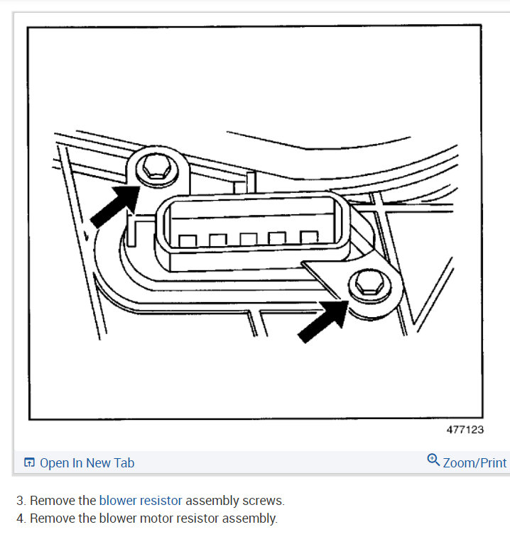

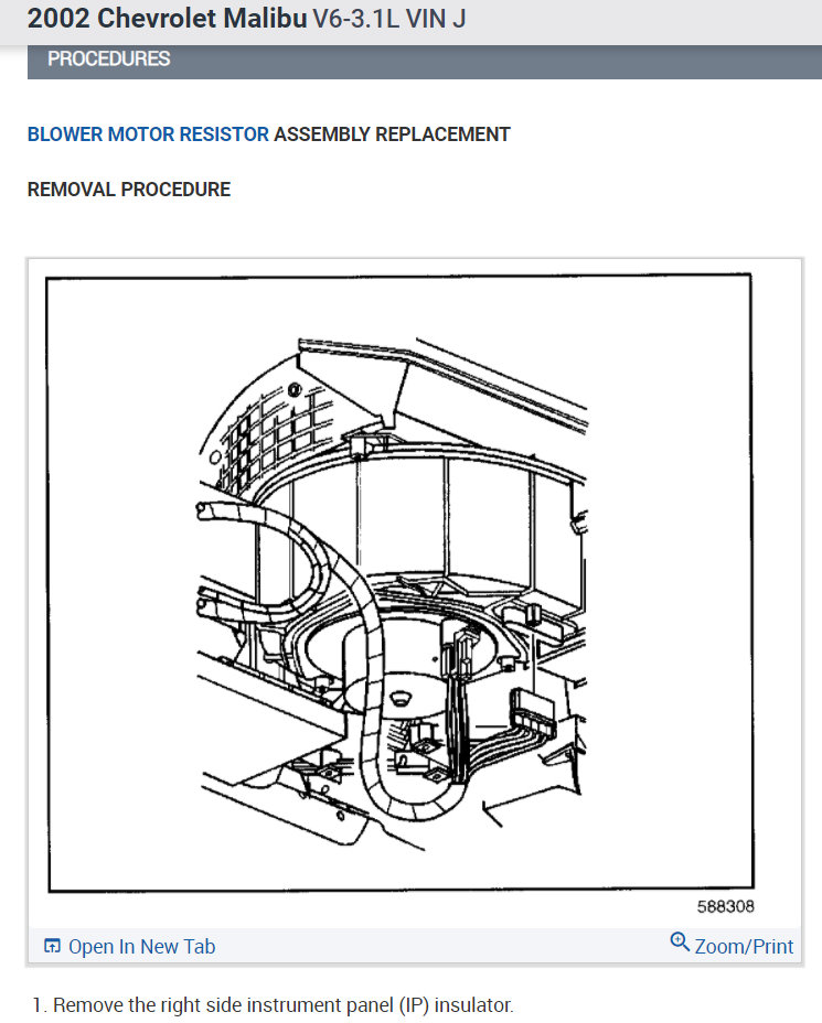

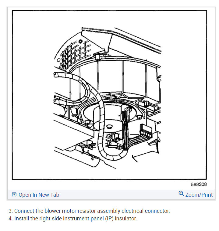

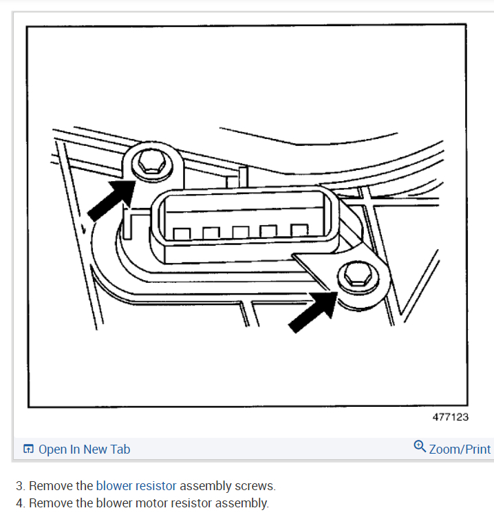

Sounds like the fan speed resistor. Should be in the HVAC plenum near the blower motor, follow the wires from the blower motor to find it. Check out the diagrams (Below). Please let us know if you need anything else to get the problem fixed.

yes you are missing the heater resistor, located under the passengers hush panel. right next to the blower motor. you will see the wires from the blower motor go to it. there are 3 5.5mm or 7/32 screws that hold it in. every single malibu in america needs one. its a ceramic board that will be melted. the new updated one is much heavier. very inexpensive fix.
