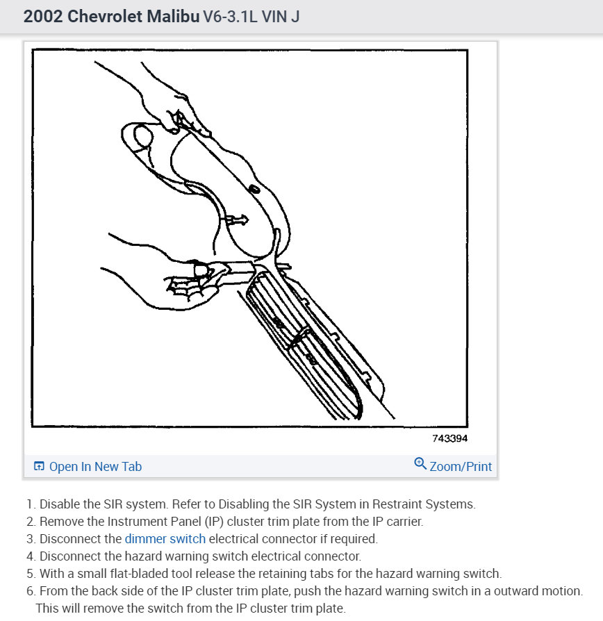

The turn signal only works sometimes and when it doesnt work it helps to put the hazard lights on for a few secs then shut the hazards off and the turn signal works again for a short while. What could this be?
Monday, August 10th, 2009 AT 8:50 PM
BLUELIGHTNIN6
  • 16,542 POSTS

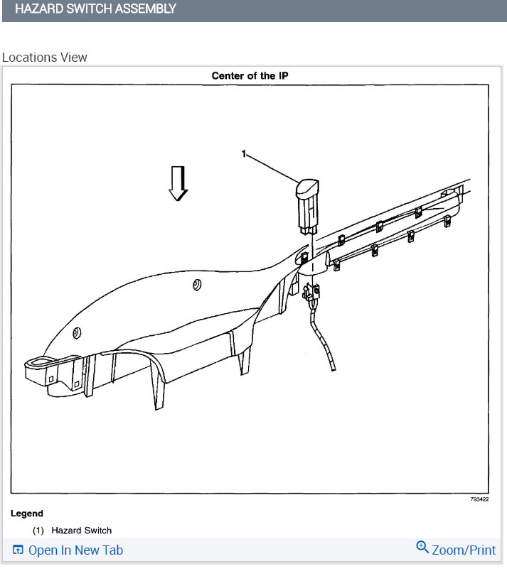

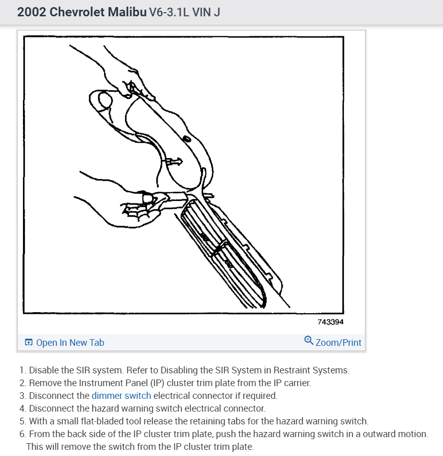

Hello It sounds like a faulty turn signal flasher which has been integrated into the hazard switch. Here are diagrams and institutions on how to replace it below with a guide to help with blinker issues.
https://www.2carpros.com/articles/turn-signals-not-working-blinker
Check out the diagrams (Below). Please let us know what you find. We are interested to see what it is.
