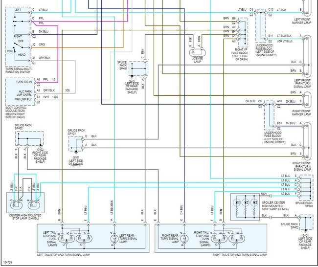

I need help with the turn signals and hazrd lights they dont work all of a sudden
Sunday, December 20th, 2009 AT 2:30 PM
14 Replies
BLUELIGHTNIN6
  • 16,542 POSTS

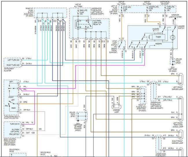

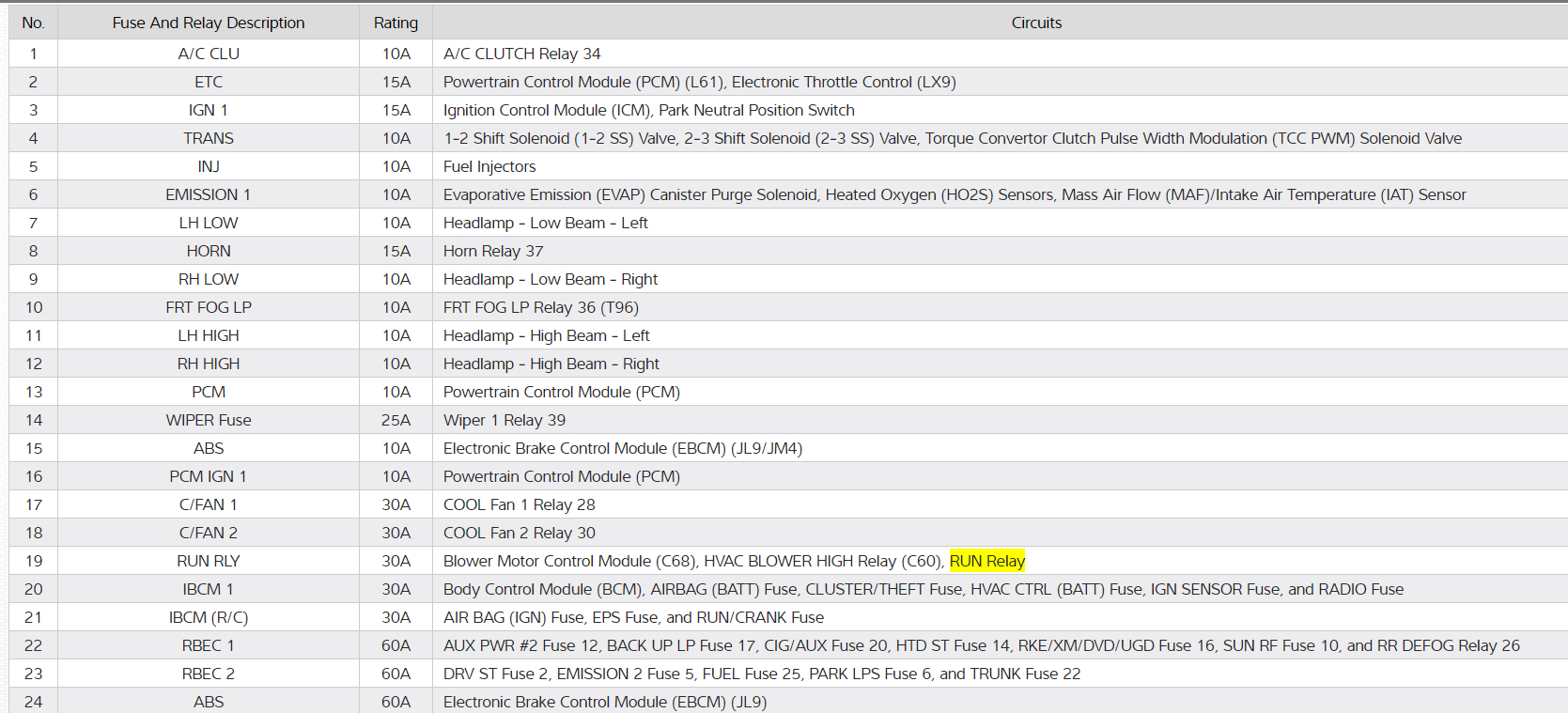

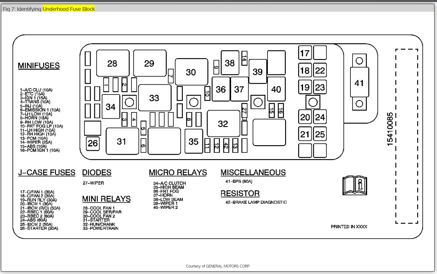

Check fuses (should be 10 amp fuse). If OK then suspect faulty hazard switch on dash. Remove trim plate and remove screw that holds flasher switch in.

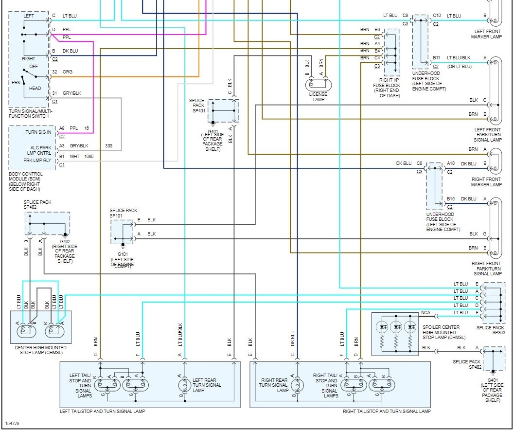

The wiring diagram for your tun signals is attached below
-1

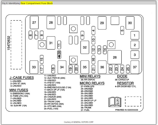

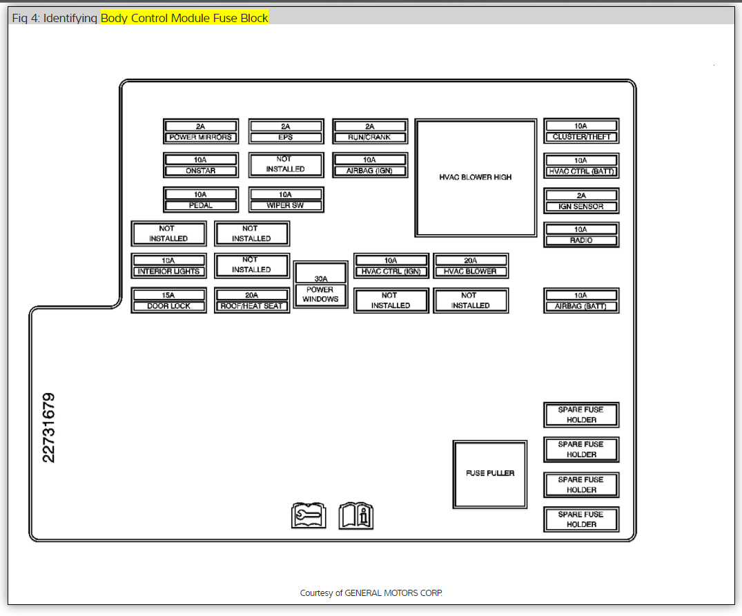

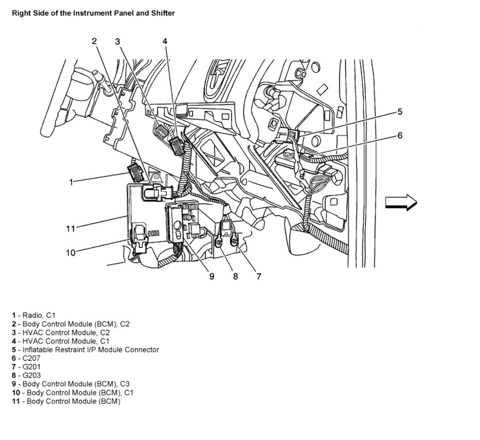

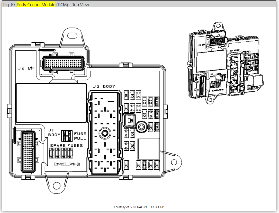

There is a tail light control relay that can go out and cause the problem you are describing. Here is a wiring diagram (below) and some guides to help you get the car fixed.
and
If it all check out okay you have a BCM that is going out, I would find a used one and install it plug and play.
Please let us know what happens so it will help others.
Cheers
+2
Saturday, July 27th, 2019 AT 11:00 AM (Merged)
WV GIRL
Sometimes but if you can restart the car, it sometimes will start working or the next time you hit the turn signal it will start working. I think it is possessed and needs Exorcism! Thanks for answering! I checked everything and it looked okay so I installed a used BCM and BAM! It worked. Thanks again, you guys rock!
