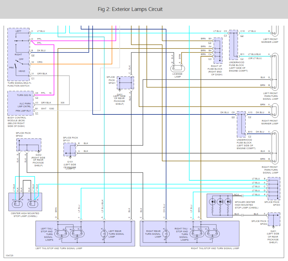

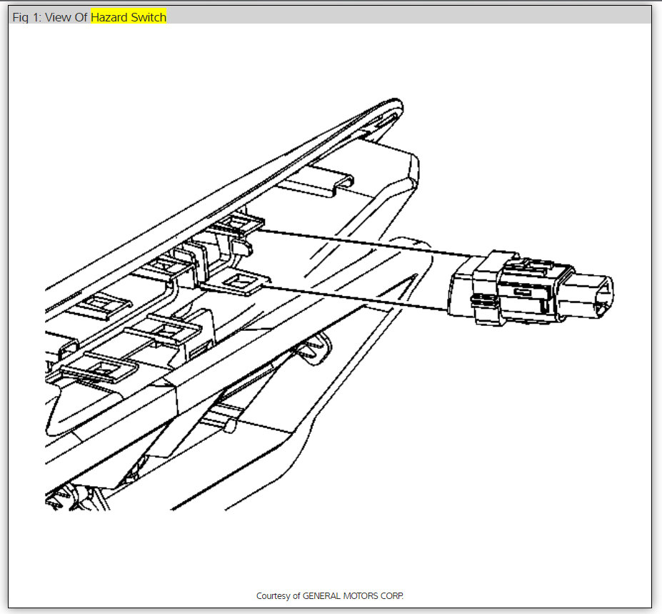

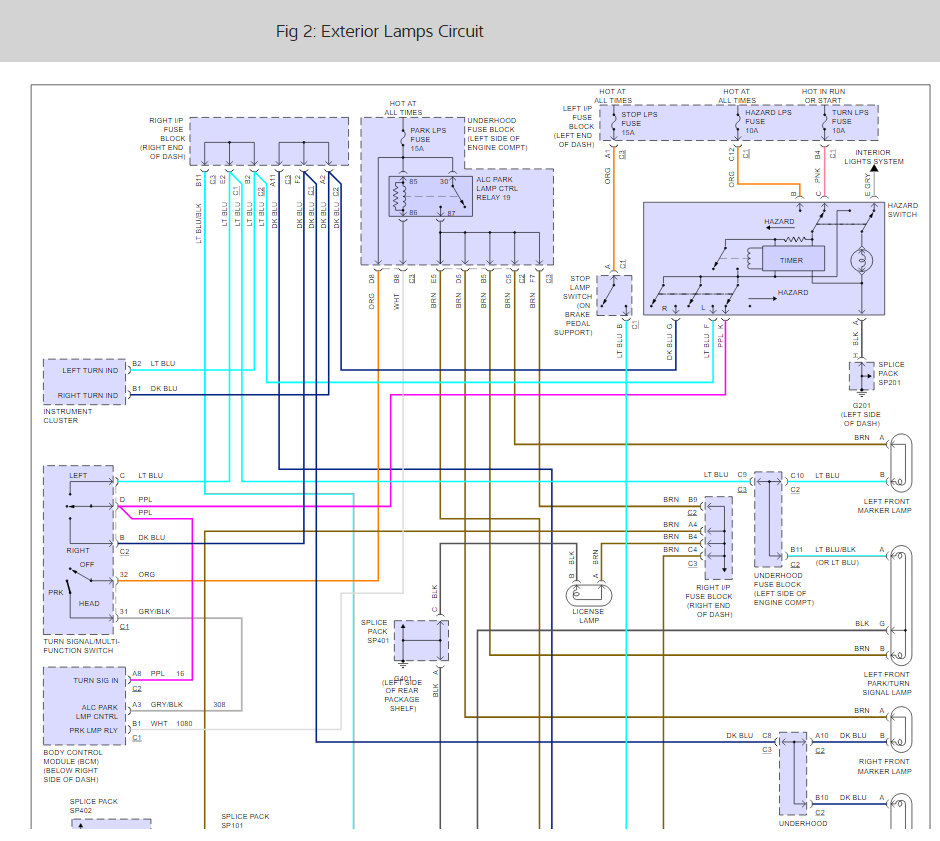

They had big problems with the hazard switch (flasher for both systems blinker and hazard) in these cars which is where the flasher is located. Here is a wiring diagram and a guide to help you test and confirm the problem and the location of the flasher below.
Diagrams (below)
Jul 29, 2017 at 3:32 PM

The switch and relay are built into one unit and are located on the dash, to the right of the instrument cluster.
Jul 29, 2017 at 3:33 PM (Merged)

The turn signal flasher is common to the hazard warning flasher. It is located on the Hazard push button on the dashboard.
