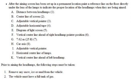

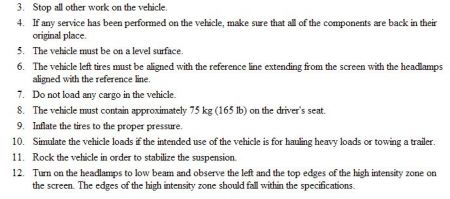

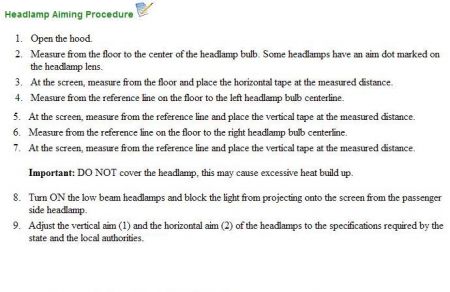

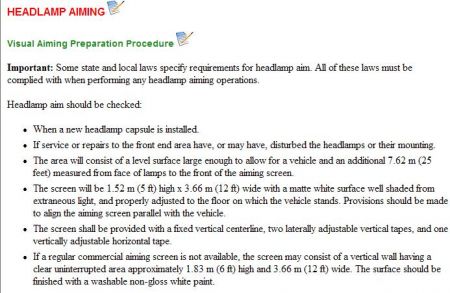

how to adjust headlights on 2002 chevy cavalier
Sunday, October 18th, 2009 AT 10:48 AM
BLUELIGHTNIN6
MECHANIC
16,542 POSTS
SPONSORED LINKS
+1
Sunday, October 18th, 2009 AT 10:08 PM
