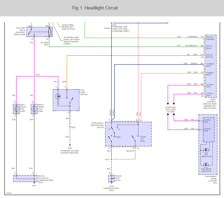

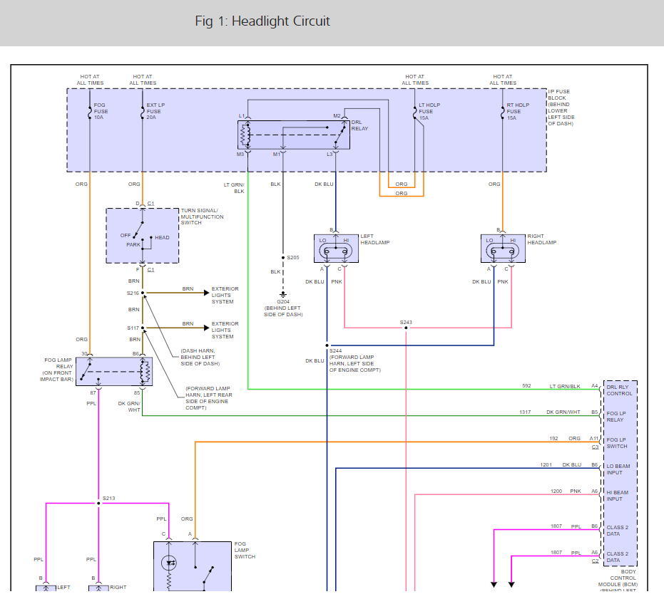

When I switch from my low beam head lights to the high beams the head lights go completely out. The High beam light on the dash lights up, but no high beams. When I switch back to the low beams they work fine. When I start the car up and leave the day time running lights on they flash on and off about 15 times and then the service light goes on on my dash. So my daytime running lamps and normal headlights stopped working. My high beams work fine. I have already replaced my DRL relay, cleaned and hard wired the grounds under the battery box, and cleaned and hardwired the junction box that normally gets corroded under the battery box (even though it wasn't that bad). So when I start the car, everything is the way is supposed to be. But when I disengage the parking brake, My drl relay clicks, my DRL flickers on and than stays off, my DRL symbol on dash flickers on than stays off, then the service engine light turns on. My regular headlights still dont work, but high beams work. Also, both bulbs have been replaced with brand new ones. What might still be the problem? Im scratching my head on this one.
Apr 3, 2009 at 10:05 AM
  • 55,594 POSTS
It sounds like you have a a headlight control switch that is out. Here are the headlight wiring diagrams so you can see how the system works.
Test for power output of the switch to confirm the failure.

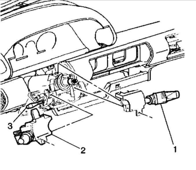

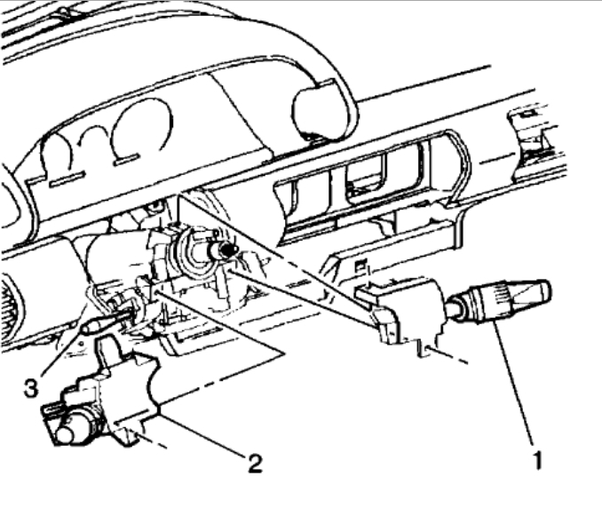

02 chevy cavalier z24 2.4l automaticMy DRL and my low beams will not work, but my high beams will. I have replaced the relay switch and replaced the bulbs still not luck any suggestions?
Feb 22, 2018 at 5:06 AM (Merged)
DOCFIXIT
  • 18,828 POSTS
Suspect faulty multi-function switch
CSPERLAZZA
  • 11 POSTS
I went and bought a new multi-function switch. I am now able to turn the high beams off but i still have no drl or low beams. any other suggestions?
DOCFIXIT
  • 18,828 POSTS
Check splice connector 102 under battery tray known problem due to corrison will interupt ground for LOW and DRL

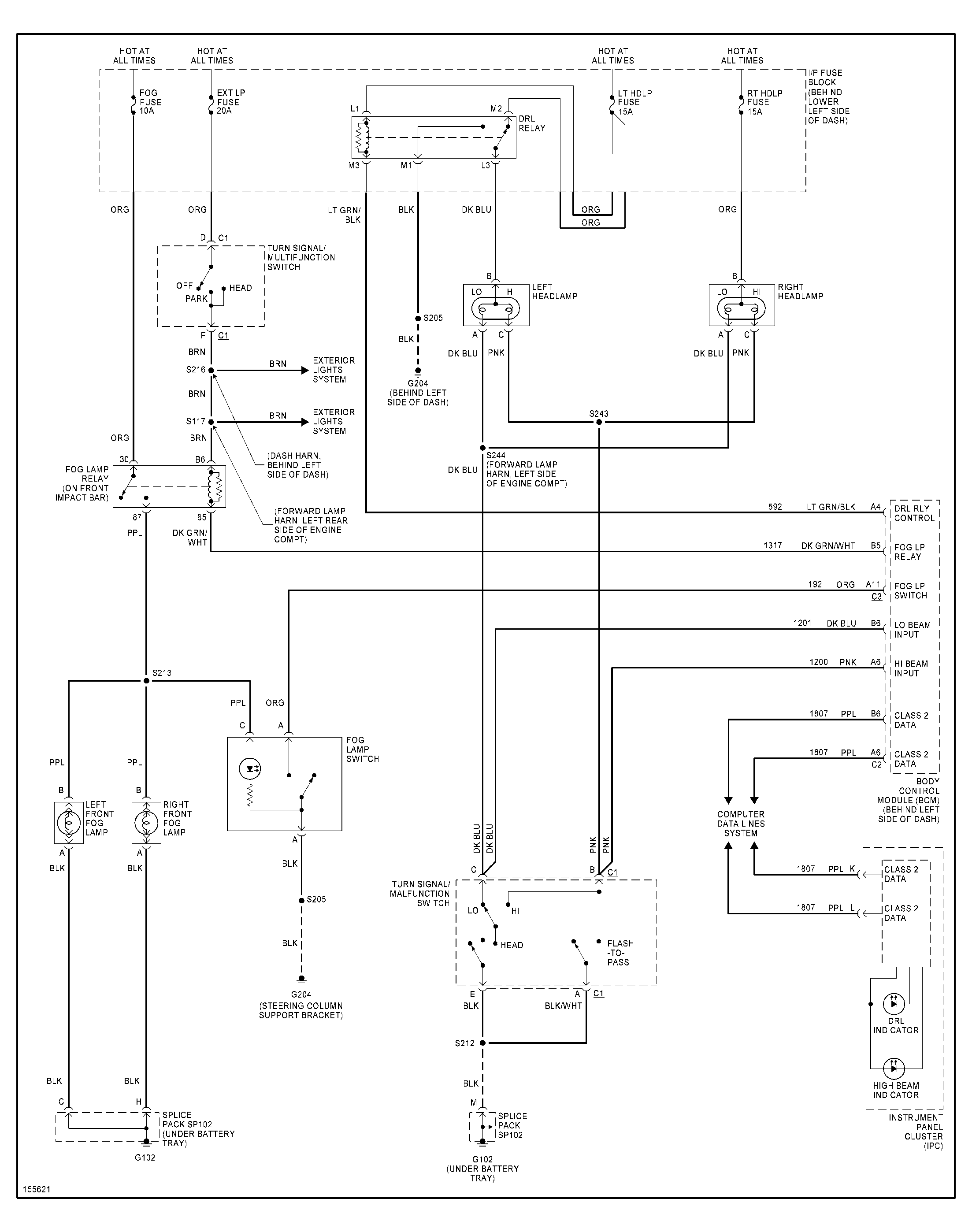

i have low beams but my drl will not work and only the passenger side high beam will come on. At first i had no drl and no low beams only high beams worked. It seems that its the pink wire on the driver side that causing the problem but i am unsure of a soultion on how to fix this pink wire since it works on the passenger side. Please help been trying to fix this problem since wed!
CJ MEDEVAC
  • 11,000 POSTS
I'M SORRY I CANNOT BE MORE HELP...IMMA JEEP CJ KINDA GUY MOSTLY
MAYBE THIS DIAGRAM WITH HELP YOU....IT'S FROM "MITCHELL I", AND IT'S EZ TO READ
IF YOU CANNOT SEE IT WELL---TELL ME
I CAN INITIATE A WAY TO GET YOU THE ORIGINAL DOWNLOAD WITHOUT YOU BLURTING OUT YOUR EMAIL ADDRESS IN OPEN FORUM!
HERE IT IS
THE MEDIC
