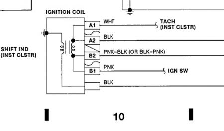

Sorry I am bit confused. There is there is red and white
wire coming to the coil from wire harness coming from inside the car, there is a red and white wire going to
the bottom side of distributer from coil and there is a single thick black wire going from coil to a center of distributer cap. You saying thick black wire is secondary
ground and I need primary ground wire. Witch wire is primary ground? White wire?
Saturday, August 17th, 2019 AT 5:01 PM
JDL
  • 16,098 POSTS
The info I looked at was for camaro rs, 5.0 litre engine. I was talking about the black wire, connector pin A2. The white wire should work, also.

Ok. I only have simple volt meter two wires and little light on it, indicates between 5-50 volts can I use that
and if I hook black wire from volt meter to white wire
where do I hook the red without damaging anything.
JDL
  • 16,098 POSTS
I'm not sure your meter will work for this? The red lead goes to voltage wire, black lead goes to chassis ground/metal part of engine.
