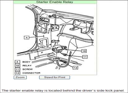

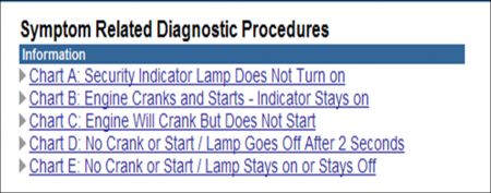

I have a 91 camaro rs 3.1 v6 aytomatic I went to go to work one day and it wouldnt start it wont turn over or anything the battery is good I replaced the starter and ignition switch on the colunm under the dash and still nothing. I read that it could be the vats system so I took my key cylinder apart tnd the wires were broken so I bought a bypass kit with all of the resistors and I tried them all and none of them work either if I jump the starter it will turn over but it wont run without starting fluid and that should be a faulty vats system but my repair manual doesnt show anything about it or how to fix or replace it any info you could give me would be great I dont have any money to have someone fix it and I am trying to do it myself

As for the VATs, that should only last about 3 minutes. . .. . ..I attached that below.
CIRCUIT OPERATION
The brain of the PASSkey(R) system is a special decoder module that reads the pellet resistance through the lock cylinder contacts. It then compares this key code with its own internal code.
If the codes match, the decoder supplies a ground for the starter enable relay and modulates a 5 volt reference signal (at 2.5 volts) from the ECM or PCM which will then pulse the fuel injectors.
If the codes do not match, the decoder module sets its internal timer which locks out starter operation and fuel enable for up to three minutes.
On the pic I have attached. . ...is your car doing which one. . ..because this also talks about the security light on the dash at the same time.
There is also an ignition shut down relay. . ...you could replace it with a like one to see if that makes a difference. The pic is attached.
