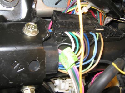

Does it crank over or do nothing at all? If nothing check your connection down on the steering colum. I had a bad ground there and it caused mine not to crank over when warmed up
https://www.2carpros.com/forum/automotive_pictures/454833_89_camaro_2009_006_2.jpg
