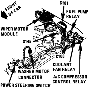

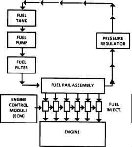

I will start with this car dorve into my garage. It had a bad head gasket. When went to salvage yard and got motor. I put the motor in the car and now it will not start. I know i'm over looking somthing but drawing a blank. Its has spark and fuel presure and compression. I can make the car run with carb cleaner but will not stay runing. If you try starting the car it will run for just a second untill you let off the key I cheack the grounds on the back of the heads ok check fuseable links at the starter. It like the injectors are not working. I put the old injectors and wiring harness out of the old motor and it is getting 12v at the injectors and grounds are their to they just will not pulsated. Thanks rick

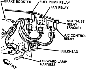

Here is some info on the fuel relay
https://www.2carpros.com/forum/automotive_pictures/248015_2_30.gif
https://www.2carpros.com/forum/automotive_pictures/248015_3_24.gif
When the key is first turned "ON," without the engine running, the ECM will turn the fuel pump "ON" for two seconds. This builds up the fuel pressure quickly. If the engine is not started within two seconds, The ECM will shut the fuel pump "OFF" and wait until reference pulses are present. As soon as the engine is cranked, the ECM turns the relay "ON" and runs the fuel pump.
As a back up system to the fuel pump relay, the fuel pump can also be turned "ON" by the oil pressure switch. The oil pressure switch is a normally open switch which closes when oil pressure reaches about 28 kPa (4 psi). If the fuel pump relay fails, the oil pressure switch will run the fuel pump.
An inoperative fuel pump relay can result in long cranking times, particularly if the engine is cold, and this should set Code 54.
An inoperative fuel pump would cause a no start condition. A fuel pump which does not provide enough pressure can result in poor performance.
I would check the relay if you have good pressure and you know you have spark. . .a good strong blue popping spark when cranking.

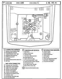

Here is some info on the cold start injector to check.
You have a good filter installed?
See if what I have provided helps at all. I would check fuses, compression; make sure there is good spark, good fuel pressure, the fuel relay, coolant sensor, cold start valve.

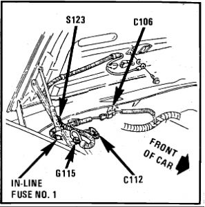

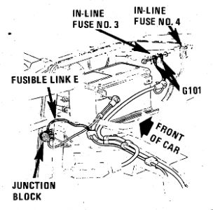

I have attached inline fuse info
Let me know if this helps.
https://www.2carpros.com/forum/automotive_pictures/248015_1_47.jpg
The fuel metering system consists of the following components:
Fuel pump electrical circuit.
Fuel supply components, including:
Fuel lines and pipes.
Fuel pump.
Fuel tank.
Fuel rail assembly, including:
Fuel injectors.
Fuel pressure regulator.
Cold start valve.
Throttle body assembly, including:
Idle air control valve.
Throttle position sensor.
BASIC SYSTEM OPERATION:
The fuel supply system begins with gasoline in the fuel tank. An electric fuel pump, located in the fuel tank with the fuel level gauge sending unit, pumps fuel to the fuel rail through an in-line filter. The pump is designed to supply fuel at a pressure above the pressure needed by the injectors. A pressure regulator located on the fuel rail keeps the fuel available to the injectors at a constant pressure. The unused fuel is returned to the fuel tank by a separate line.

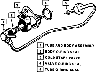

Cold Start Injector
https://www.2carpros.com/forum/automotive_pictures/248015_4_17.gif
DESCRIPTION:

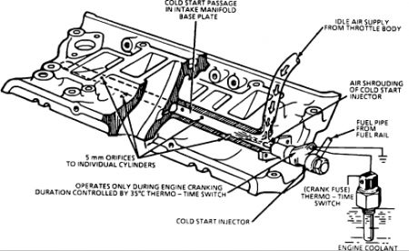

The Cold Start Valve is a non-ECM controlled solenoid operated valve used to provide fuel during the "Starting Mode". It is mounted to the intake manifold and is controlled by a coolant temperature switch. The cold start valve is different from a port injector in that it is not pulsed, instead, it is either on or off.
Fuel from the cold start valve is sprayed into the passage in the intake manifold where it mixes with air from the Idle Air Control (IAC) Valve, and is directed through branch passages to the cylinder ports. By injecting the fuel further back from the cylinders, and adding air to the fuel, the mixture is highly vaporized before entering the cylinders and provides a more combustable mixture for improved cold starting.
https://www.2carpros.com/forum/automotive_pictures/248015_5_12.jpg
OPERATION:
Fuel delivery from the cold start valve occurs only during cranking, and only when the engine coolant temperature is below 35 °C (95 °F). The cold start circuit receives it's power directly from the starter solenoid, and is protected by the crank fuse. The cold start fuel injection switch (thermo-time switch) provides the ground path for the circuit. It is a bimetal switch which opens the circuit at a specified coolant temperature. The bimetal is also heated by the winding in the switch which would allow the valve to stay "ON" 8 seconds at -20 °C or below. The time the switch stays closed varies inversely with coolant temperature. In other words, as the coolant temperature goes up the maximum cold start valve "ON" time goes down.
