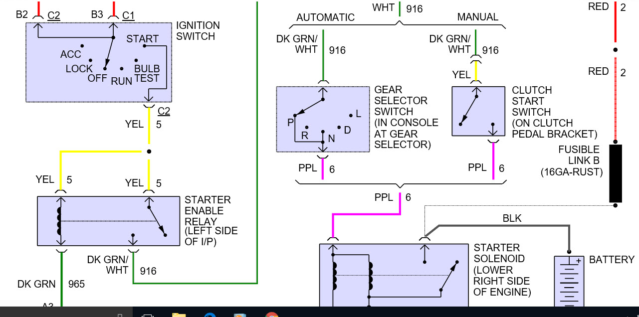

tried to attach to ground wires on the burn off relay and cause a spark. Now the engine will not start. We have power to everything, changed the prom and the ECM. Battery is fine, starter is turning any suggestions to check?

youi probably burnt the fusible link either onstarter or in harness near battery
