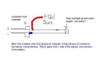

Did you try splicing in a positive line into the injector harness and in the pump so the pump runs as soon as your trying to crank it?
Does that start it?
Do the injectors pulse if + voltage from the battery is spliced in the connector, ill try and draw you up a diagram.
I have bad penmanship so hang with me!
Monday, June 16th, 2008 AT 5:36 PM
BLACKOP555
  • 10,371 POSTS
http://www.2carpros.com/forum/automotive_pictures/66751_graph_1.jpg
