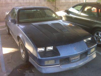

we just bought a 1986 camaro with a 350 after market it will turn over and not fire. We have changed the coil, fuel filter, and tried starting fluid and it will not stay started. Any suggestions? Thanks

Does the engine start for a few seconds with the starting fluid? When you say aftermarket engine, what was the original engine size in the car?

W got it started i hed to rewire the whole starting system with a push button because of some idiot that thought he knew what he was doing, the wires were spliced and bare in a million places and fried out the ignition side of the key switch.
it came out factory with the 305, that was the only V8 option in 86 for that car but now it has a fully blueprinted 350 in it.
