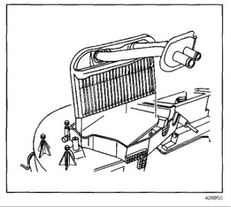

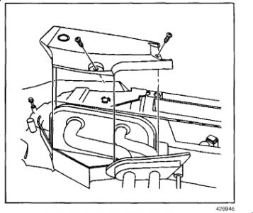

  • 75,992 POSTS
2001 Chevy Truck S10/T10 Blazer 4WD V6-4.3L VIN W
HEATER CORE REPLACEMENT
REMOVAL PROCEDURE
https://www.2carpros.com/forum/automotive_pictures/12900_hcc1_2.jpg
1.Remove the HVAC module. See: Housing Assembly HVAC Service and Repair
2.Remove the heater core access cover screws.
3.Remove the heater core access cover.
https://www.2carpros.com/forum/automotive_pictures/12900_hcc2_2.jpg
4.Remove the heater core from the HVAC module.
