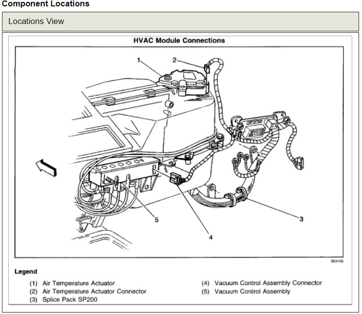

This sounds like you have a temperature blend door actuator that is out and needs to be replaced, Here is a guide to help you get the job done.
Here is where the actuator is on your car.

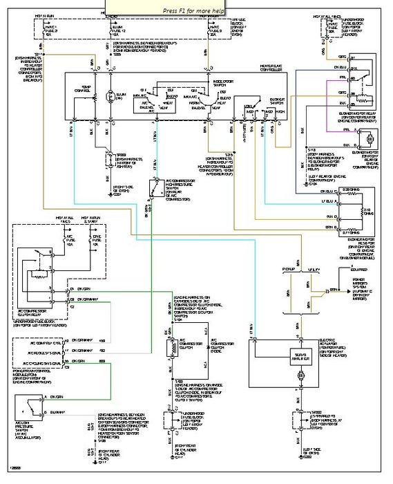

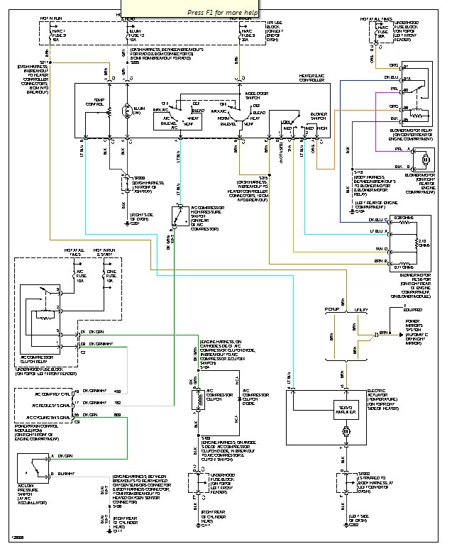

DRCRANKNWRENCH
  • 3,380 POSTS
The heater control is actually electric. I am providing you with the wiring diagram. Follow the left most fuse at the top and it will go down to the heater control temperature solenoid wchich has location on it. I believe it is on heater box. So, check the fuse, then the wires and ground for tight corrosion free fits and grounds should contact clean metal. Then I would suspect the control solenoid.
Before replacing it go get the trouble codes pulled. You can get this done for free at any Adavance Auto or Auto Zone.

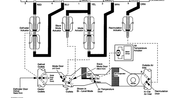

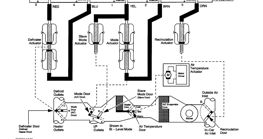

JDL
  • 16,098 POSTS
Also check for hvac codes. Below is schematic, problem with air-temp actuator/door, is possibility?

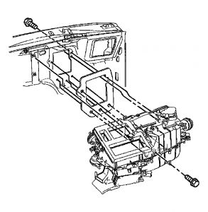

CLIFF DEMOS
Could you explane where vthis is located.Is it visable by just looking under the hood and if so does it look exactly like the pic or could it look a little different?
Thanks
Nov 14, 2020 at 8:05 AM (Merged)
RACEFAN966
  • 5,029 POSTS
It is inside the truck on the passenger side on the heater box behind the glove box. I am not sure exactly were but here is a pic of the heater box part that is behind the glove box. Hope this helps if not get back to me and I will see if I can find better pics ok.
https://images.2carpros.com/forum/automotive_pictures/249564_heater_box_1.jpg
