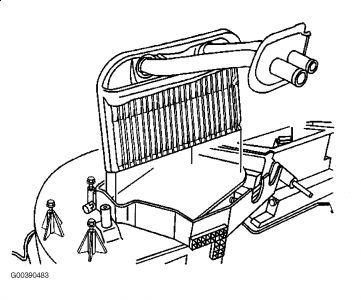

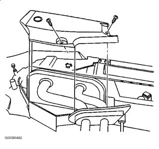

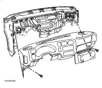

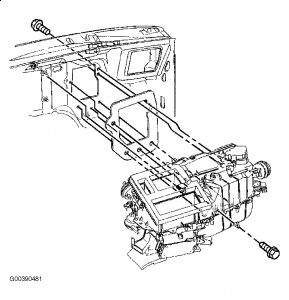

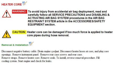

Is there a site out there that would show me diagrams on removing the heat/ventilation module from under the dash.
Apr 6, 2009 at 2:48 PM
BMRFIXIT
  • 19,053 POSTS
https://images.2carpros.com/forum/automotive_pictures/99387_Graphic5_20.jpg
https://images.2carpros.com/forum/automotive_pictures/99387_Graphic2_138.jpg
https://images.2carpros.com/forum/automotive_pictures/99387_Graphic3_65.jpg
https://images.2carpros.com/forum/automotive_pictures/99387_Graphic4_34.jpg
need manual CHECK IT @ https://www.2carpros.com/kpages/auto_repair_manuals.htm _________________

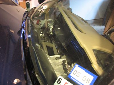

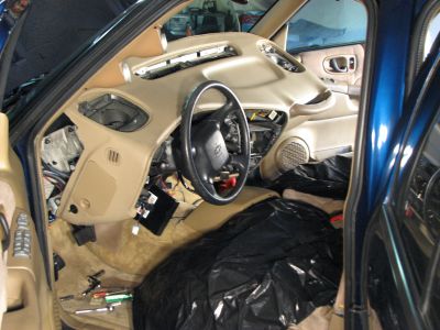

JERRYLMO
  • 27 POSTS

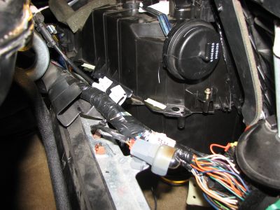

As you can see by the pictures I got the dash to lean out and I took out all the screws of the A/C module box but it's not coming apart. If I lift up on the top of the case it gaps open but it appears it's still connected together. To go further It looks like the dash is actually going to have to come out. This appears to require letting the steering column down, unplugging several major electrical connections and getting into the Air Bag controls. That's really my biggest concern, after all this I'd hate to fire off the air bags and add that to the job. Any help is appreciated! Thank you, Jerry
https://images.2carpros.com/forum/automotive_pictures/81647_IMG_0744_1.jpg
https://images.2carpros.com/forum/automotive_pictures/81647_IMG_0747_1.jpg
https://images.2carpros.com/forum/automotive_pictures/81647_IMG_0750_1.jpg
https://images.2carpros.com/forum/automotive_pictures/81647_IMG_0753_1.jpg
Aug 19, 2020 at 1:21 PM (Merged)
CHEVY22
  • 1,375 POSTS
go under the hood ontop of the evap core , and there sits the blower motor resistor , there are three bolts , you will not be able to see them but there is a cutting guide on the housing to cut the plastic to reveal the bolts 5.5mm once the resister is pulled look down into the box and you will see one 10mm bolt that needs to come out , also there are two under , one is behind the right exhasut manifold and the other is same height but closer to the right wheel , these two go to studs on the lower right corner of the ac module and one right next to the heater hoses and its out , sorry about that i thought you meant just the dash , warning the one behind rhe exhaust manifold is tricky 10mm one turn at a time , and if you do want more room you can drop the column should be 4 retainers 10mm and two column boilts 15 mm but i alway snuck em out without it , its tougher but savers about 20 minutes in the round trip, oh and i never unplug anything i always more a harness from a clip if needed , no sense in pulling what you dont need, as long as the battery is disconnected the air bags will be ok , remember all you need to do is to pull the module out enough to clear the heat core lines on the inside of the firewall to remove the two top cover bolts , thats why i never go too far
JERRYLMO
  • 27 POSTS
I was able to locate and remove all the fasteners you told me about and I even found one extra. However, the whole box wiggles but isn't coming away from the firewall. Does it have anything to do with air distribution vents on the bottom of the box for heating? They seem to be separate but I'm wondering if they're in the way. I'm so close to getting the core out and this one last thing is holding up the show. I haven't given up though.

JERRYLMO
  • 27 POSTS
Indeed there were the fasteners you told me about but there was one more WELL HIDDEN lag bolt looking thing that went in from the firewall and fastened the outside Evap cover going all the way through into the A/C box. It took me an hour to find it but it's right by the passenger side valve cover on the fire wall. It took a 24" 3/8 drive extension and a 10mm universal socket to get to it and that was pretty tight. Once I took it out the whole box popped right out and I'm about to remove that *^&%&*@## heater core. Now if I can just remember how it all goes back to gether. :mrgreen:
