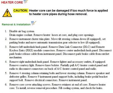

how do i change the heater core in my 96 blazer?
Aug 19, 2020 at 1:24 PM (Merged)
BLUELIGHTNIN6
  • 16,542 POSTS
https://images.2carpros.com/forum/automotive_pictures/261618_Noname_1954.jpg

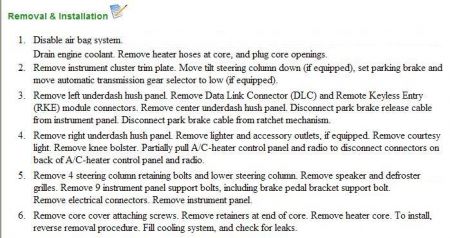

JBENNETT419
Heater problem
1996 Chevy Blazer 4 cyl Two Wheel Drive Automatic
how do you change a heater core in a 96 chevy blazer
BLUELIGHTNIN6
  • 16,542 POSTS
https://images.2carpros.com/forum/automotive_pictures/261618_Noname_1309.jpg

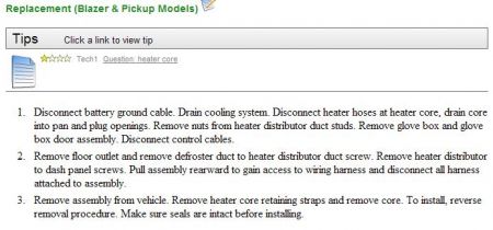

PIATTGIRL
Heater problem
1983 Chevy Blazer 6 cyl All Wheel Drive Manual
how do i change the heater core on my 83 blazer i have antifreeze coming into the car an its all wet on the passnger side of the floor an when i turn on the heater you can smell antifreeze
Aug 19, 2020 at 1:26 PM (Merged)
MHPAUTOS
  • 31,937 POSTS
HI there, See text for procedure , there are no pics to support this operation sorry. Mark (mhpautos)
