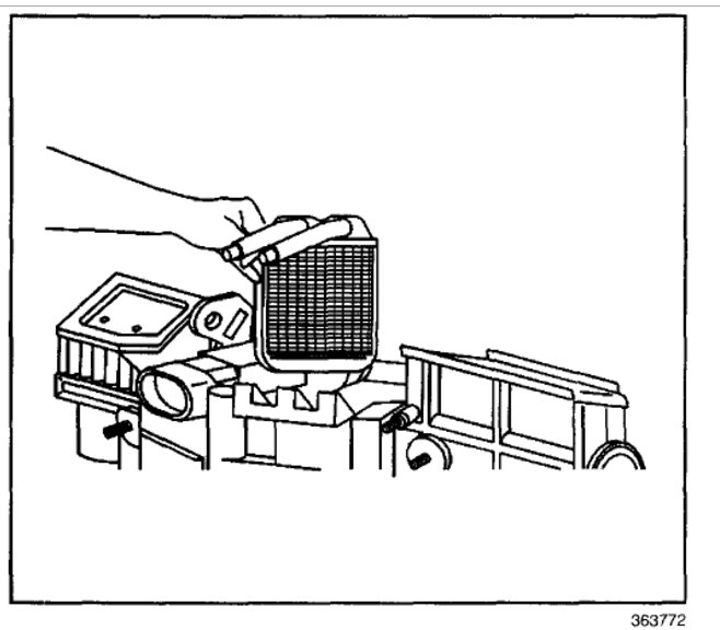

BLUELIGHTNIN6
  • 16,542 POSTS
REMOVAL:
Remove the HVAC module-auxiliary.
Remove the screws from heater core cover-auxiliary from the HVAC module-auxiliary.
Remove the heater core cover-auxiliary.
Remove the HVAC module pass thru seal-auxiliary.
Remove the heater core-auxiliary from the HVAC module-auxiliary.

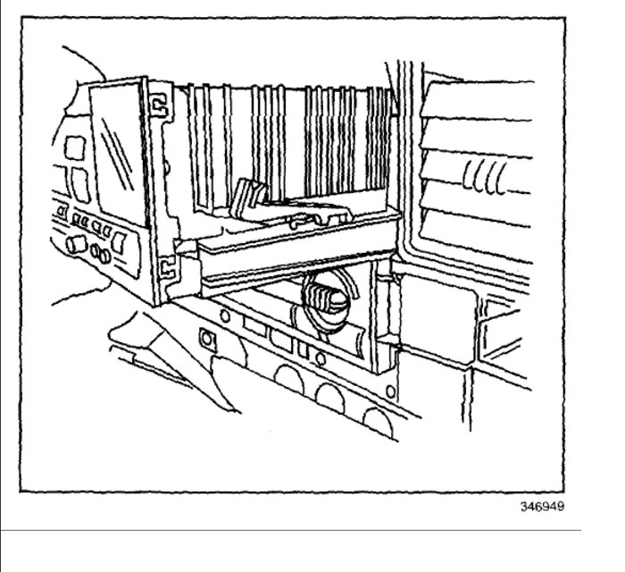

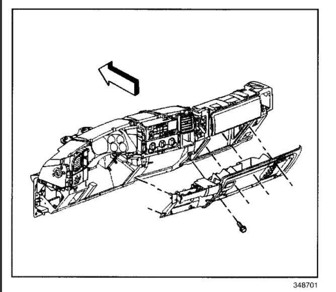

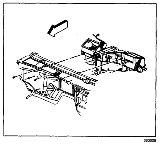

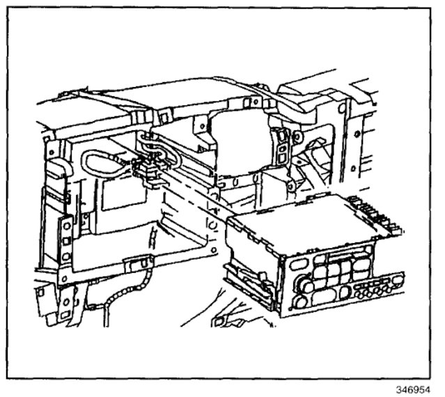

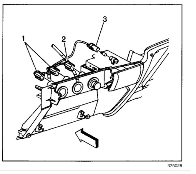

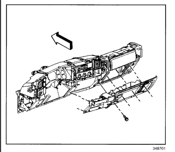

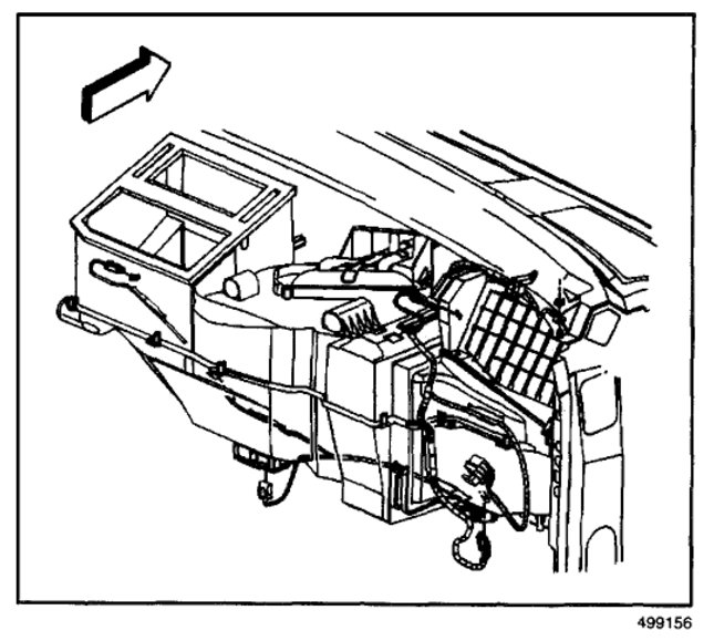

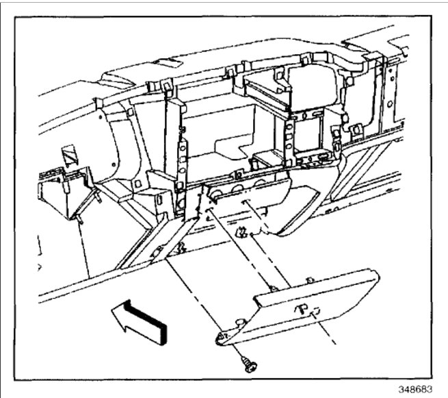

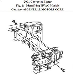

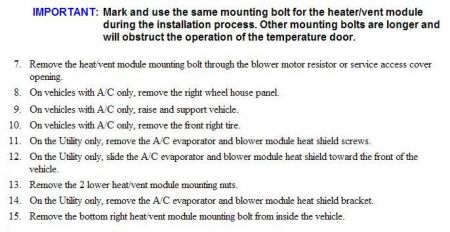

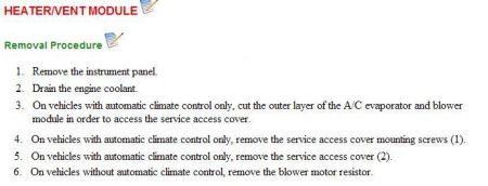

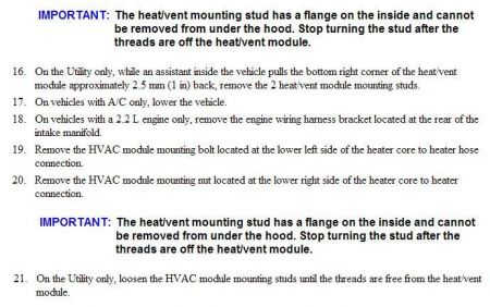

MICAMIL
Heater problem
2001 Chevy Blazer V8 Four Wheel Drive Automatic
have the dashboard out put there is a mounting unit around the heater core that I can not get off.
Aug 19, 2020 at 1:11 PM (Merged)

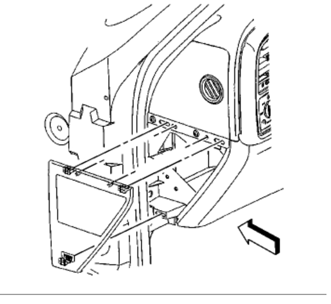

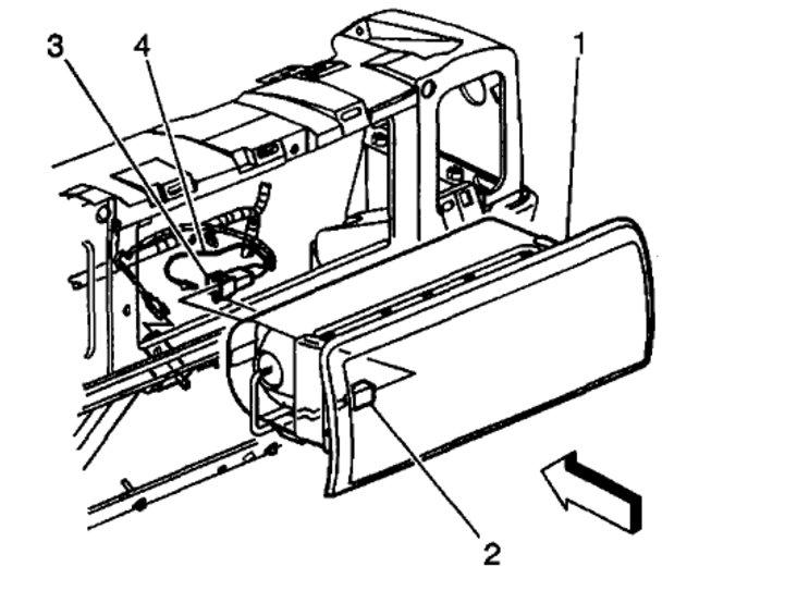

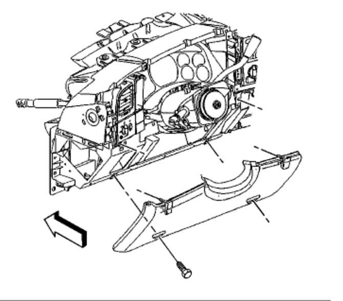

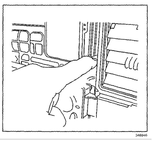

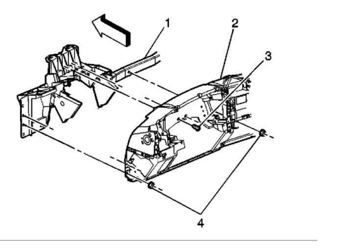

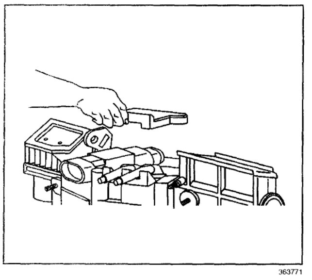

BLUELIGHTNIN6
  • 16,542 POSTS
https://images.2carpros.com/forum/automotive_pictures/261618_Noname_1582.jpg
https://images.2carpros.com/forum/automotive_pictures/261618_Noname2_483.jpg
https://images.2carpros.com/forum/automotive_pictures/261618_Noname3_181.jpg
https://images.2carpros.com/forum/automotive_pictures/261618_Noname4_90.jpg

DENNYP
  • 1,824 POSTS
you will have to remove the entire dash assembly and the heater box assembly. Then you have to disassemble the heater box to get to the core. Labor guides list it at around 7 to 8 hours labor.

I have a 2001 Blazer and the heater core started leaking on it last summer. On page 18 of this Blazer forum is a question titled "Accessing the heater core on a 1998 Blazer". That caught my attention since I needed to replace mine. Thanks to the technician I got all the info I needed to do the replacement. I posted some pictures to give you an idea of what you'll be looking at if you do it yourself. It's NOT a project I'd suggest getting into unless you have the time, tools and patients to complete. Something I learned the hard way, three weeks after I replaced the heater core it would only blow out hot air. There's a little gizmo called the blend door actuator that makes the air blow over the A/C evaporator coil or the heater core, or both. Mine died and guess what? You have to pull the dash to get to it too! If/when you have this done have them replace the actuator. They're not expensive and could save you several hundred dollars by not having to pull the dash again just to replace it.
Aug 19, 2020 at 1:13 PM (Merged)
DENNYP
  • 1,824 POSTS
You are correct. This is not a job for the beginner. It's a full day of hard labor to change a $25 part.

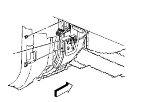

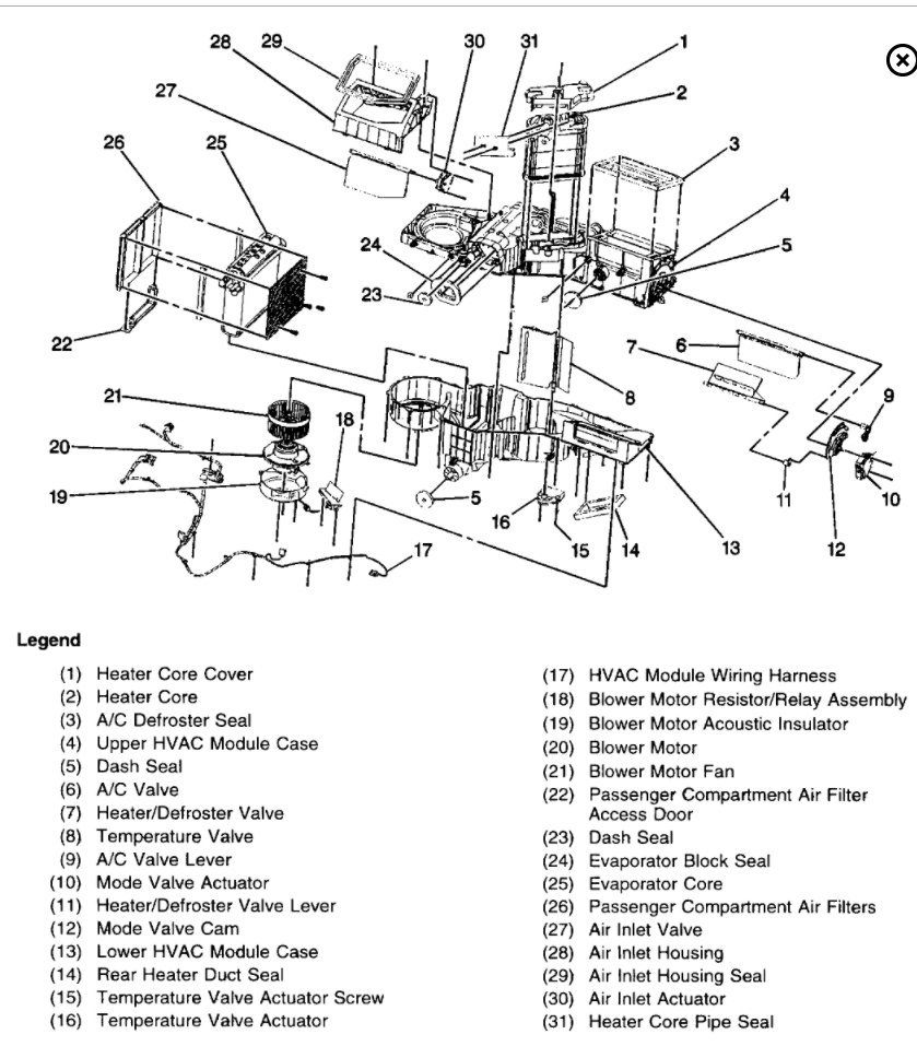

PAINTERGIRL0319
Heater problem
2001 Chevy Blazer 6 cyl Two Wheel Drive Manual
Just replaced the heater core... I have heat and no more leak... without tuning on anything while driving.. air is coming out of the vents... ..can adjust the temp by just turnig the temp dial??? When I do turn on the heat it comes out of all of the vents... floor and the defrosters...so I have no control on the dials....what is wrong??? Just happy for heat.
  • 110,240 POSTS
In this case, you are looking for a vacuum leak. The vent doors are actuated by vacuum. Check under the dash and under the hood for disconnected or damaged hoses that would cause this. By accident, you may have forgotten to replace one or bumped one.
Let me know what you find.
SERVICE WRITER
  • 9,123 POSTS
There is probably an electrical connector that was not hooked back up to the HVAC Module which is removed to replace the heater core.
https://images.2carpros.com/forum/automotive_pictures/30961_xabla_1.jpg
Check to make sure there is not a connector not hooked up or some controls will not work.
