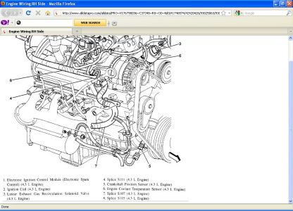

where is the engine coolent temperture sensor located on a 1996 Chevy Blazer
Tuesday, August 20th, 2019 AT 1:27 PM (Merged)
SATURNTECH9
  • 30,869 POSTS
https://www.2carpros.com/forum/automotive_pictures/416332_1996_blazer_coolant_temp_sensor_1.jpg
It's number 6 in the diagram it's by the egr valve.
