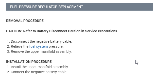

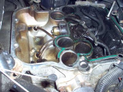

Jim, 2 things. 1. About 2 years ago, I replaced the fuel pump. I also replaced the fuel filter which was insanely clogged which is why I am assuming is why the fuel pump failed in the first place. In addition, the fuel pump makes the sound for 2 seconds as soon as I turn the key forward before starting the engine so I know its at least pumping fuel to the engine. When I replaced the fuel pump, the engine ran fine but then it slowly started getting harder and harder to start until it stopped starting and I have to dump gas in the throttle body before I crank it to start it. I will check the fuel pressure this week or this weekend. 2.I do not understand where you are telling me the "fuel pressure regulator" is located. Do i need to remove the "intake manifold" to get to the fuel pressure regulator? Is it actually mounted on the fuel rail? Are there any pics or diagrams you could show me or direct me to so i can see exactly where the regulator is located? I found this image online on another website. Is this fuel pressure regulator (92 thru 95 4.3 Vortec) in the same place as mine (1999 Vortec) located under the intake manifold?
https://images.2carpros.com/forum/automotive_pictures/112705_IM000109_1.jpg
May 26, 2020 at 4:45 AM
CHEVY22
  • 1,375 POSTS

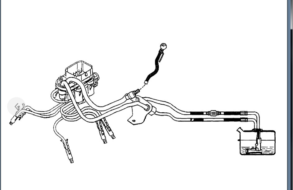

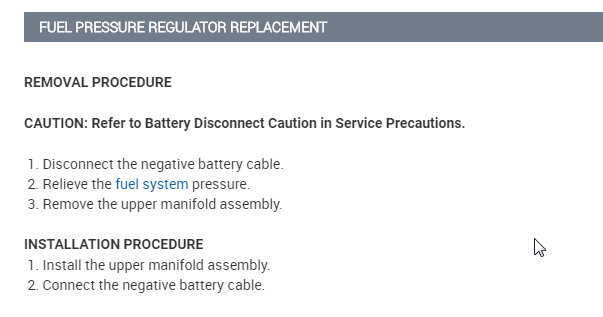

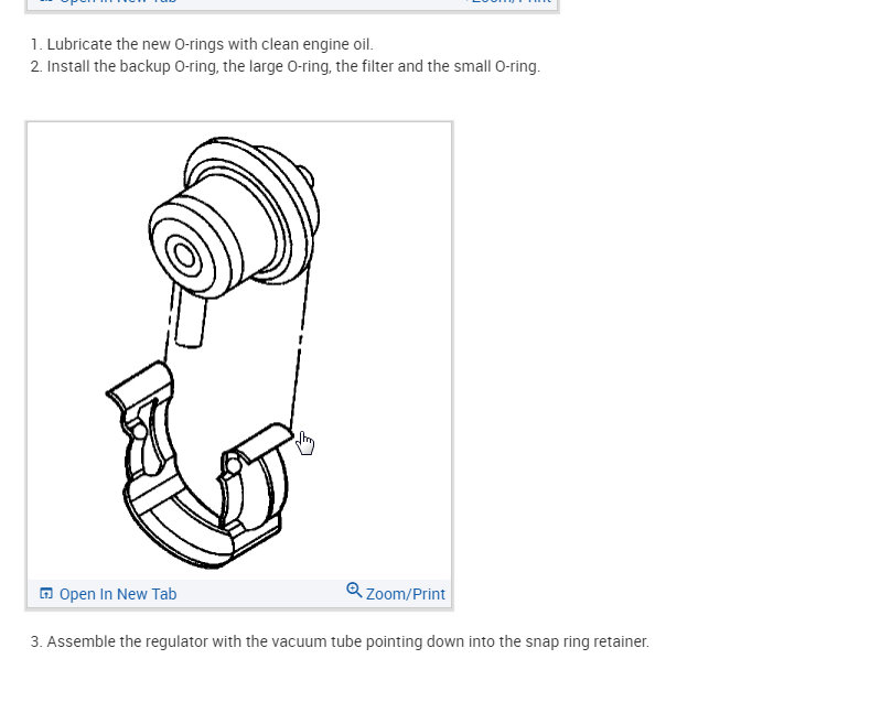

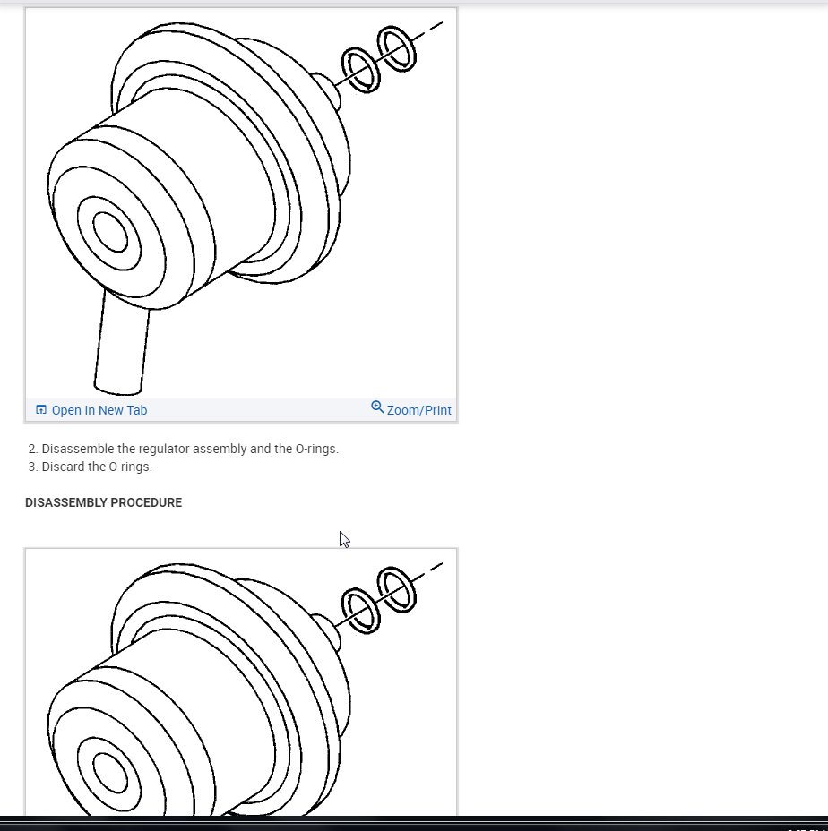

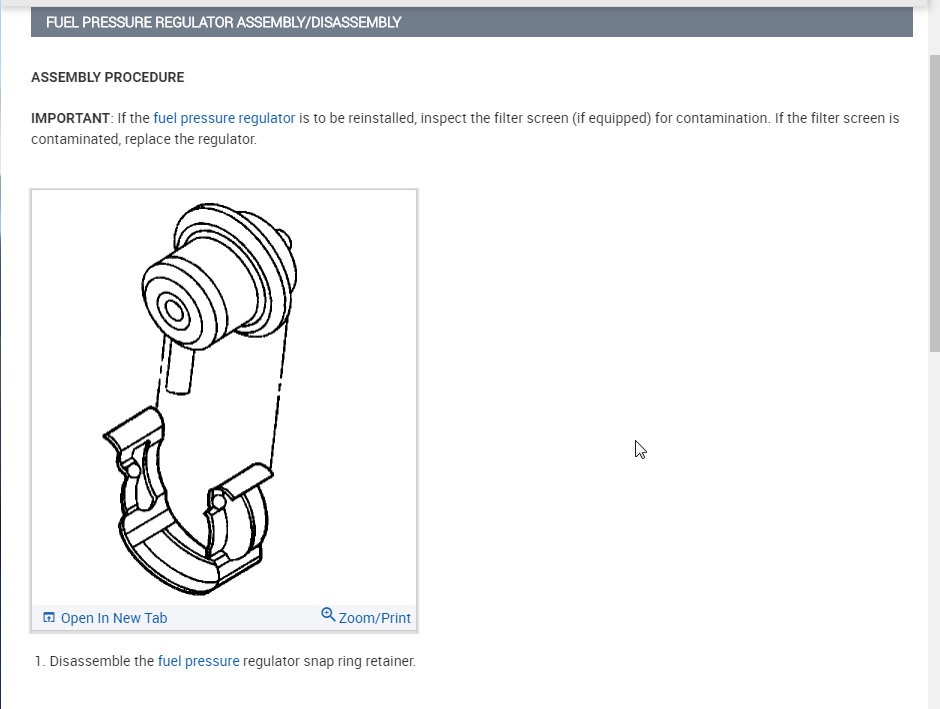

i can't find a picture, but yes the upper intake has to come off , once it is off the regulator is back by the distributor.

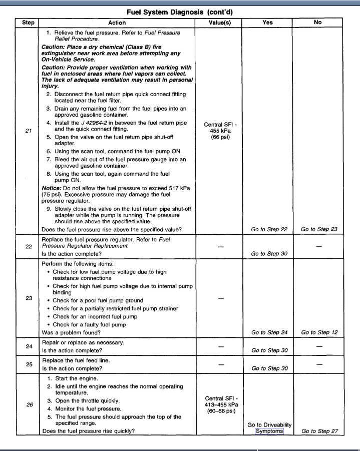

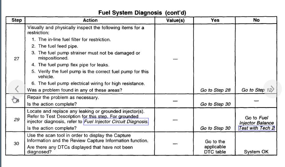

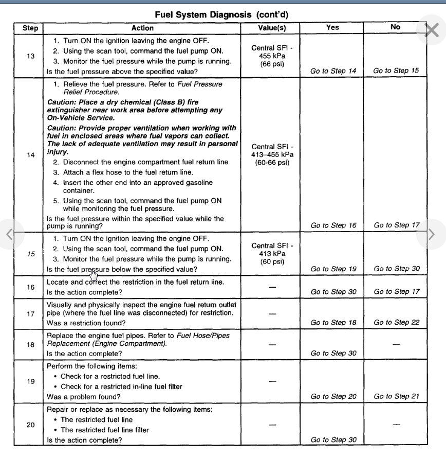

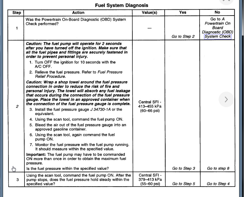

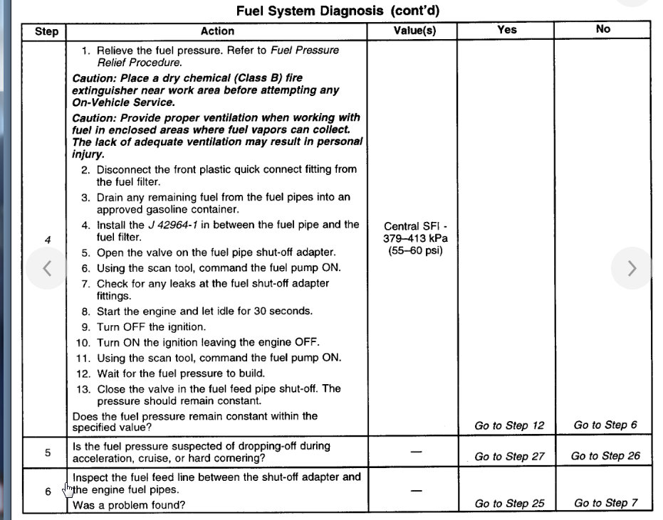

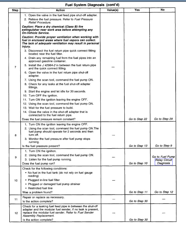

After reviewing all this info, I am pretty confident that the issue is fuel related. We just need to limit down the possible causes. The regulator could definitely be the issue and needs to be tested. I attached the process to replace and disassemble the regulator but more importantly is the testing of the fuel system.
We need to completely run through this test and identify the issue in the fuel system. I would highly suggest this is done prior to removing the intake manifold to replace the regulator.
As stated you should have above 60 PSI when you turn the key on and if you don't then that confirms it is a pressure issue then it is a matter of identifying the cause. Don't get caught in the trap of having replaced the pump or any other part in the recent past. Unfortunately we get faulty parts out of the box. We have all been burned by that so if it has been a few years, it could have definitely failed.
I think it is clear that you and others suspect this is a fuel issue so the only way to track this down is run through this material. Please report back and we can go from there. Thanks

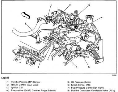

I suspect the PCV valve but cant locate it per the manual It shows at the top of the engine but cant locate Please help
Sep 10, 2020 at 5:42 AM (Merged)
  • 75,988 POSTS
Positive Crankcase Ventilation Valve Location: Throttle Position (TP) Sensor, Idle Air Control (IAC) Valve, And Positive Crankcase Ventilation Valve (PVC)
