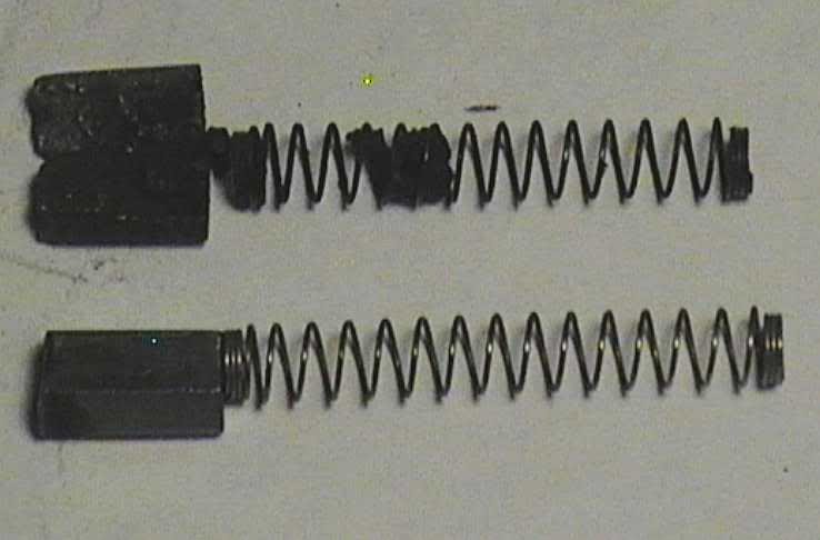

More fuel pump information. If you own an S10, Astro, Safari, Blazer, Jimmy or Bravada (are there more?), You're probably familiar with fuel pump problems or will be soon.
I dissected my old fuel pump and found surprises. I found that behind one of the two carbon brushes in the electric motor, the metal spring was heavily carbonized, shortened and weakened by apparent overheating. The carbon brush itself was fractured and jammed in it's socket. I'm just guessing, but if the brush couldn't move freely it wouldn't continue to make good contact with the commutator, which would inhibit current flow. Current flow would likley also have been inhibited by all the carbon buildup on the spring, since the current flows from brush to spring to contact to power or ground wire or vice-versa. I've included an image where you can see that the burnt spring (top of picture) is about 2-mm shorter than the good one. Also the burnt carbon brush is in 2 pcs in the photo. It broke apart as soon as I removed it from it's socket in the motor.

No fireball because no air. The mix is to high in fuel to ignite. It is one of the reasons why you use an inert gas when you do EVAP testing. If you used shop air it could make the mix flammable.
The pulse damper is in the housing that the tube you pointed at is attached to. Between the tube and the damper it limits the pulses that the system sees.
Bad brushes and warn commutators are the common failure point.
Oh and those modules can be rebuilt as well. You just need to buy a pump for a 94 S Blazer with the W engine. Then you need to disconnect the tube and crimp it onto the new pump. Then install the pick-up sock.
