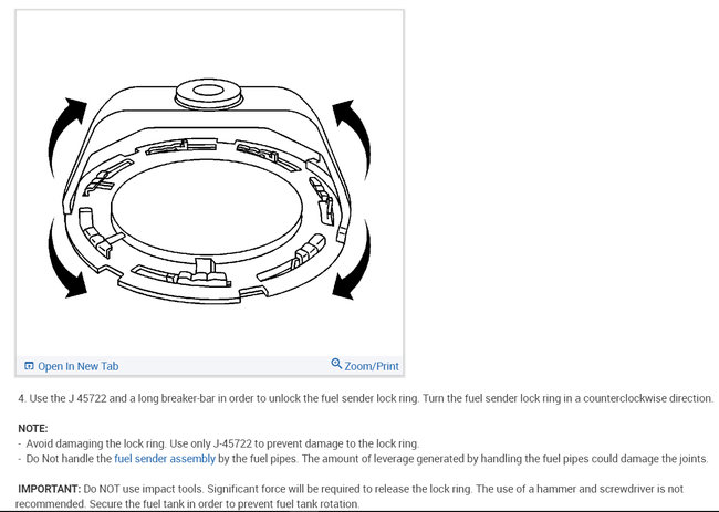

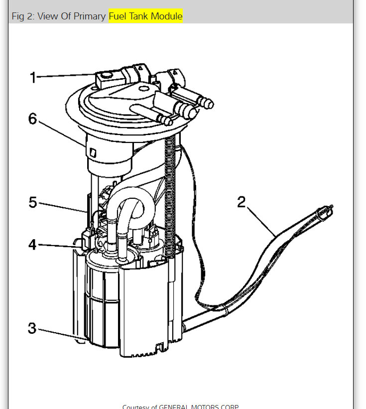

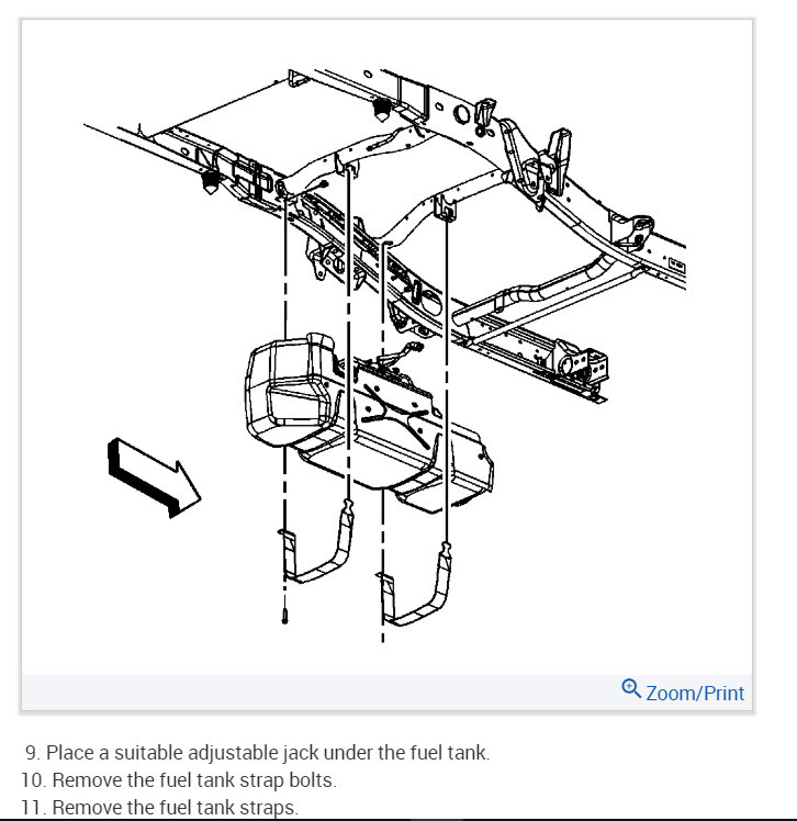

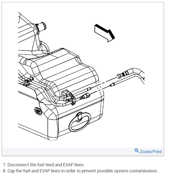

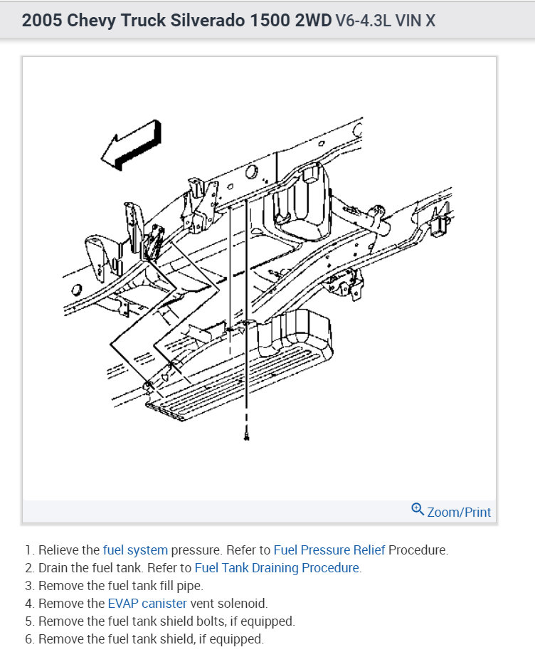

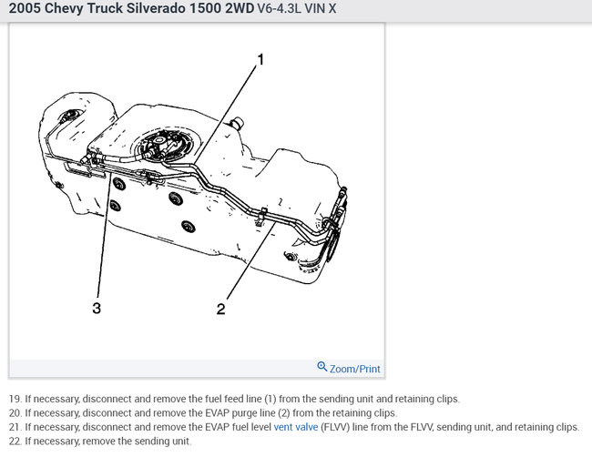

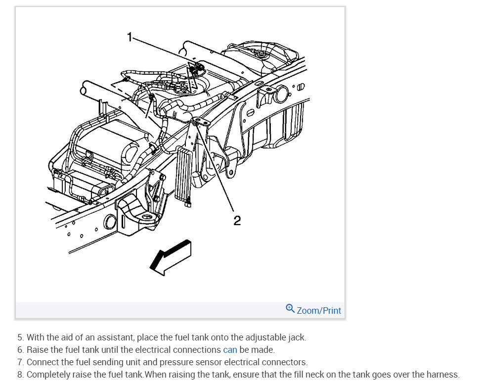

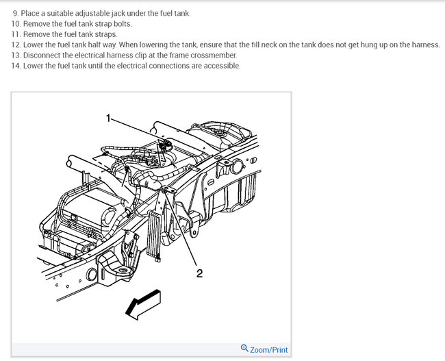

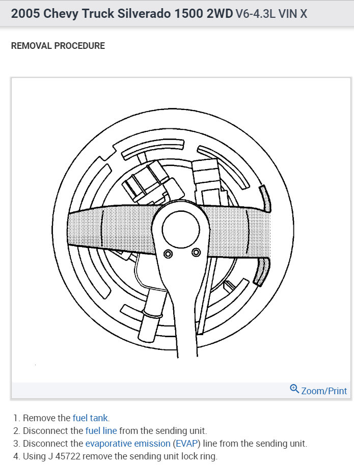

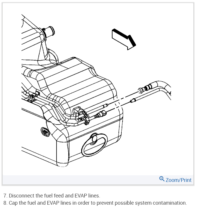

An in tank fuel pump will require alot of help. First if your from up north and they use salt on the roads in the winter you'll want somebody there that can replace brake lines if you crack one or two. You may also crack metal fuel lines. Empty the tank as much as you can. With the truck jacked up you loosen the straps holding the tank up. Then undo all electrical and fuel connections. Drop the tank, it may take two people. With the tank out you turn the ring holding the sending unit in the top of the tank the pump is on the sending unit.
Here are the instructions on how to change out the fuel pump in the diagrams below. Check out the diagrams (Below). Please let us know if you need anything else to get the problem fixed.

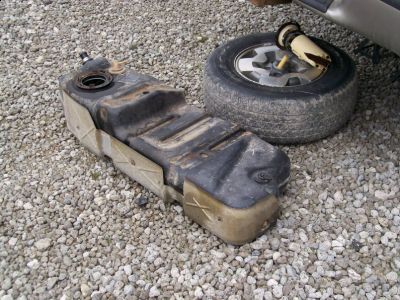

TIMA44

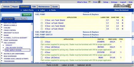

I have dropped my tank and pulled out my fuel pump.The problem is when I call around for a replacement part. They want to know if my heat shield is on side or raps around front. Mine does go down the side of tank but also runs around to half of the front of tank. So witch one do I say I need?
https://images.2carpros.com/forum/automotive_pictures/351908_gas_tank_003_1.jpg
Dec 19, 2019 at 3:04 PM (Merged)
  • 75,992 POSTS
You probably better off checking with the dealership Read below info-

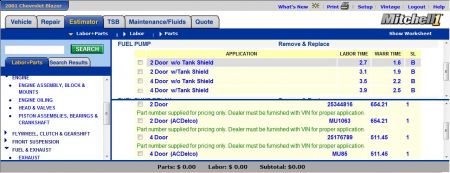

TQUARLES
I was wondering what is the estimated cost on replacing a fuel pump on my 2001 Chevy Blazer 2 door truck. A local garage I frequent quoted a price of approximatly $1000.00. Even not knowing much about cars, this seems very high.
Also, is this something that a "weekend mechanic" could do and still be safe for me to drive?
Dec 19, 2019 at 3:05 PM (Merged)
  • 75,992 POSTS
See quotes
