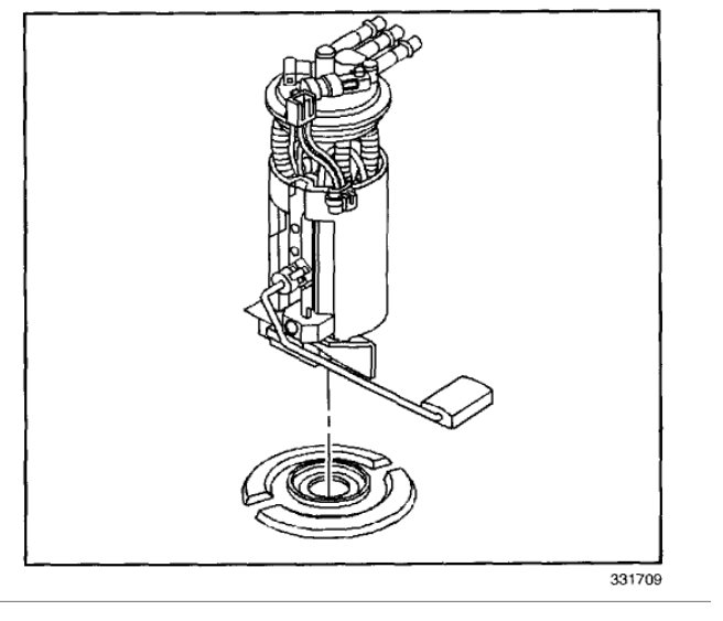

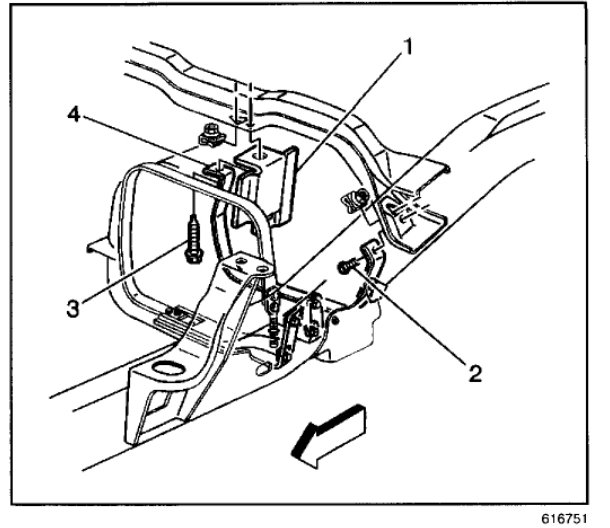

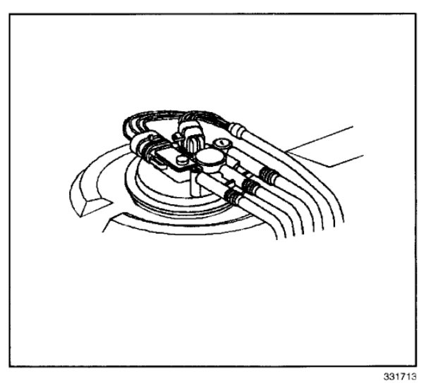

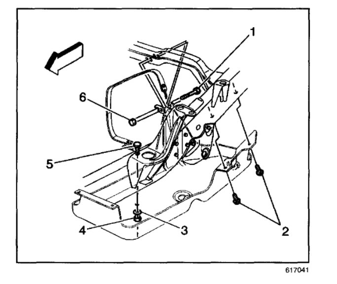

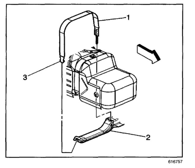

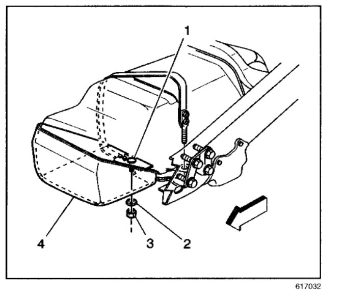

what do i need to do to replace the fuel pump?
Jul 9, 2009 at 2:19 PM
BLUELIGHTNIN6
  • 16,542 POSTS
Here is a guide to help walk you through the steps and diagrams with instructions below to show you how on your car.
https://www.2carpros.com/articles/how-to-replace-an-electric-fuel-pump
