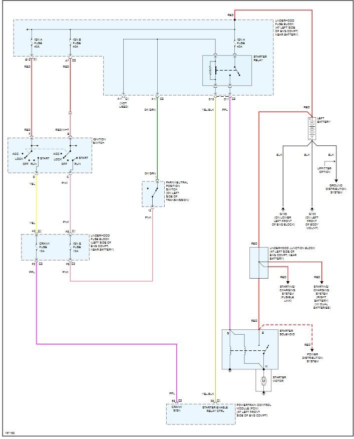

my truck died on me while driving and now wont start. i had the battery checked out and its still good. i have power to every thing lights, radio etc, i replaced the starter and still wont start, what do yall think is going on?
Apr 4, 2010 at 3:02 AM
  • 75,988 POSTS
Im going to assume that the engine wont turn over given the parts list you have replaced.
Start by reading the guides below on starter testing and wiring testing, they will help you figure this out
The wiring diagram for you starting system is attached below

Probable causes here could be the starter itself, starter relay, computer grounding part of the starter relay coil and ignition switch

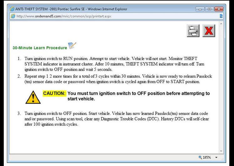

HMAC300
  • 48,601 POSTS
check fuses underhjood first then try resetting anti theft system(see pic).if stillnot starting scan for codes and check fuel pressure.
Jan 5, 2019 at 7:25 AM (Merged)
ROCKY77
  • 6 POSTS
I tried the reset. My security indicator does not even come on during this process to turn itself back off. I checked all ignition fuses and even fuses. I am stranded and have no way to check fuel pressure. Truck will start with starter fluid. It seems my fuel has been blocked out. Is it possible the contact in the lock cylinder is bad and wont let the paddock reset.

HMAC300
  • 48,601 POSTS
try resetting security system see pic on how to do it
