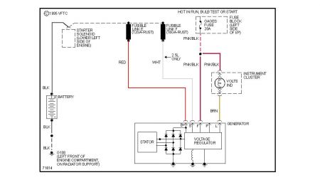

Where my alternator plugs in the alternator has 4 metal prongs but while the plug has 4 slots only 2 have metal in them is this right
Sunday, July 27th, 2008 AT 11:20 AM
  • 75,992 POSTS
The 2 metal prongs on the plug is it a pink and black and also a brown wire-if so hook the alternator up
also see below
https://www.2carpros.com/forum/automotive_pictures/12900_alty1_8.jpg
