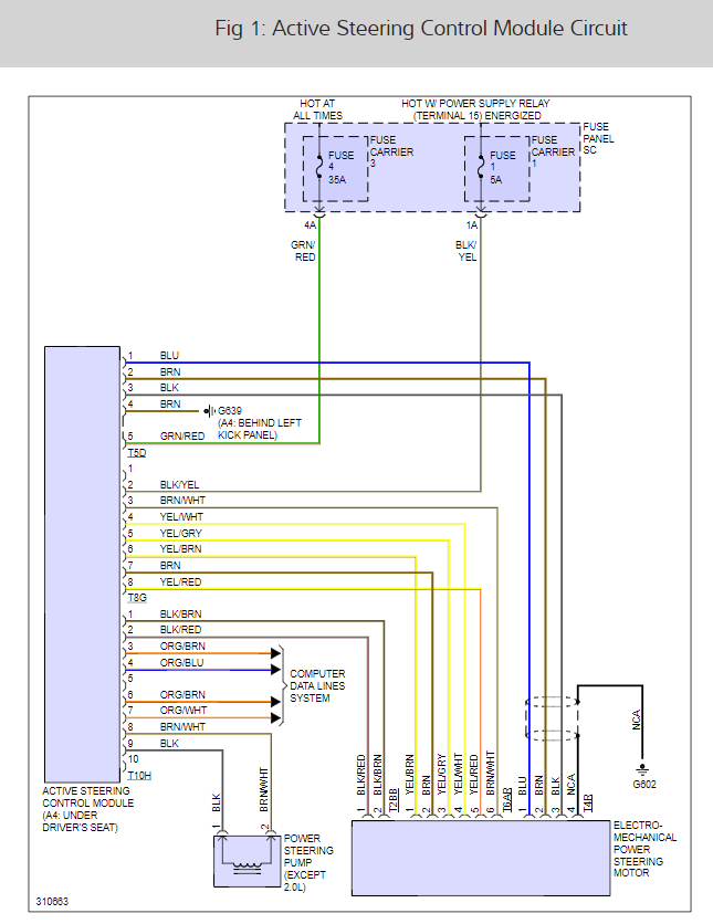

He not sure what it is, But now it has no power steering
I'm thinking maybe its the belt or something that has stopped the Alternator from turning and thus not charging the battery.
But before this all happened the power steering was fine ?
I'm thinking they have to be related some how, so gonna check the belt and battery volts tonight with the car running. Any other suggestions?
Nov 19, 2017 at 7:24 PM
  • 55,433 POSTS

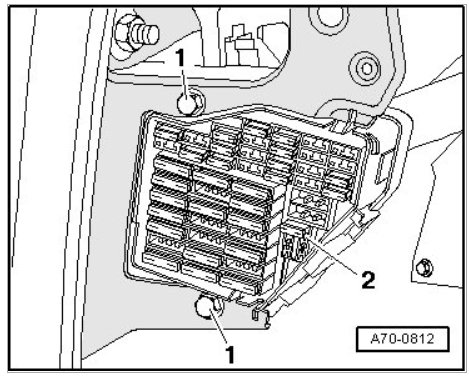

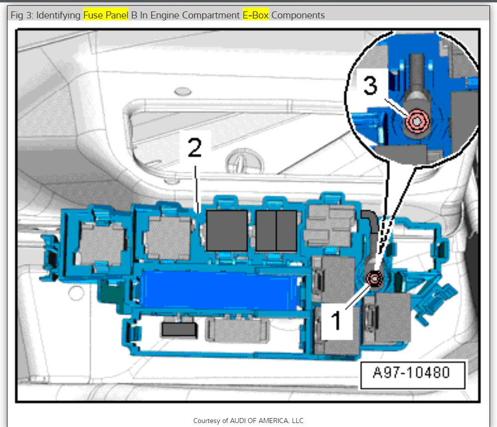

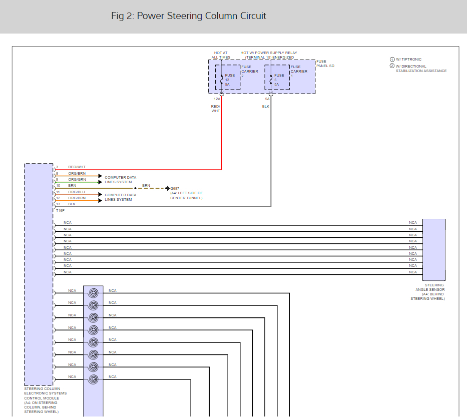

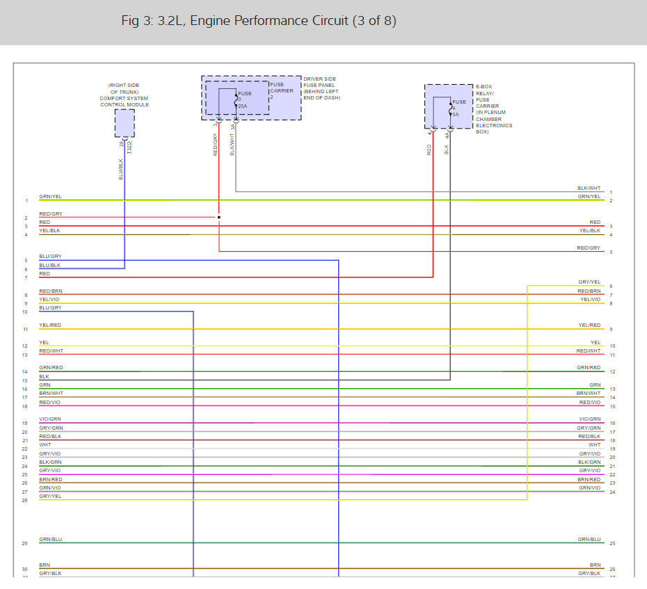

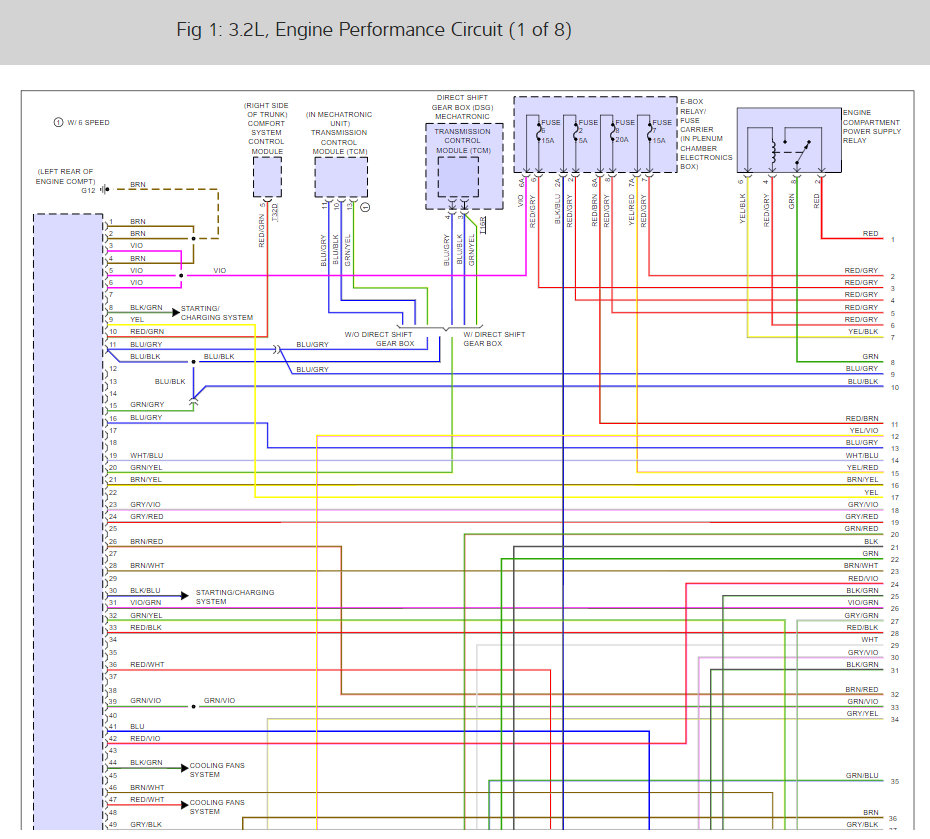

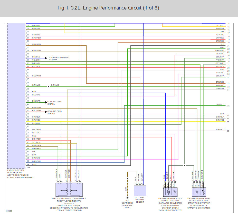

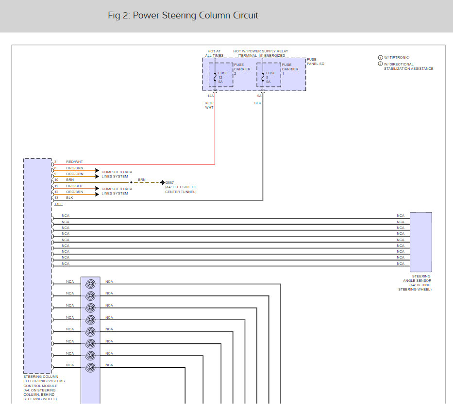

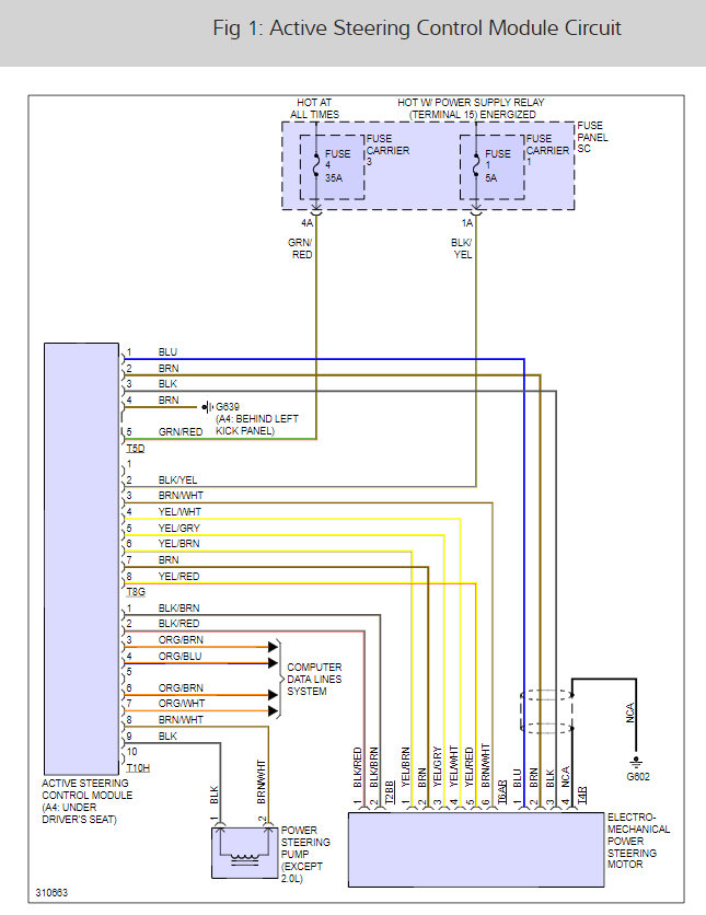

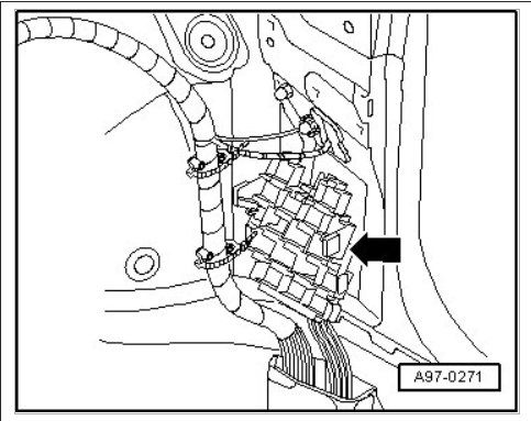

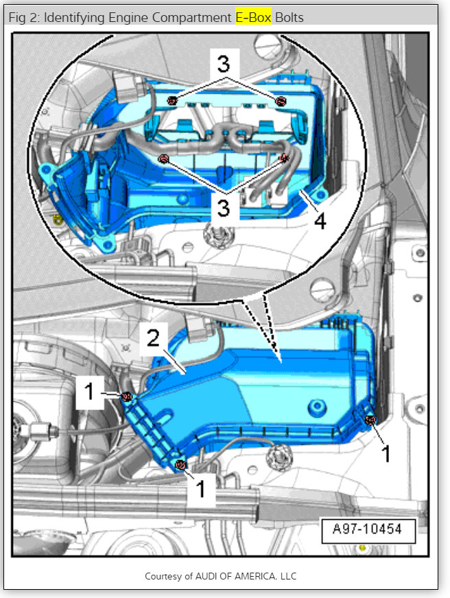

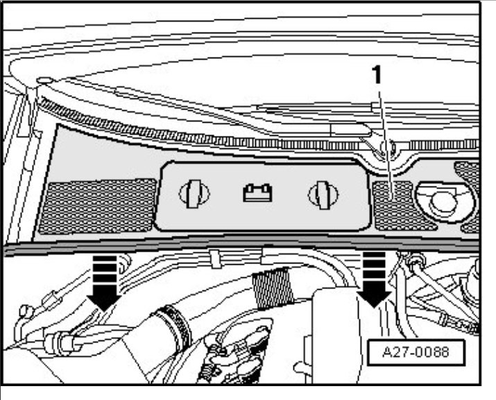

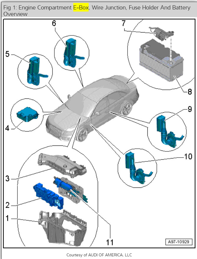

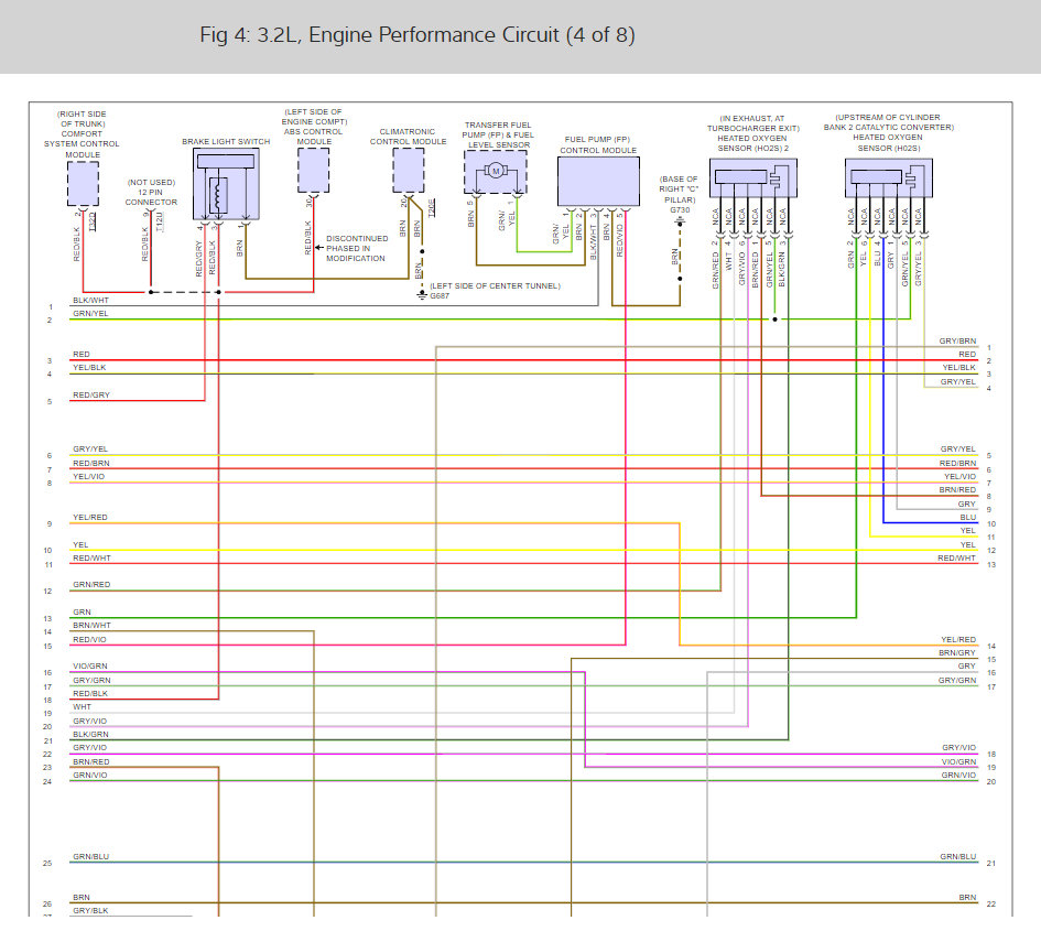

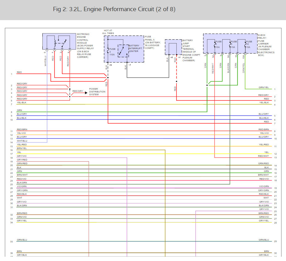

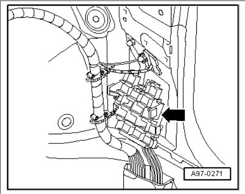

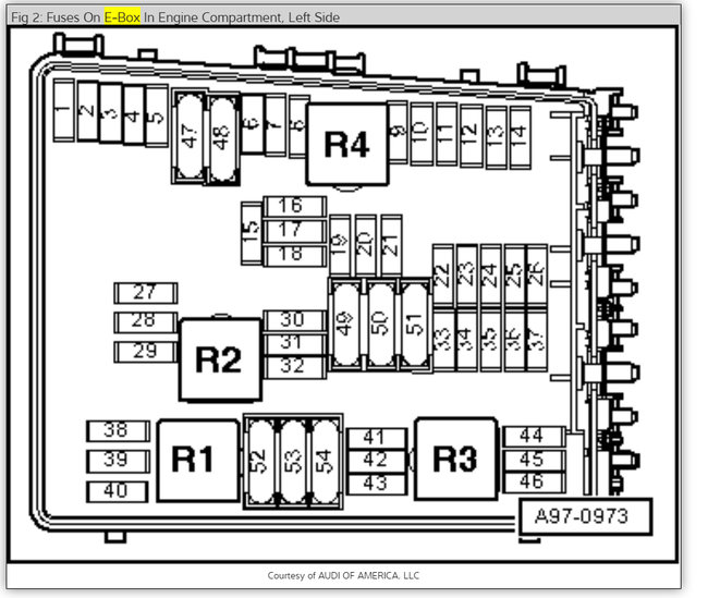

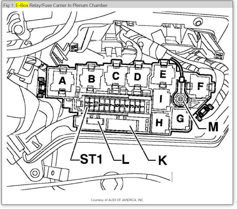

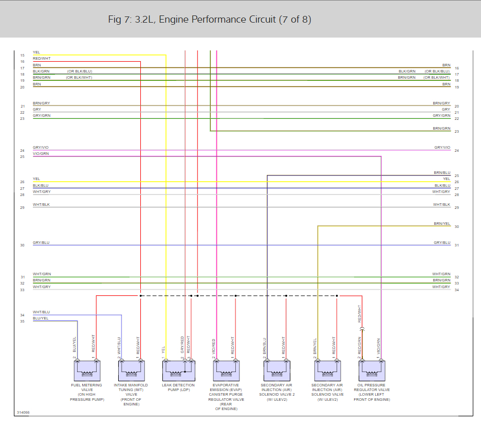

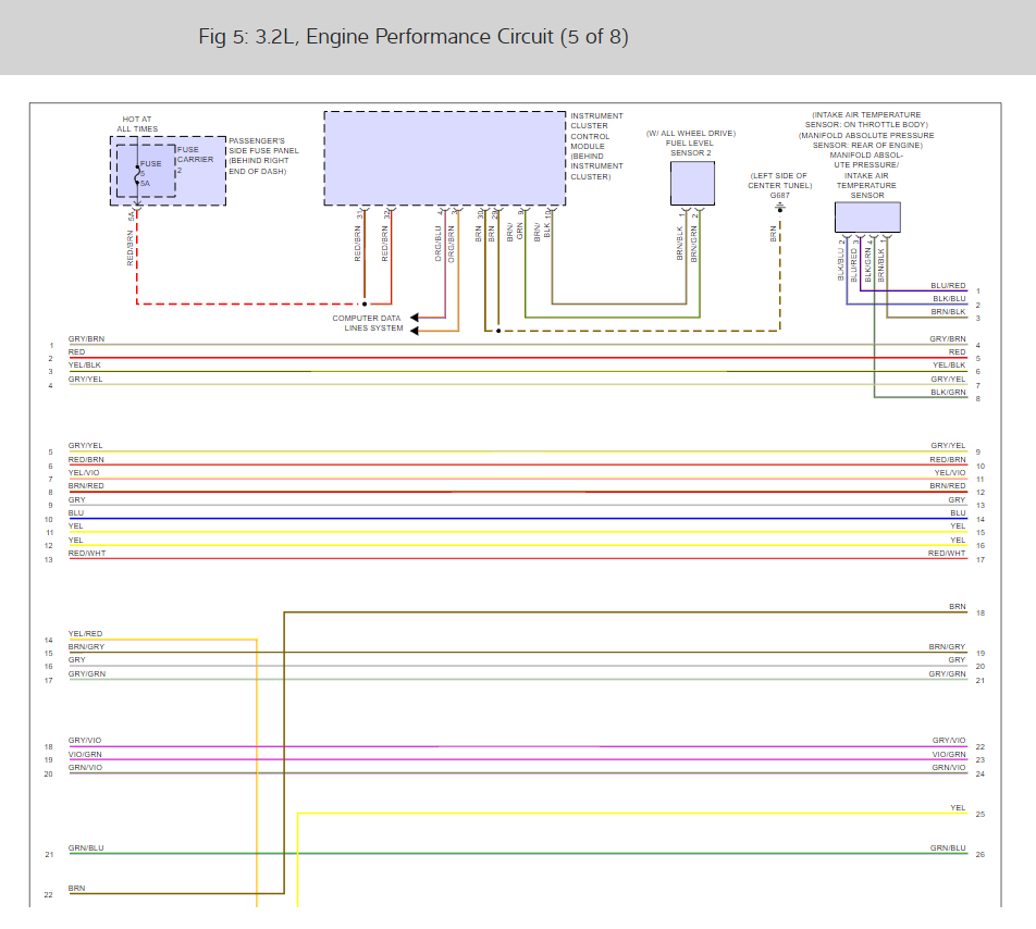

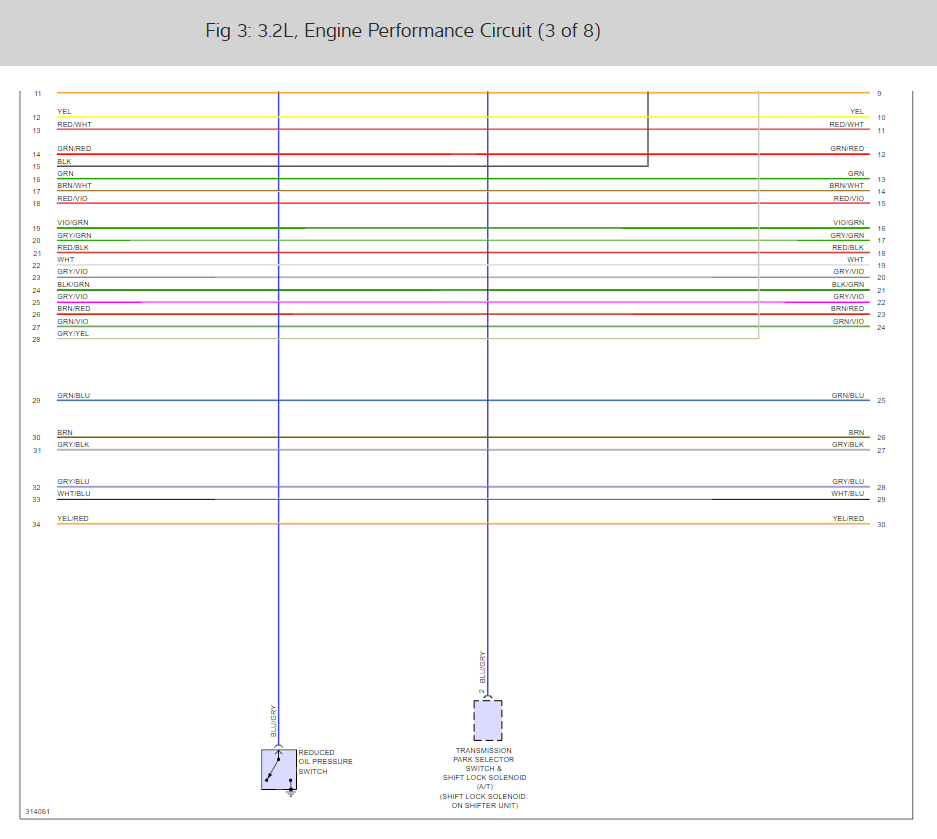

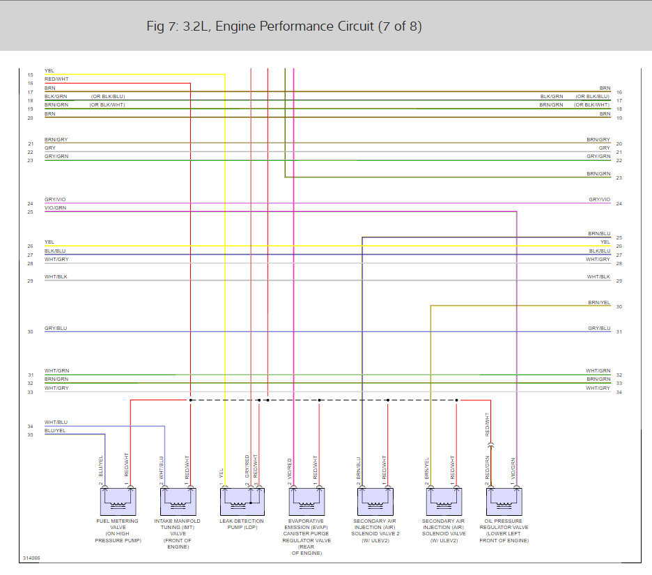

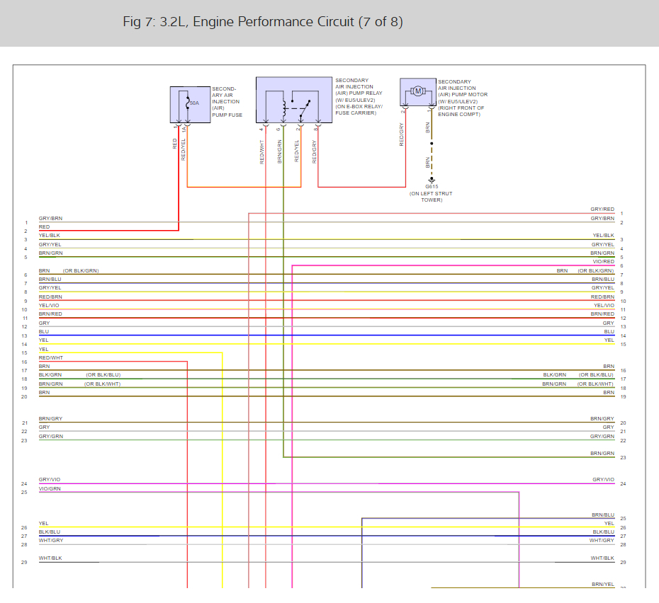

The car has electronic power steering so it sound like a fuse or relay that has gone out. Here is two guides and some fuse panel and wiring diagrams so you can do some simple testing to see what's going on. I would start with the engine compartment power relay.
and
Check out the engine and steering wiring diagrams with the fuse panel locations (below)
Nov 20, 2017 at 1:29 AM

Hi Ken, thanks for the reply, it's the Uk version Audi A4 B8 2009 model 2.0L TDi 143 bhp, apologises but it definitely has hydraulic power as I'm looking at the power steering fluid reseviour,
Nov 20, 2017 at 2:32 AM
  • 55,433 POSTS
It sounds like the problems are not related. I would check the power steering fluid level maybe moving the car around with the engine running caused the power steering fluid to be forced out of the reservoir. Can you send me a picture of the pump? Also is the engine still running?
