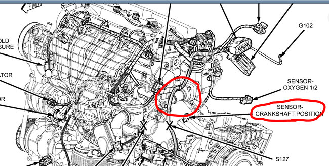

I will need to confirm engine size and if it is AWD. Now, if you look at the attached picture, you will see the 2.4L engine. I circled two things. One is the water outlet and the other is the crankshaft position sensor. If that is where coolant sprayed, it may have damaged the crankshaft position sensor and that will prevent it from starting. You need to check if there is spark to the spark plugs.

I need to know if there is spark and fuel to the engine. Also, you mentioned a pop. Was that the radiator hose when it came off? Also, was it the hose that goes to the unit I provided a picture of?

Not a problem. Since the crankshaft position sensor is so close to that hose, I'm questioning of that was damaged when it happened. If it was, the engine will not be getting spark and won't start.

That’s what I am thinking as I look at the pics and read they the research. I think something was damaged when whatever holds the hose to the radiator/thermostat popped off. I really appreciate your input. We’ll see what happens tomorrow. I’ll let you know.

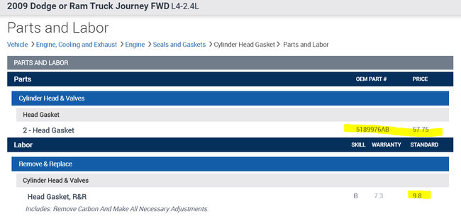

I'm not sure where you are located, and I don't know what their labor rate is. However, it does call for 9.8 hours labor. It's a big job. However, the head gasket (OEM) is under 60 dollars. I attached the flat rate for head gasket replacement on this vehicle in the pic below. The first highlighted thing is the gasket cost. Keeping in mind that there are other material costs such as coolant, cleaner, and so on. The second highlighted number shows labor, 9.8 hours. Multiply that by their hourly rate to determine cost.
Lets say they charge 100.00 an hour x 9.8 = 980.00
Head gasket +57.75
Shop materials +100.00
Aprox total 1113.75

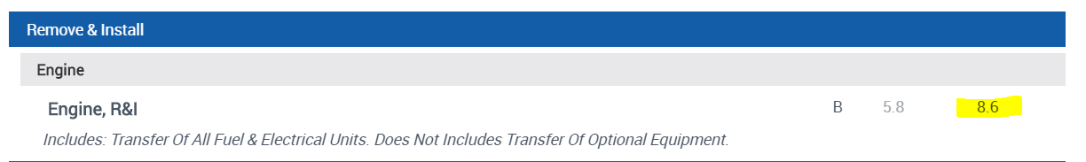

If you look at the labor for removing and replacing the engine, it is 8.6 hours. See pic 2
Labor 100.00 x 8.6 = 860.00
___________________________________________
If you subtract 860. From the 1113.75 that means they are getting you an engine for less than 254.00 dollars. To me, that doesn't sound possible. They did tell you it would be cheaper to replace the engine, so that's why I added this.

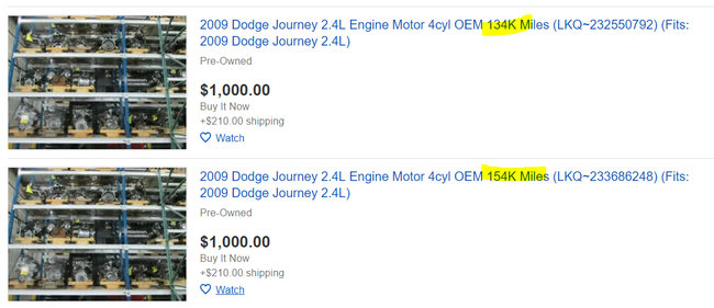

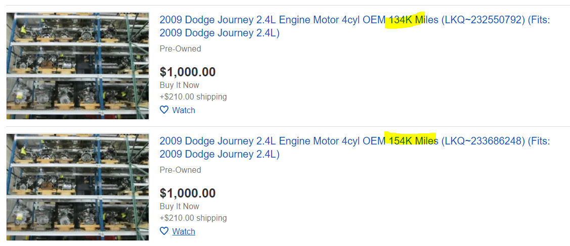

Honestly, I can't tell you what all that covers as far as the shop materials. Every shop has their own set of ideas and rules. As far as the purchase of an engine, it will range based on mileage. I attached a pic below that I just copied from ebay to give you an idea. They have a lot of miles on them and they are 1000.00. I hope that helps.
