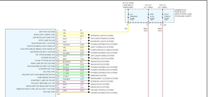

We can start the car by jumping the ignition at the starter, it will run we shut it off and it will restart off start button. But after about twenty minutes it will not start unless we get under it and trip the starter.
It acts like it loses power to the memory mode and I do not where to find the source of power for this operation.
Also, the front doors will no open as they are electronic, dumbest idea ever! So I do not know if they are connected through a body module etc.

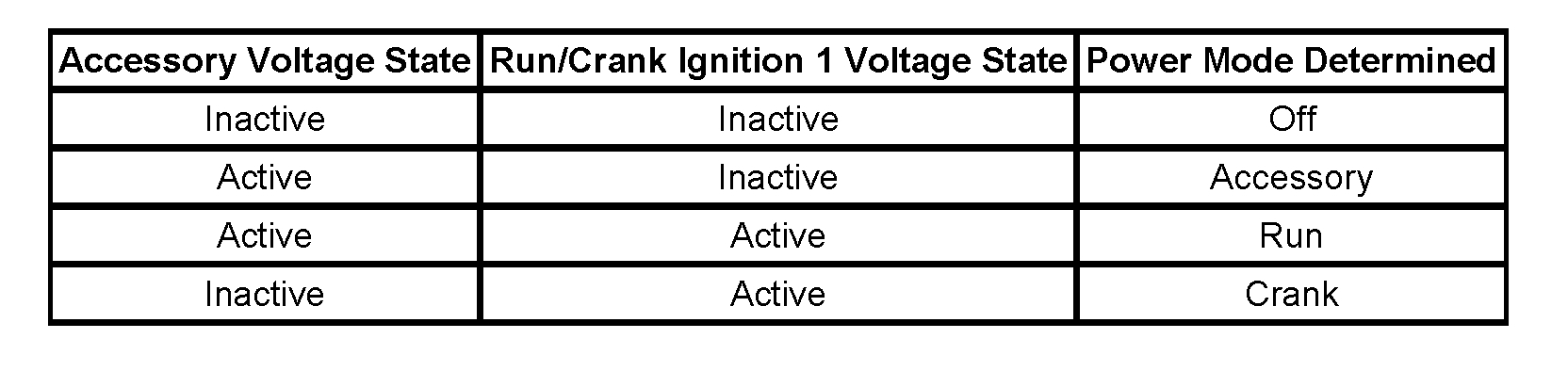

DISCRETE POWER MODE SIGNALS
Those modules that have Run/Crank signal inputs also remain in the state dictated by the last valid power mode message from the IPM or the RCDLR. They then check the state of their Run/Crank Ignition 1 voltage input to determine the current valid state. If the discrete ignition input is active, the modules will fail-safe to the Run power mode. If the discrete ignition input is inactive, the modules will fail-safe to Off-Awake power mode and shut down after a while if no other conditions require them to be awake.
ECM AND TCM POWER MODE BACKUP STRATEGY

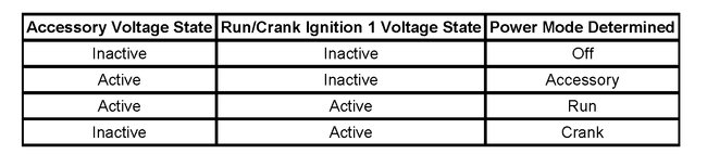

The ECM and TCM remain in the last known power mode state until it can determine its backup system power mode based on their discrete Accessory voltage and Run/Crank Ignition 1 voltage inputs.

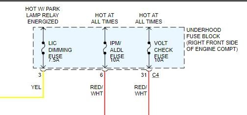

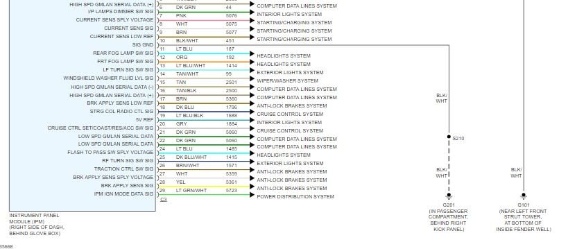

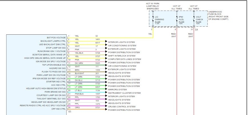

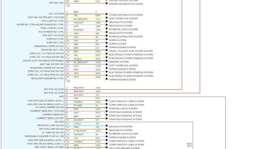

Now, the accessory power mode times out after twenty minutes and goes into off-awake mode, which seems to be what you are dealing with. This is controlled by the instrument panel module (IPM). If it does not see power, it will not work after twenty minutes and the engine will not start with the switch.
I have attached a schematic that I had to break into three pictures so you could read them. Power to the IPM is provided via two different fuses which are hot at all times. They are in the under hood fuse box. See picture 5. Check those. I have a feeling one is bad.
Ugh, all that to have you check a fuse. LOL Regardless, I hope it helps. Let me know if you have other questions.
