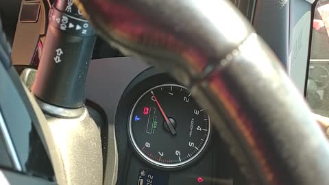

So, my car suddenly started running hot. My husband came to help me to get back home. He poured antifreeze because the car was overheating. Next thing we know the antifreeze started pouring from the bottom of the car. My husband thought the water pump had gone bad. At any rate I had to drive so far, stop, let him add water, which again was pouring out, to cool it just enough to get home. He inspected when we got home and noticed the heat hose had a crack in it. He ordered it, placed it on, and cranked the car and it started with no problem. He added more antifreeze, cut it off and now it won't start. It turns over, just won't start. The battery is new, so it's not that. Please help. Any info would be appreciated. Thank you.

I have a couple of questions. First, how wet did the engine and engine compartment get when you were driving it? Also, is it possible for you to record it cranking and upload it for me to hear?
Next, chances are either spark or fuel is lost. My first guess is spark to the plugs. Here is what I want you to try. See if the engine starts for a couple of seconds and then stalls if you use starting fluid. If it does, then we know its fuel related. If there is absolutely no change, then suspect ignition spark. Here is a link explaining how to test for spark:

So, I tried to turn it on. Still turning. Not catching. I can now smell gas, which I am assuming my engine is flooded.

I had a better video because it made some type of noise, but I didn't realize I had to take the video within the reply. My husband refuses to take the spark plug out because he says the car overheated so it would make it hard to take out.
