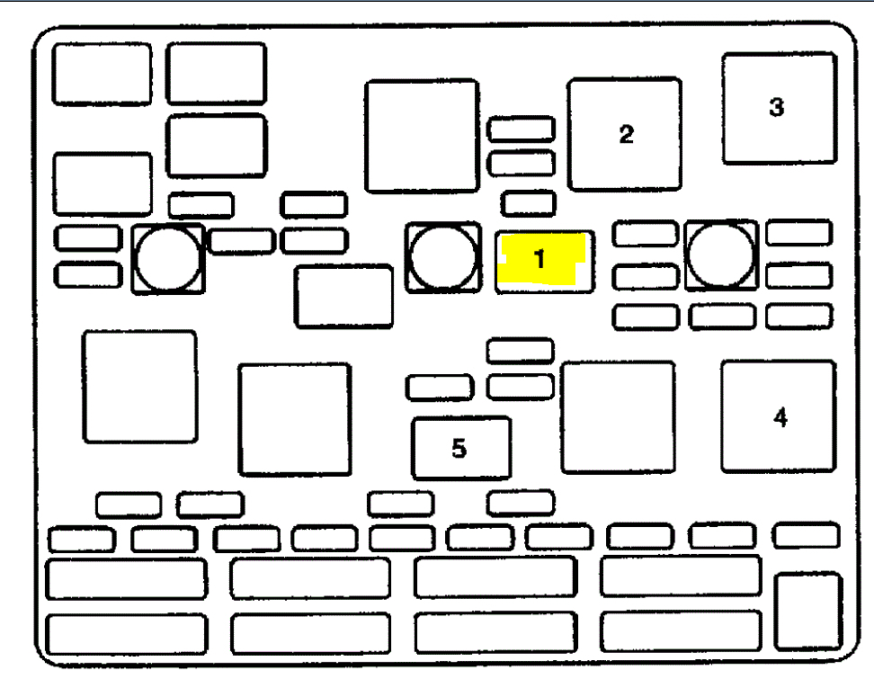

It's normal for a relay to make a click. Tell me, do you hear the fuel pump turn on for a couple seconds when you first turn the key on? Also, see if it starts for a couple seconds using starting fluid and then stalls. If it does, then we have a fuel related issue. Do you know which relay is making noise?
I attached a pic below of the under hood fuse box. I highlighted the fuel pump relay. See if that is what is making the noise.
Aug 12, 2020 at 2:34 PM
DWAYNE01
  • 5 POSTS
It is getting fuel also.
Aug 13, 2020 at 12:23 PM
  • 110,248 POSTS
If you have fuel and spark to the plugs, it has no choice but to run. Will it start for a couple seconds using starting fluid? You may have fuel pressure but no injector pulse.

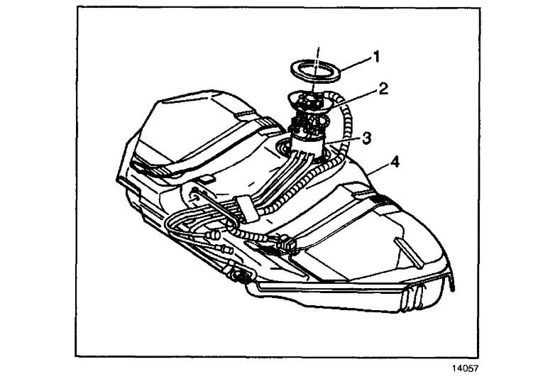

It has spark but fuel pressure is low. so how do i know is if it's the fuel pump or fuel filter?
Jan 27, 2021 at 10:25 AM (Merged)
the filter will not change the pressure. it has a bypass in the filter itself.
if the pressure is low, it is the fuel pump.
https://www.2carpros.com/articles/how-to-replace-an-electric-fuel-pump
CHARISE LANDRY
Is this for a 2002 Malibu?
That is correct. the picture is for your car.
procedure
1. Remove the fuel tank (4).
IMPORTANT:
^ The modular fuel sender assembly may spring up from position.
^ When removing the modular fuel sender assembly from the fuel tank, be aware that the reservoir bucket is full of fuel. The reservoir must be tipped slightly during removal to avoid damage to the float. Discard the fuel sender seal and replace the seal with a new one.
^ Carefully discard the reservoir fuel into an approved container.
2. Press down and rotate the cam lock ring (1) until free of the fuel sender retaining tabs.
3. Remove the modular fuel sender assembly.
4. Remove the fuel level sensor.
