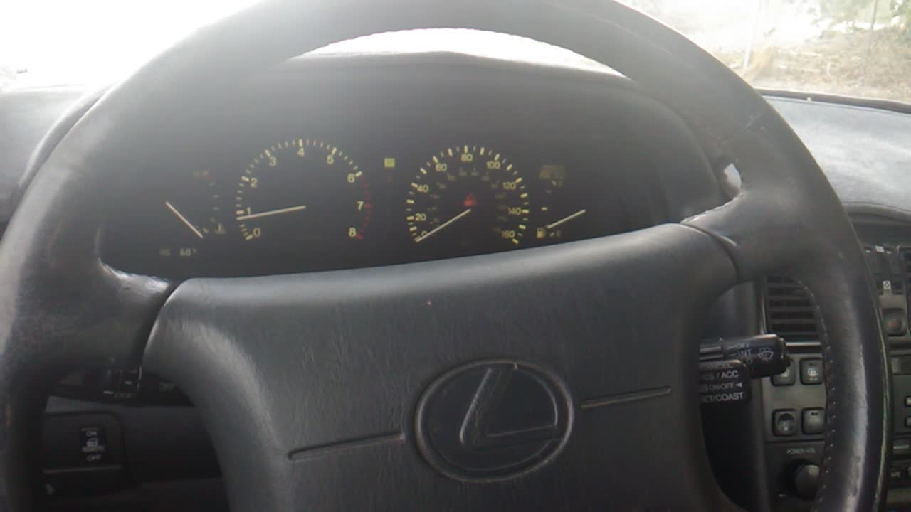

Turns back on but check engine light on and the car will only stay on with acceleration and shifting manually from lowest gear all the way to Drive shifting manually at 2,000 rpm's and then down shifting to lowest gear at subsequent stop lights and traffic. Quite the mission home. Second time this month this happens. Really humbles me down for real. Was coming back from a job fair and grocery shopping. Glad to be home.
This happened last week for the first time and I replaced the battery and cleaned terminals. Moved main TPS a little up from where it was turned all the way counter clockwise to about where it was marked by previous owner. Car had been running great for the past week. Rpm's at 650-750 at idle with transmission on Drive.
Car is currently with hood open and positive battery cable off. I'm thinking the battery had nothing to do with and the RCU reset is what got it back running normal again. Dunno. Also, noticed noticed A/C compressor would not come on. Turned the A/C on while driving it home because I assumed that would raise the RPM and keep it from turning off at stop lights. I can't stop thinking this is throttle position sensor related. This car used to jerk every time I would try and pass 2,000 rpm when I just bought it and I replaced one TPS sensor which I later figured it the trac TPS sensor and not the main sensor and this got the car running great for months, the A/C would also shut off but the A/C button would flash in this instance. Thanks in advance for reading this far, I know being an internet mechanic has it's limitations and this grasshoppa is nowhere near being a masta.
Any comment appreciated even if it's a long shot.

When this happens, does the vehicle still restart immediately? I am not sure I follow the timeline because it seems like some time as past since it had the check engine light on. Does the light come on each time this happens?
Either way I would suggest we check for codes because that will help figure this out. If your theory is correct about the TPS then there will be codes.
So before we get down the road of what it could be, let's start with codes. The only thing I am worried is since you took the battery off, it more than likely erased the codes. If this is the case, then we may need it to act up again and then check the codes.
Let me know if you know what the codes were and we can go from there. Thanks

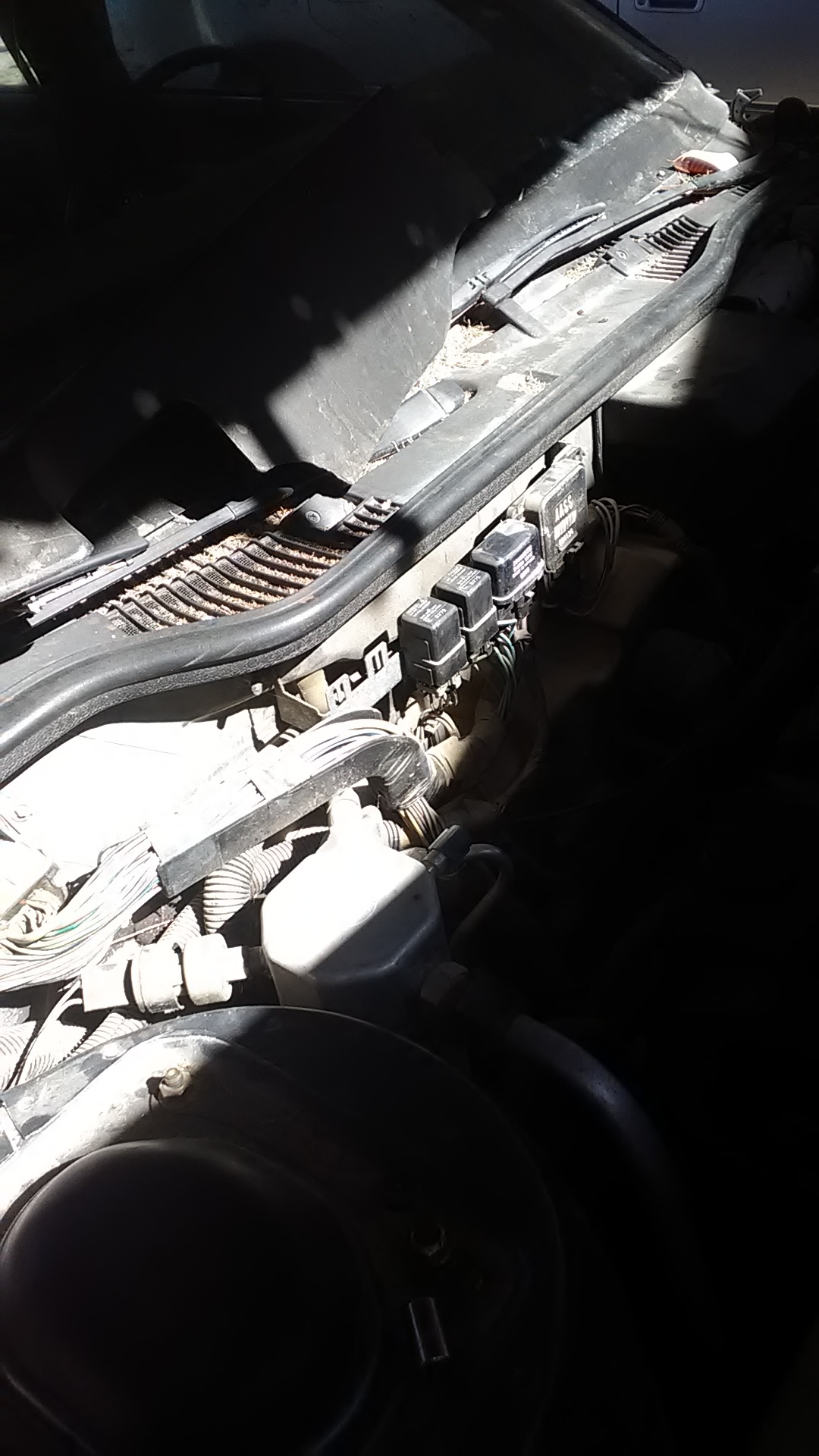

The battery has been disconnected for a day now. I will connect tomorrow and pull codes if any are still on. Picture for attention.

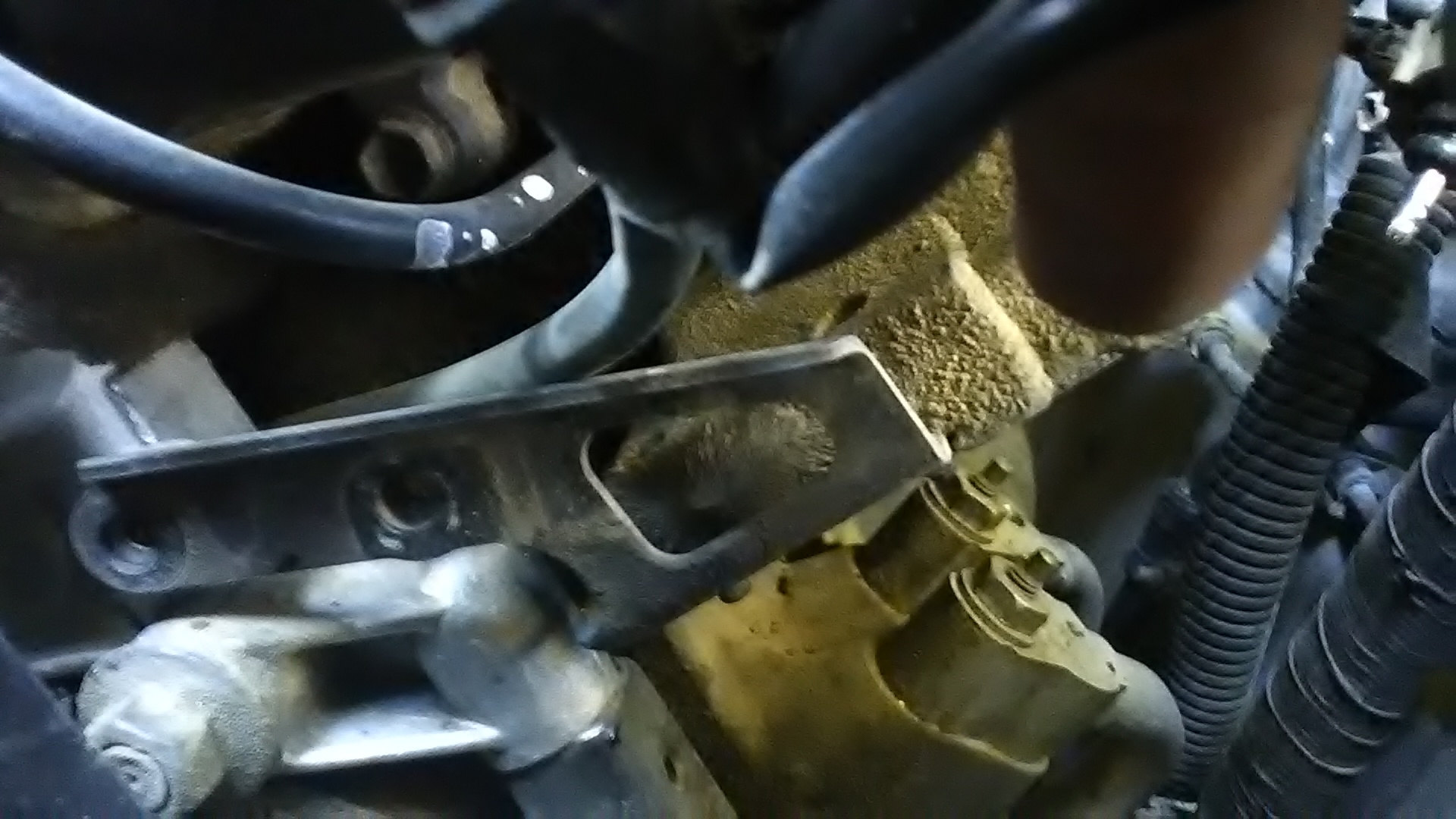

Ordered the ignition coils, it seems there is a loss of power but fidgeting with the TPS (setting left to right) and the sub-TPS it changes way the car accelerates and if it stays on. Right now the car cranks up and idles fine but no power in Drive, have to downshift at start from Low and on to get it pass 40 MPH. Wish I hadn't messed with the sub TPS though. Well see, I will keep posting to this thread. If anyone has the link to the removal procedure for the ignition coils let me know. Thanks!

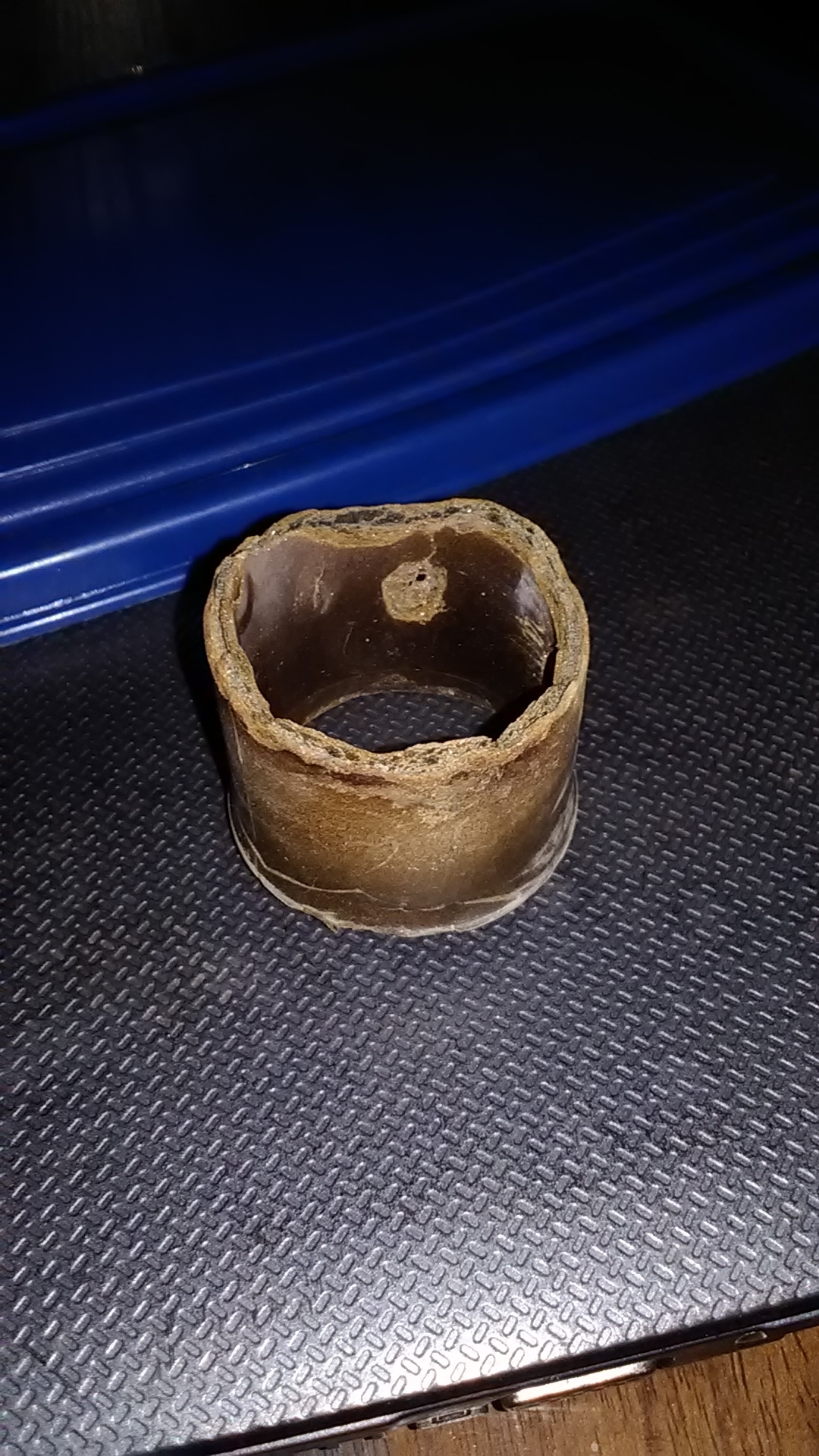

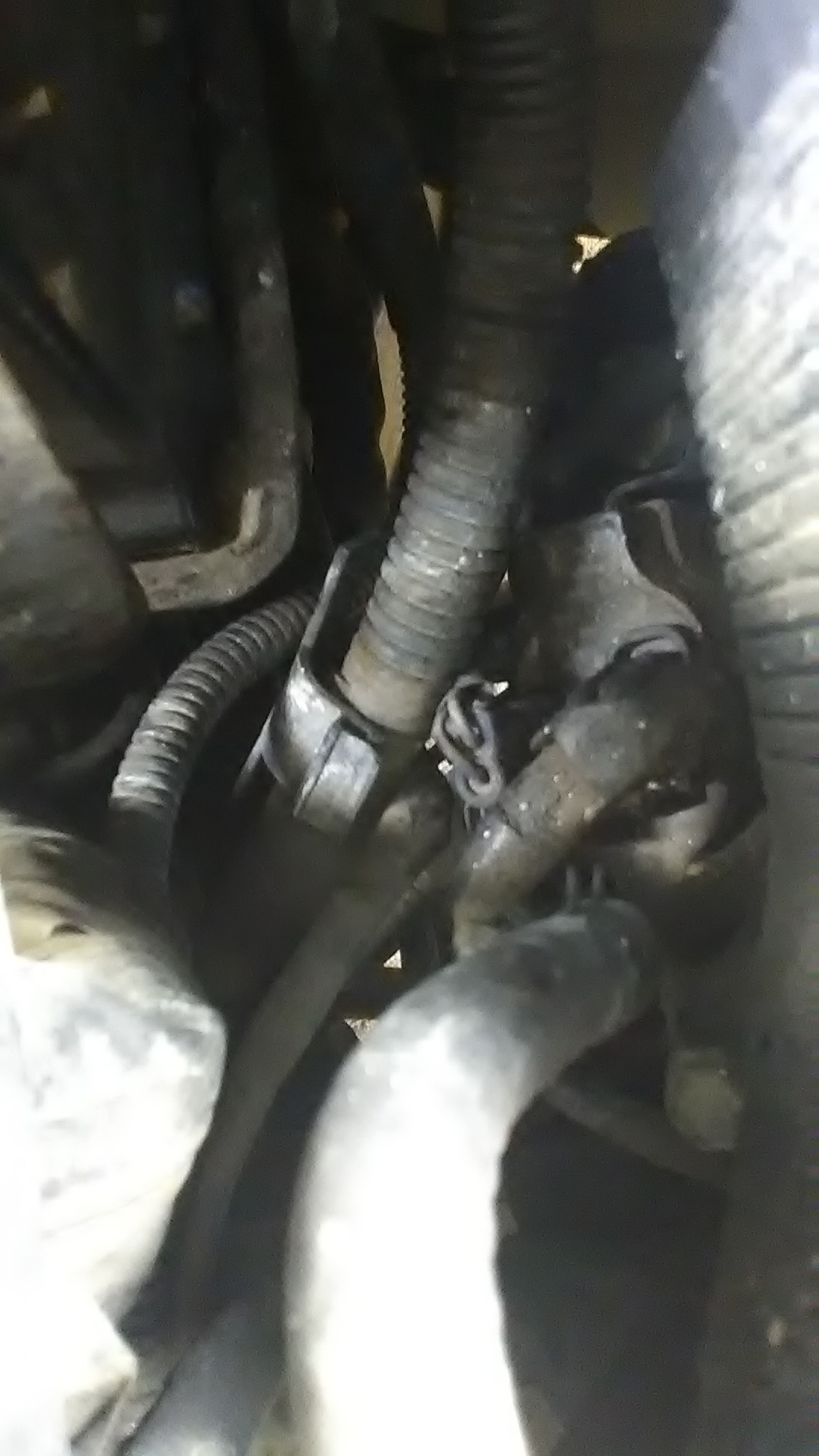

Got two 10mm bolts off the bracket can't see if other bolts. The upper radiator spigot had been broken and I just found that out too. I'm in this for the long haul, lol. thanks for reading.

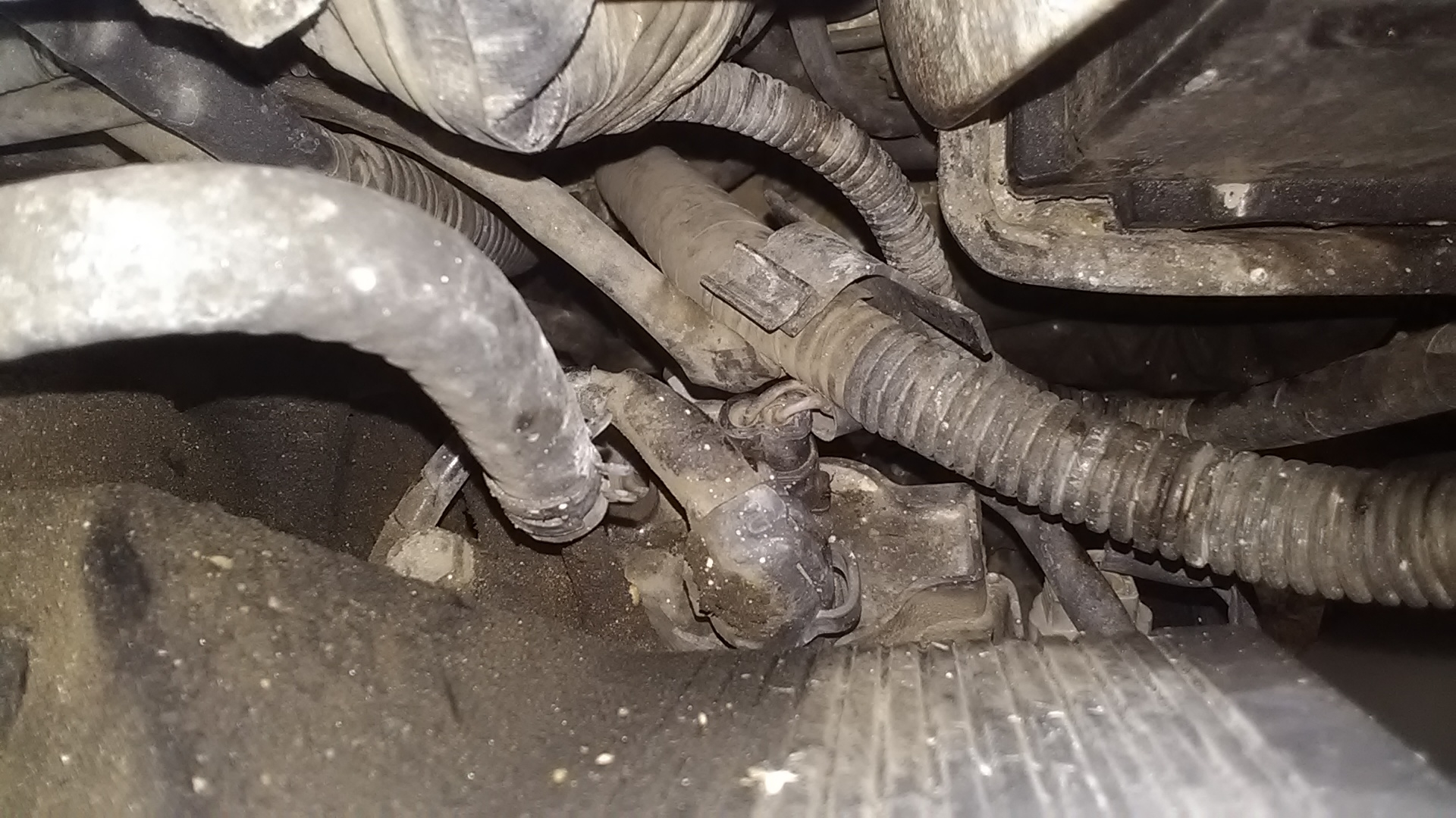

Yep haha, I got the ignition coil off. it is the original and the screws are beginning to strip. so I am cleaning and once I get some lubricant spray will soak the screws on the bracket to remove easily.

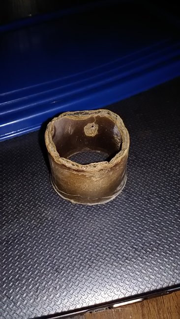

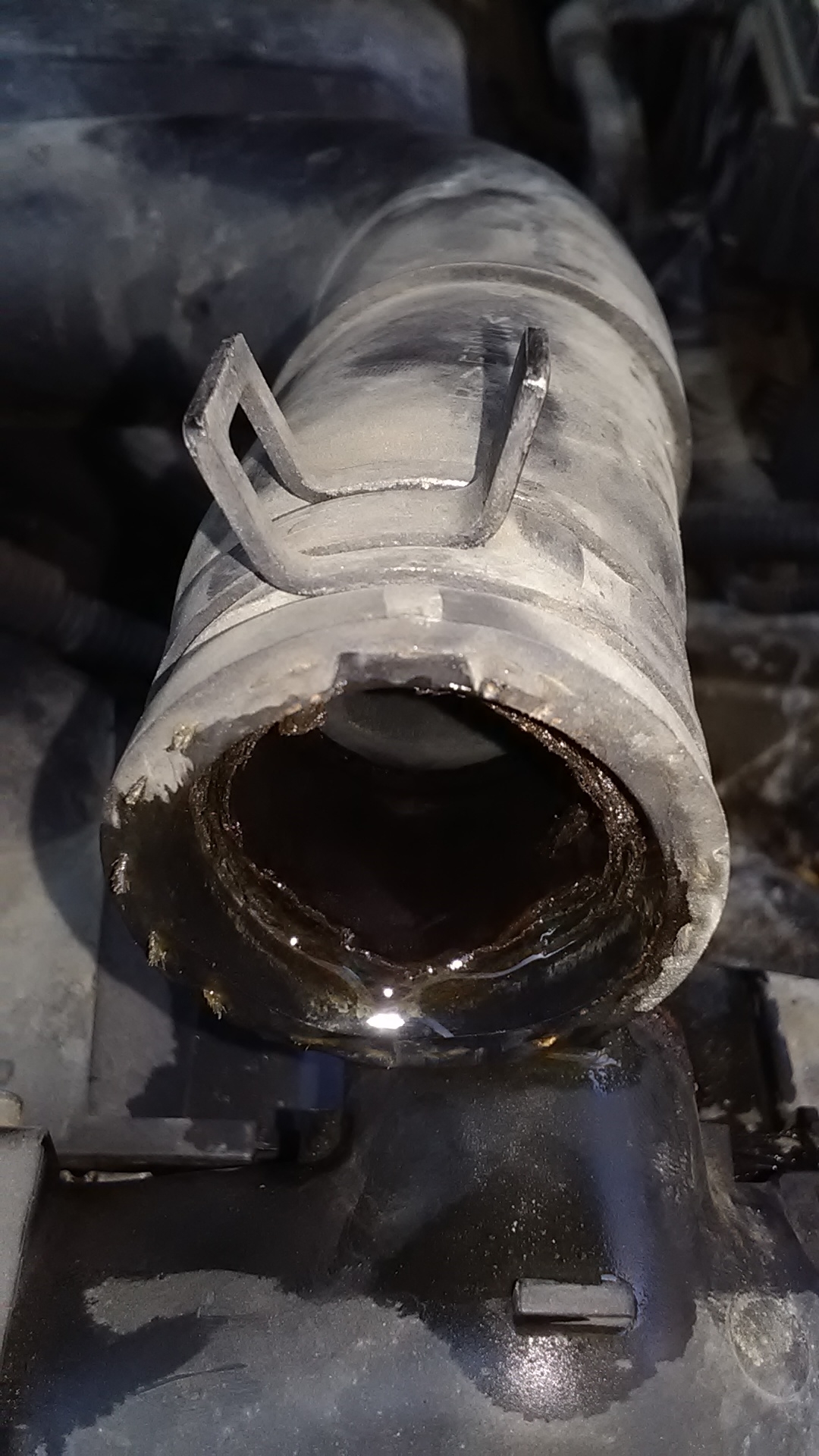

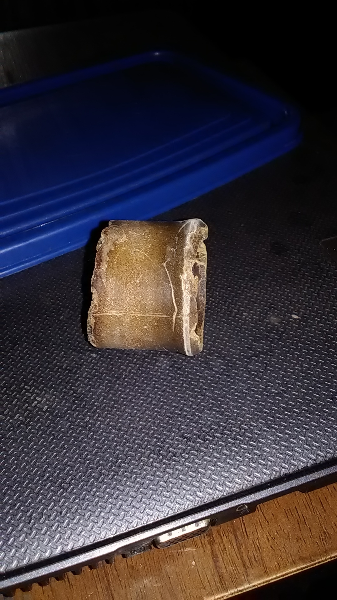

Will jb weld work? Maybe retrofitting another outlet on there? That piece is toast.
Feb 15, 2020 at 9:11 AM
Is that the outlet for the radiator? If so, I would not try to JB Weld it unless you have a large mating surface for the new one to splice onto. If you have just a small area then more than likely it will fail. Otherwise you may be okay.

I am going to need this temp fix before I replace the ignition coils.
Feb 15, 2020 at 9:38 AM
Just don't get the hose clamp over the repaired section or where the crack is because that pressure directly over the crack could compromise it. If you let it set up completely (like overnight) then you should be okay because it is not directly on the bend of the fitting.

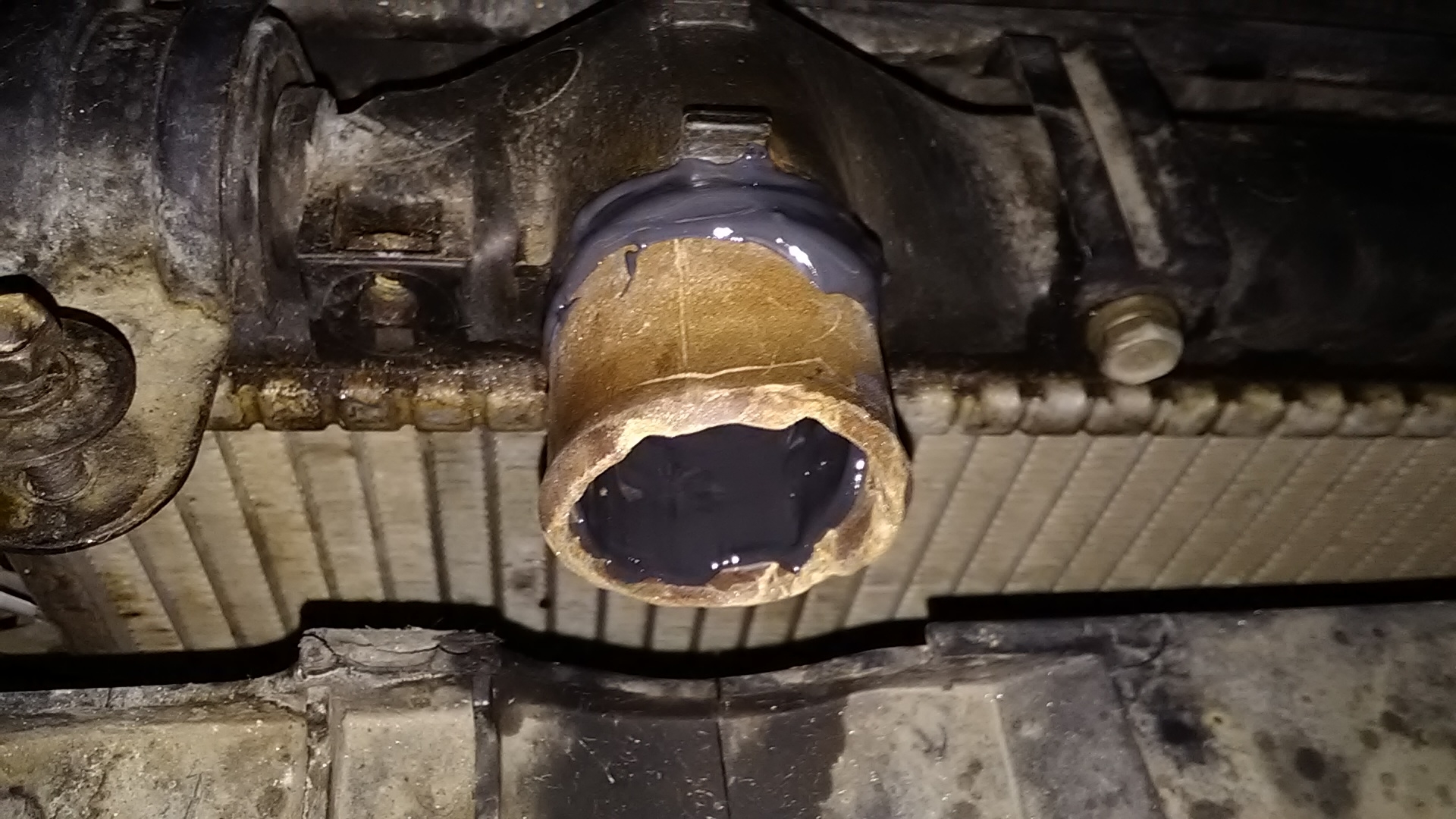

I let it sit for 12 hours then added a second layer covering a larger area around the crack this morning. Just need to see if the coils fix the lack of power from stand still. I will put it back together tomorrow. ECM recapped is on back burner for the moment as well as the radiator, I do not know. Picture for attention.

Replaced both ignition coils. Same problem. Radiator inlet jb weld fix lasted all of 1 mile while test driving.

To fix a radiator with JB or I use marine tex you have to sand the radiator real well with 80 grit then wash it with brake clean to remove oil and grease then put a layer of glue then put a piece of fiberglass cloth over the glue and then work it in with a stick until its set in the glue good. then add another layer of glue and let it set up. That will last years.

Tried and failed. Ordered the radiator, went with denso.

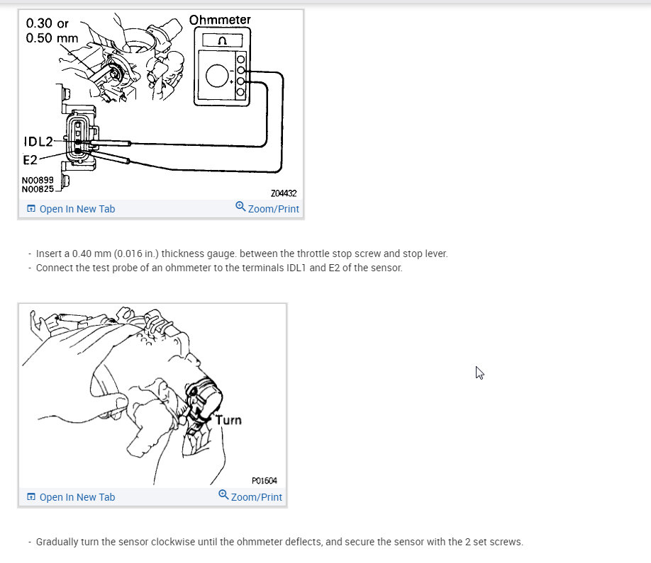

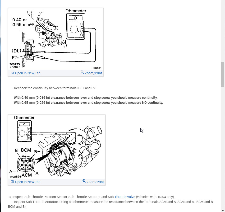

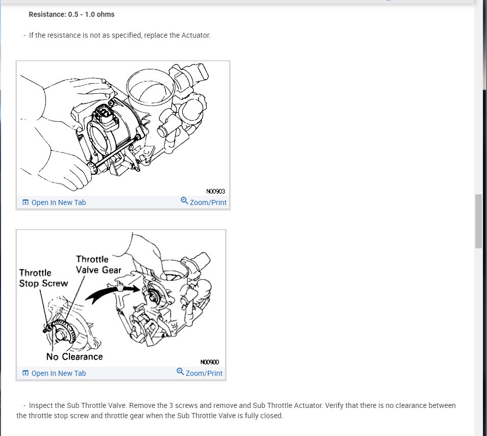

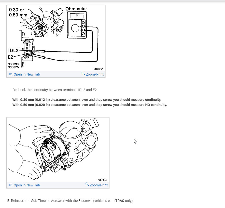

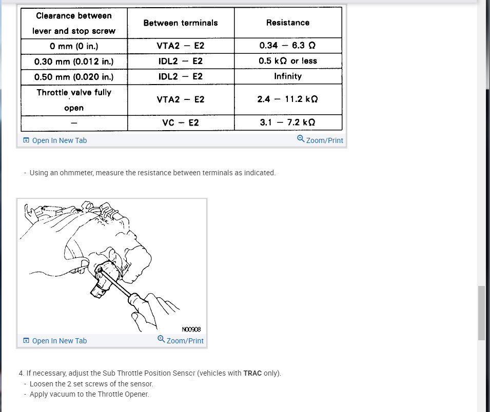

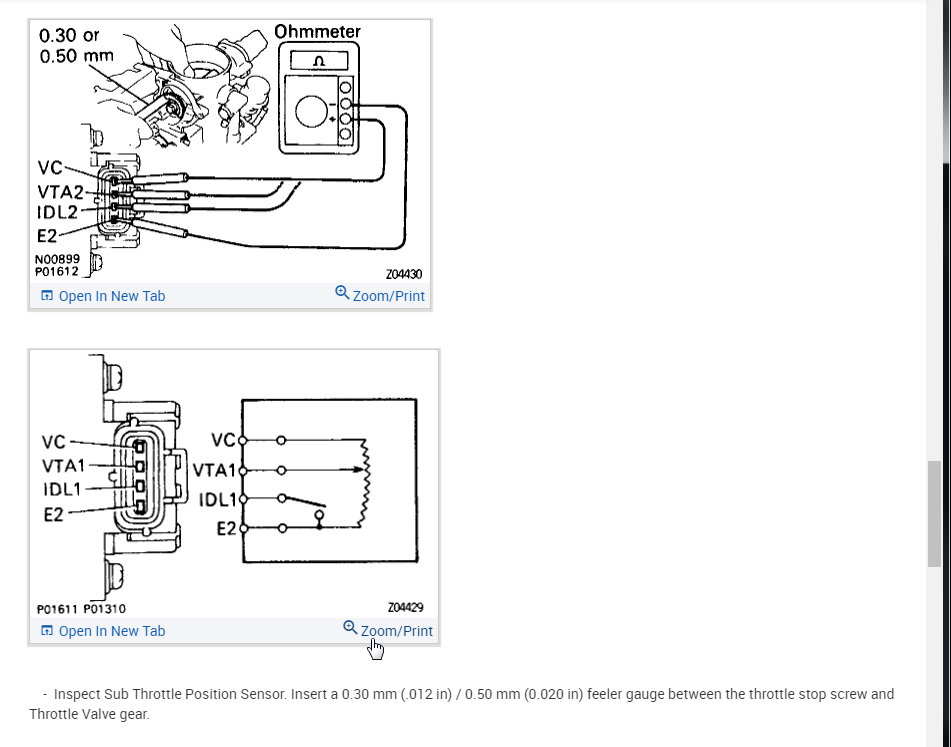

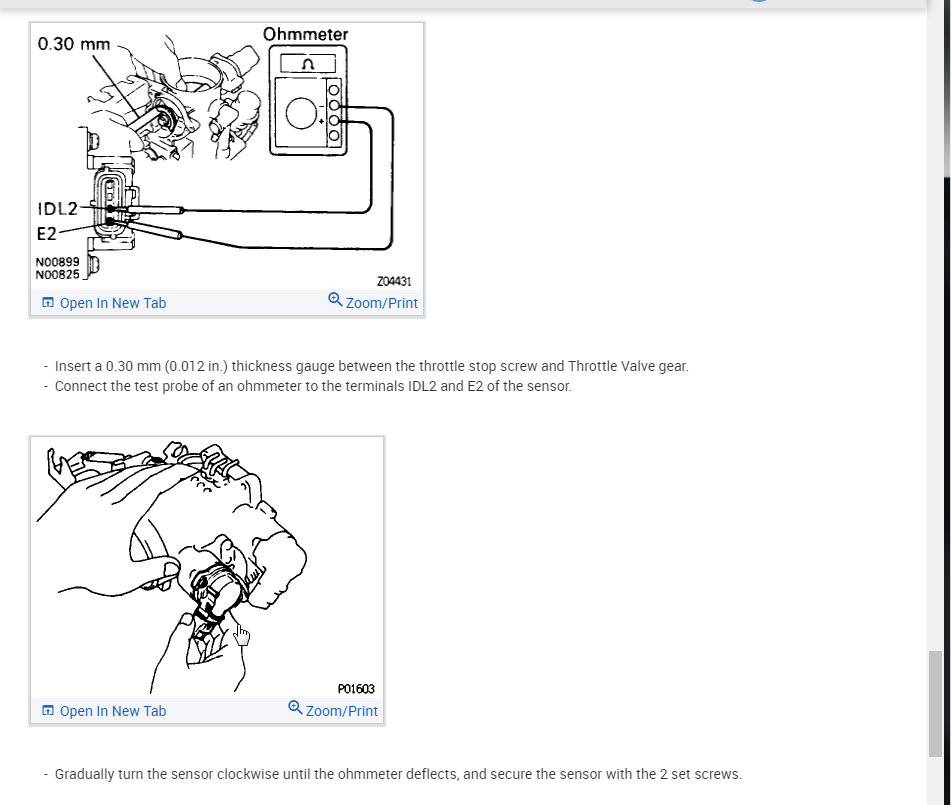

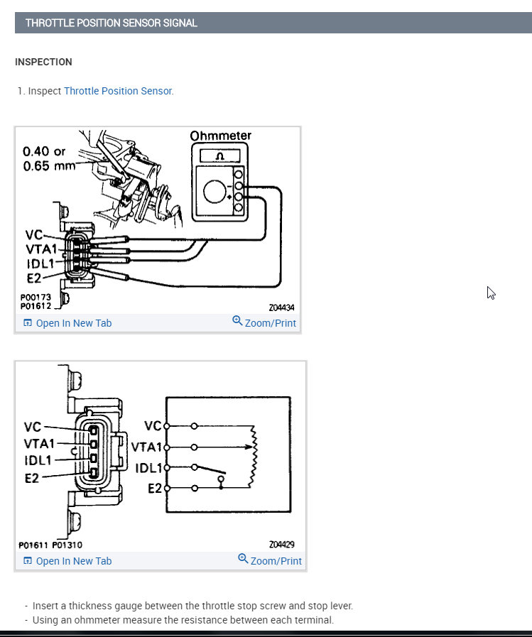

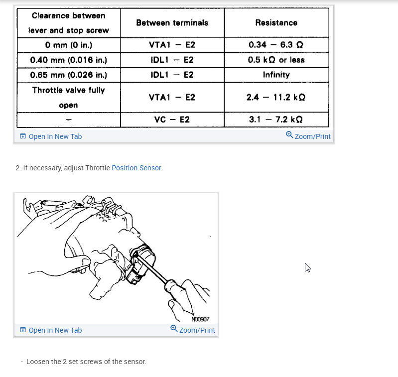

Installed radiator. Red antifreeze. Distilled water. Took a while to fill it up. New rad cap. New hoses. It's no longer overheating. check engine light at 2,000. Need to adjust the TPS again. Doing it manually is a pain. Risk sending car into limp mode. Anyone have any tips?
Mar 28, 2020 at 1:28 PM
I attached the entire process. It is a little involved to adjust the TPS but it is all there. Thanks
