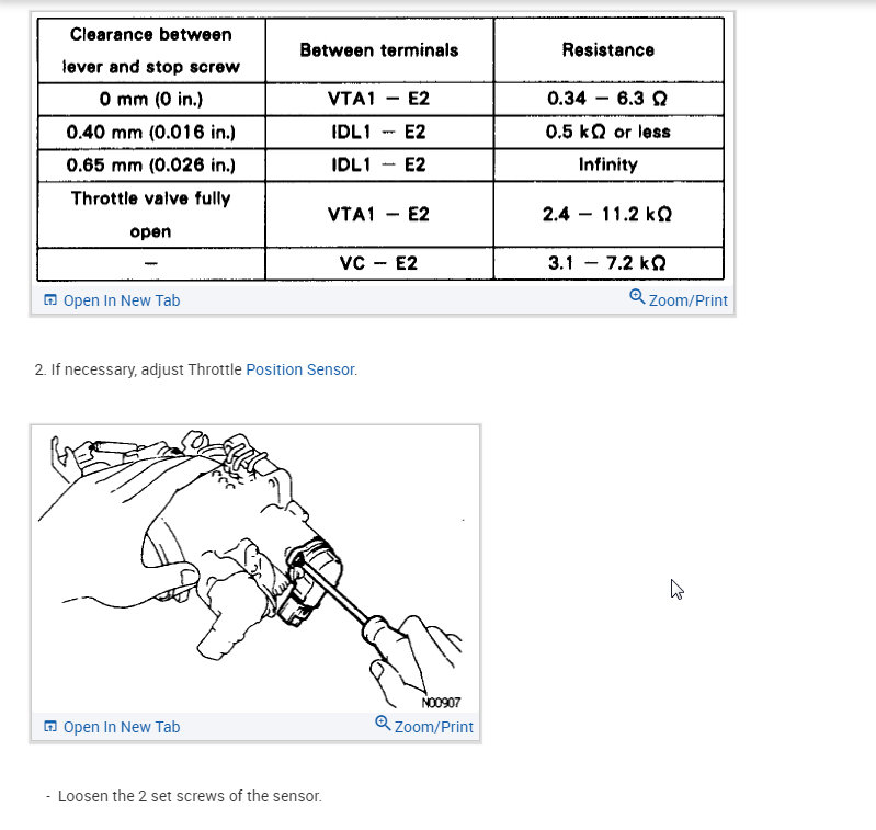

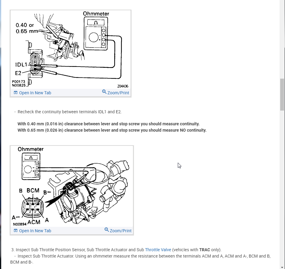

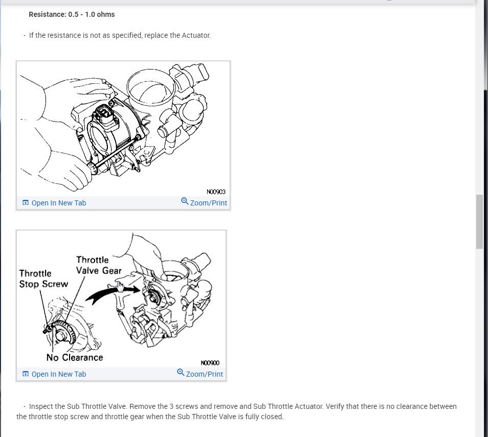

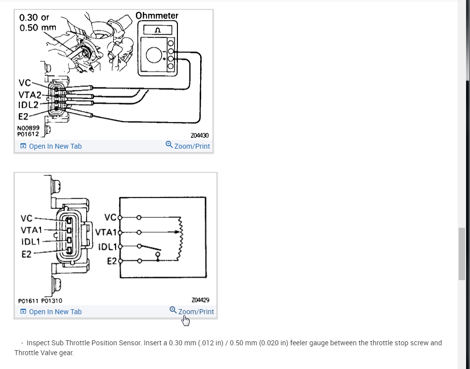

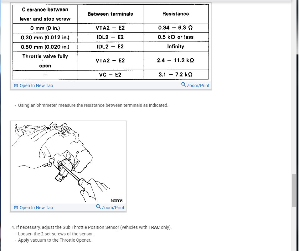

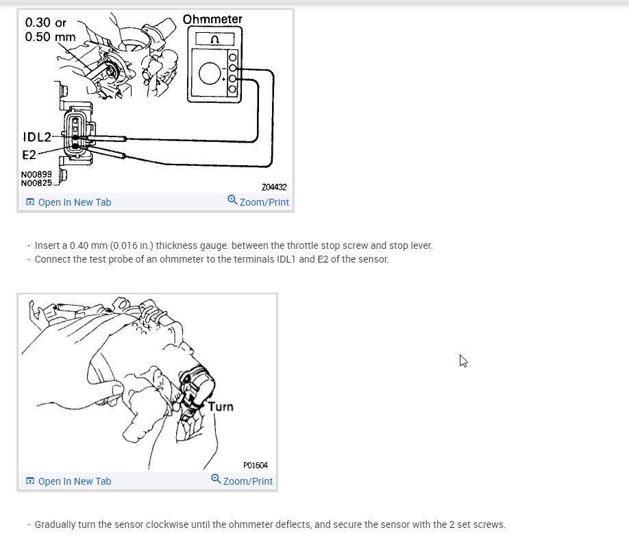

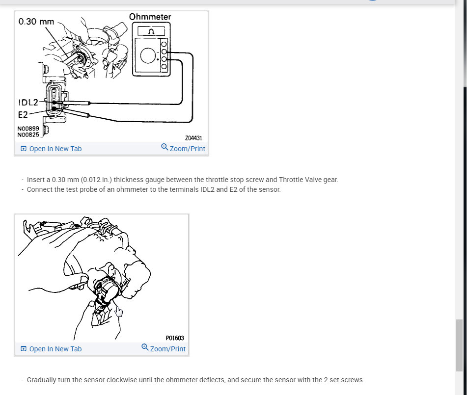

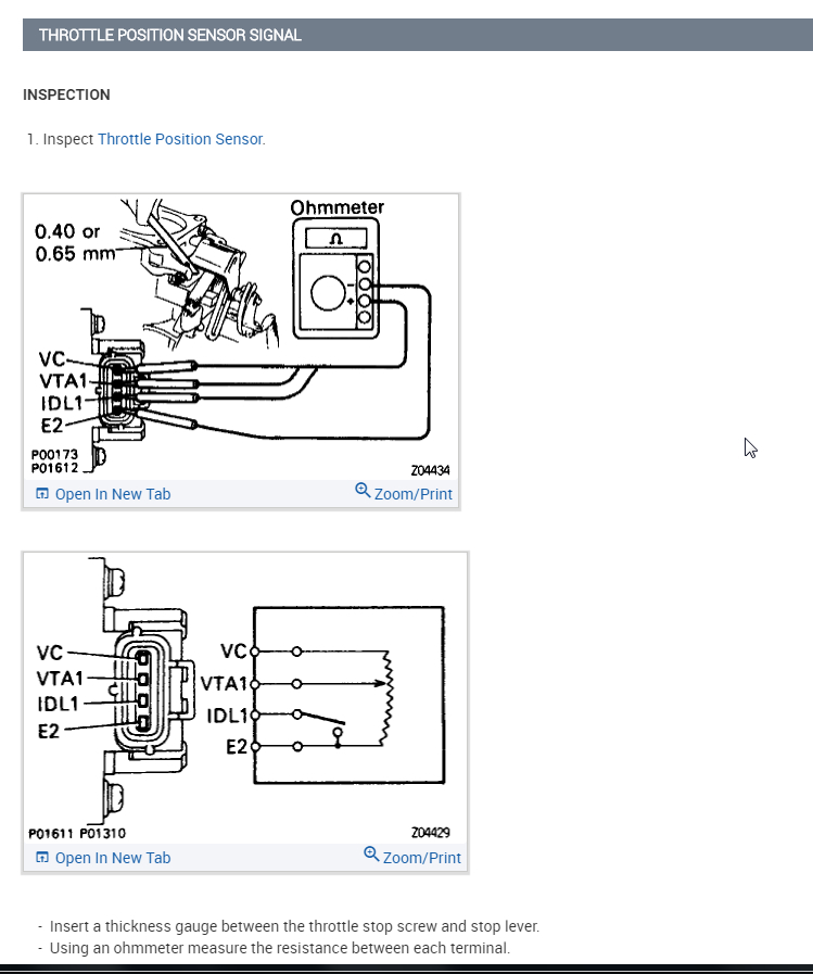

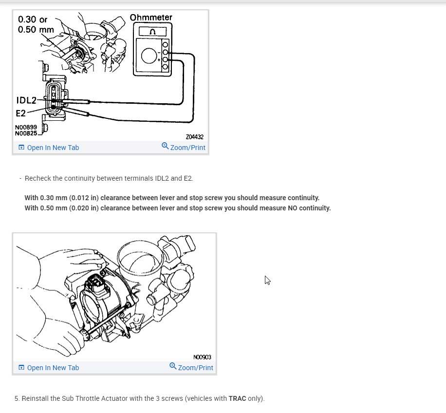

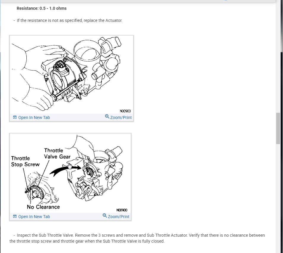

Installed radiator. Red antifreeze. Distilled water. Took a while to fill it up. New rad cap. New hoses. It's no longer overheating. Check engine light at 2,000. Need to adjust the TPS again. Doing it manually is a pain. Risk sending car into limp mode. Anyone have any tips?
Saturday, March 28th, 2020 AT 8:28 PM
I attached the entire process. It is a little involved to adjust the TPS but it is all there. Thanks
