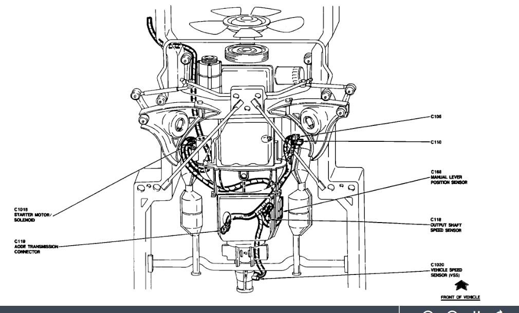

WENDY382
  • 1992 LINCOLN TOWN CAR
  • 4.6L
  • V8
  • 2WD
  • 100 MILES
Turn key and tries to start, had in shop twice, replaced a sensor and was not problem, then replaced ICM (ignition control modulator) and bam car started! Brought it home, got in it next day and nothing! No start again, towed it back to same shop. Found new ICM on eBay, bought it took to shop, he popped it in, car started right up, came home, started car every day for four days and it would start, last day let it run for about five minutes and turned it off and went back in about an hour later and nothing! Back to trying to turn over. Everything else is fine or so it was, fuel is fine, starter/alternator fairly new. What could cause two ICM's to fail? We have it stored for winter, so not something to get done immediately but we are going to have to get it fixed by spring. Ideas?
Monday, February 22nd, 2021 AT 8:25 AM (Merged)
  • 52,797 POSTS
Good afternoon.
It may not be the module at all. There is a sensor on the rear of the transmission at the driveshaft that sends a signal to the module for spark. If the is bad, it will cause this.
It may be that if you disconnect the wires at the module and re attach them, it may start.
PURPOSE
The Electronic Distributorless Ignition System (EDIS) module's primary function is to deliver full energy spark at a crank angle targeted by the Electronic Control Assembly (ECA) module and to provide the ECA with crankshaft position information.
CONSTRUCTION
The EDIS ignition module is a twelve pin custom microprocessor-based thick film module. Even though each engine is very different in size and structure, EDIS modules for each engine are very similar. With the exception of some pin assignments, basic operation of the EDIS systems for the different engines is identical.
OPERATION
The EDIS module receives input from the Variable Reluctance Sensor (VRS) style Crankshaft Position Sensor (CKP) in order to identify the passing of the missing tooth on the VRS trigger wheel. The module is said to be "synchronized" when the missing tooth is found. Synchronization is essential to the EDIS module in order to track the angular position of the crankshaft relative to a fixed reference and when it should fire the proper coil.
Profile Ignition Pickup (PIP) output is synthesized by the EDIS module using input from the VRS signal. The PIP signal generated by the EDIS module indicates engine speed and crankshaft position to the ECA. The PIP signal is used by the ECA so that it can enable fuel and spark functions and generate a Spark Angle Word (SAW) signal.
WENDY382
Thank you for the reply, was very helpful, we parked the vehicle in backyard and covered it until spring, however my husband just went out and decided to play with it and he unplugged the ICM and plugged it back in and the dang car started up, it will be good for a day or so and then stop running again. So what can it mean if you can unplug the ICM and it starts but then dies next day or two? Computer issues? Thanks
  • 52,797 POSTS
I would suspect the connector may be dirty or have loose or damaged pins.
Have him check the connector closely. You can get a pigtail to replace the connector.
