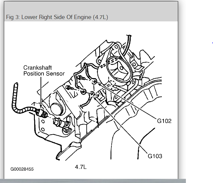

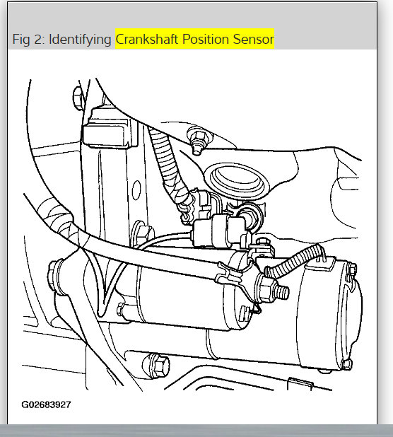

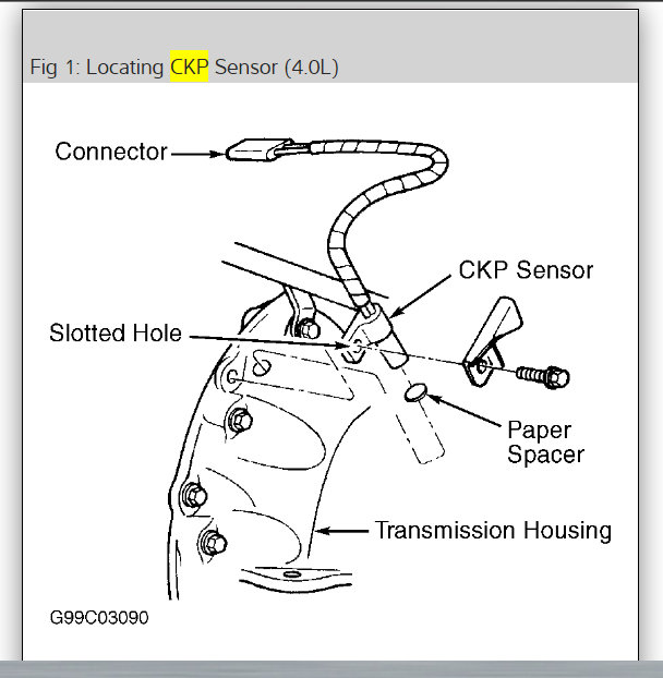

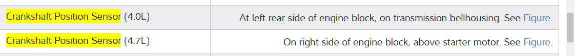

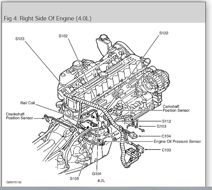

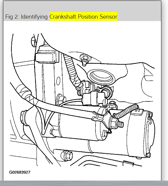

SCGRANTURISMO
  • 4,897 POSTS
This could be a problem with your Crankshaft Position Sensor (CKP). Your vehicle's CKP is used by the Power-train Control Module (PCM) or "computer" to determine the rotational speed of the crankshaft and for the misfire monitor. If the PCM isn't getting a signal from the CKP it doesn't know that the engine is cranking. I have included diagrams for both the 4.0L and 4.7L engines because you didn't specify which your vehicle had in the diagrams down below. I have also included a few links for you to go to down below as well.
https://www.2carpros.com/articles/how-a-crank-shaft-angle-sensor-works
Please go through these guides and get back to us with what you are able to find out please.
Thanks,
Alex
2CarPros
