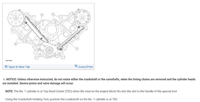

Correct timing chain marks and procedure needed?
BARNESBIL
  • 2012 FORD F-150
  • 5.0L
  • V8
  • 4WD
  • 139,000 MILES

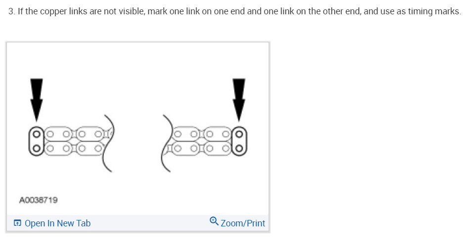

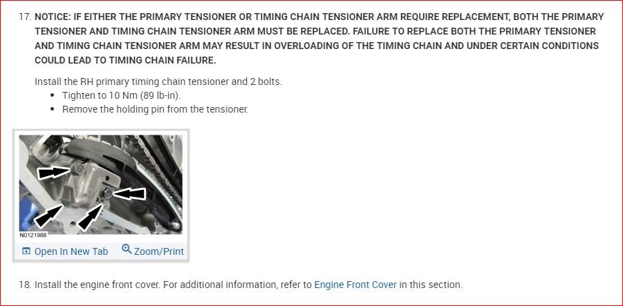

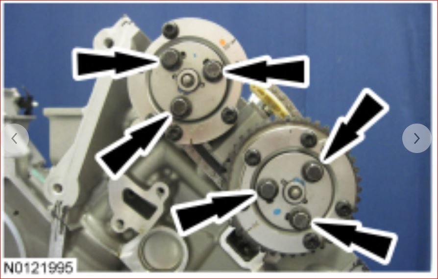

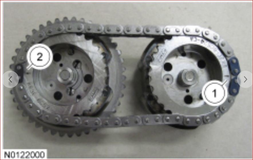

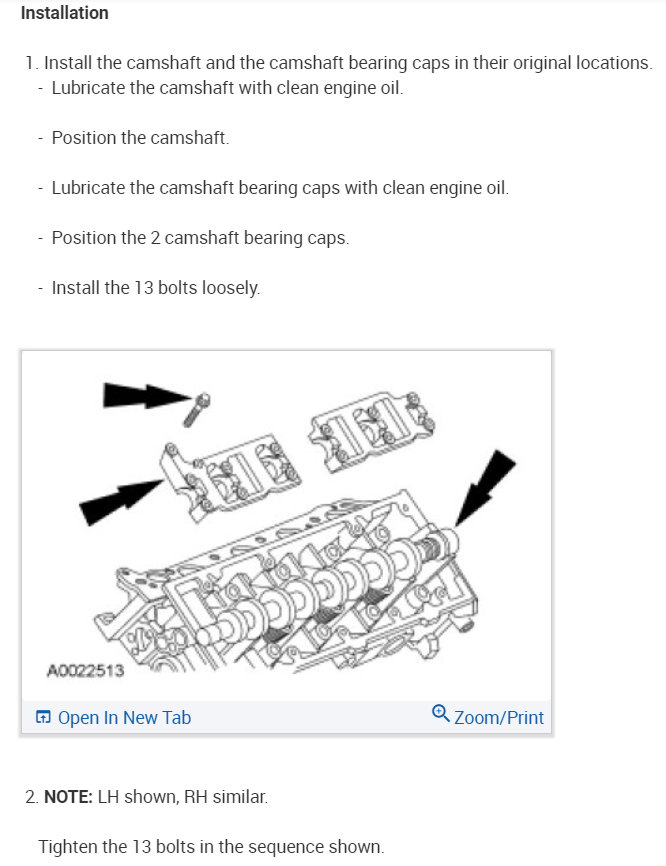

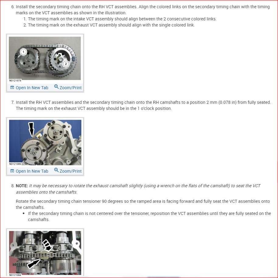

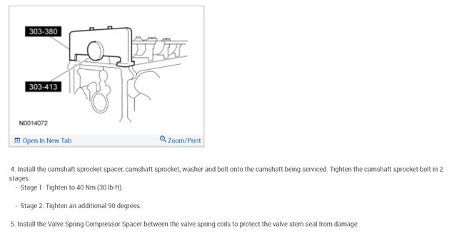

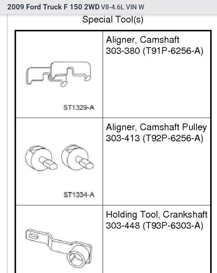

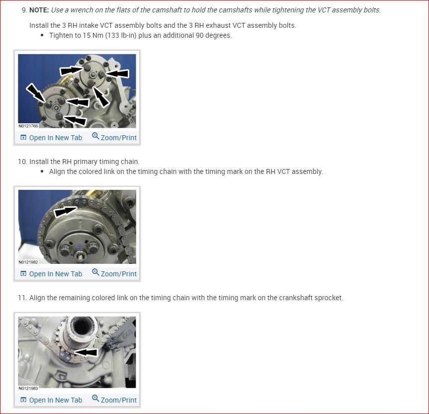

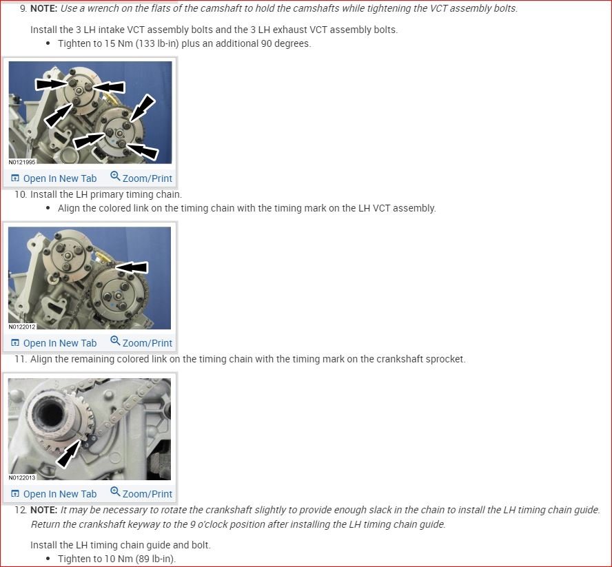

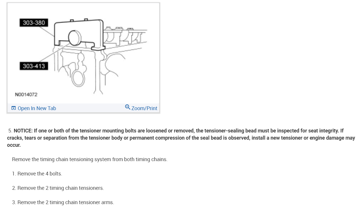

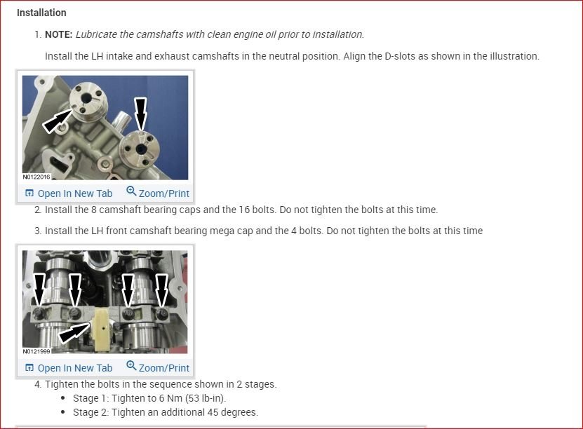

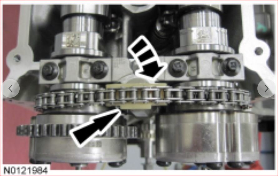

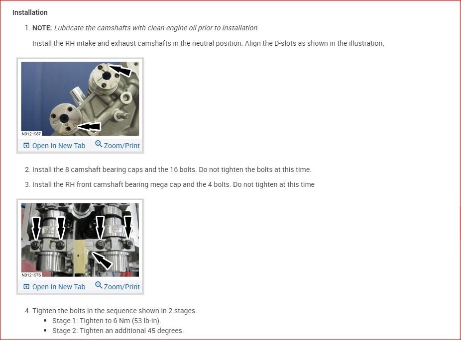

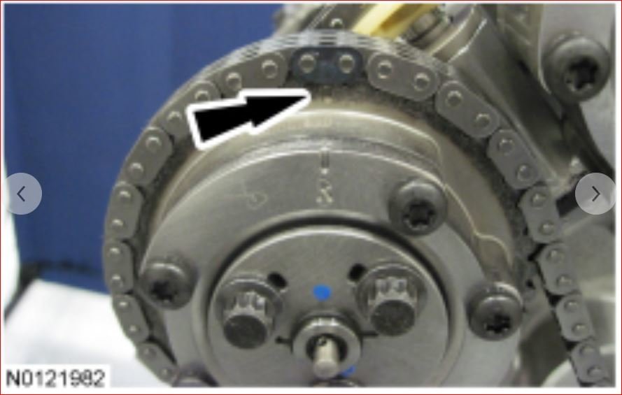

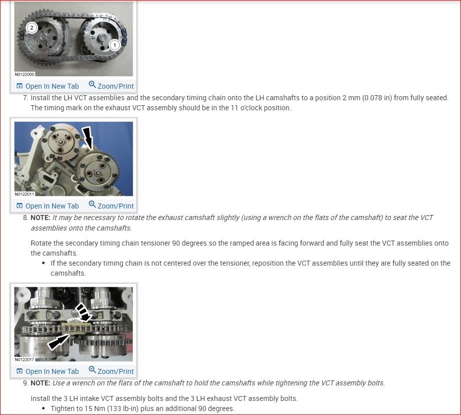

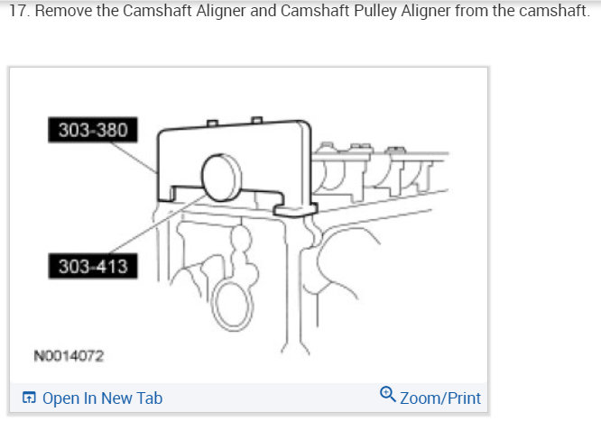

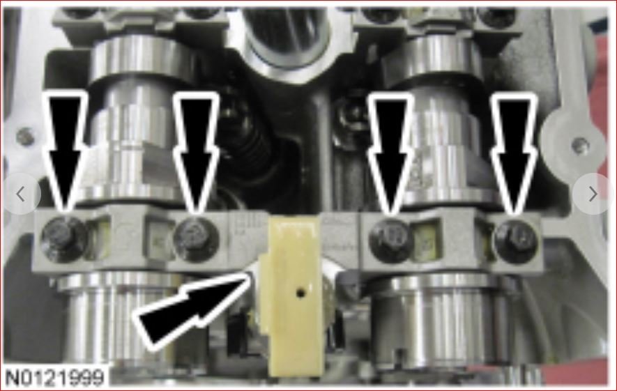

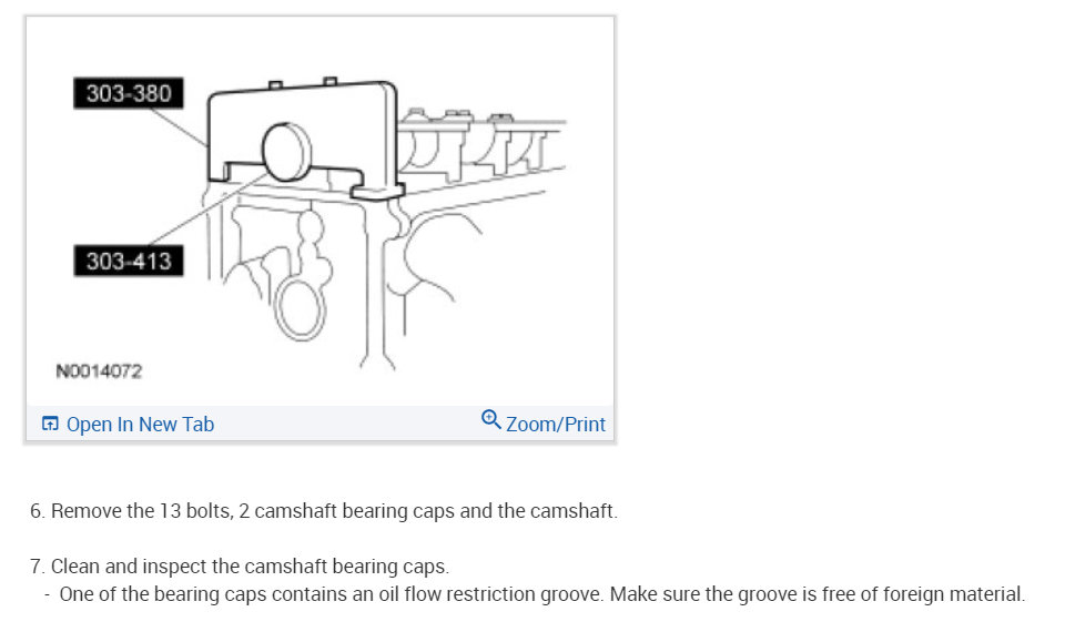

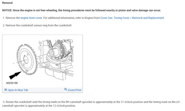

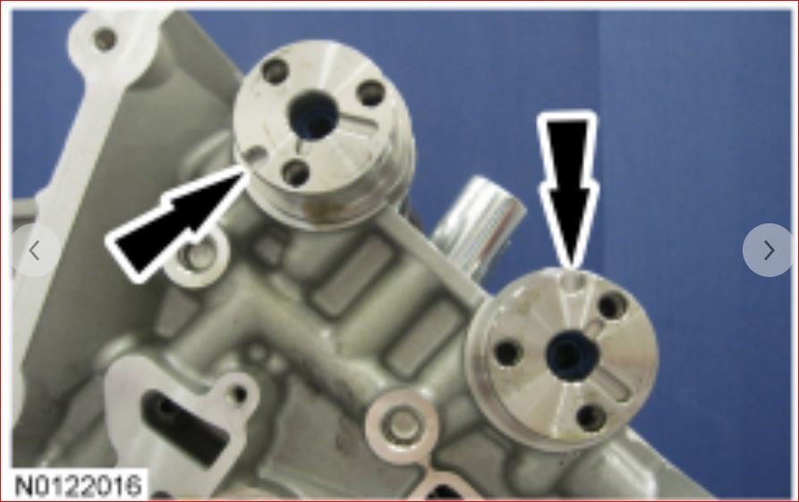

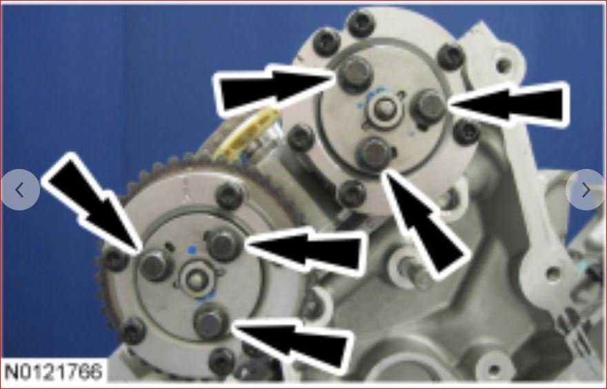

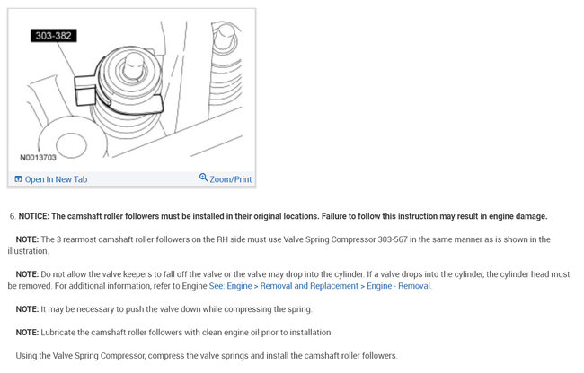

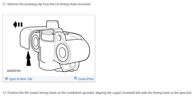

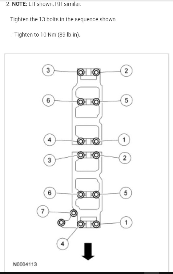

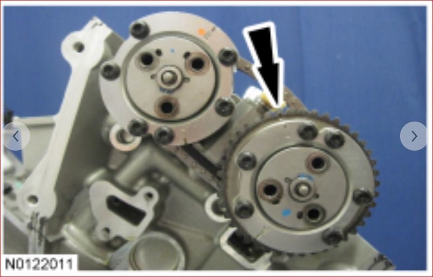

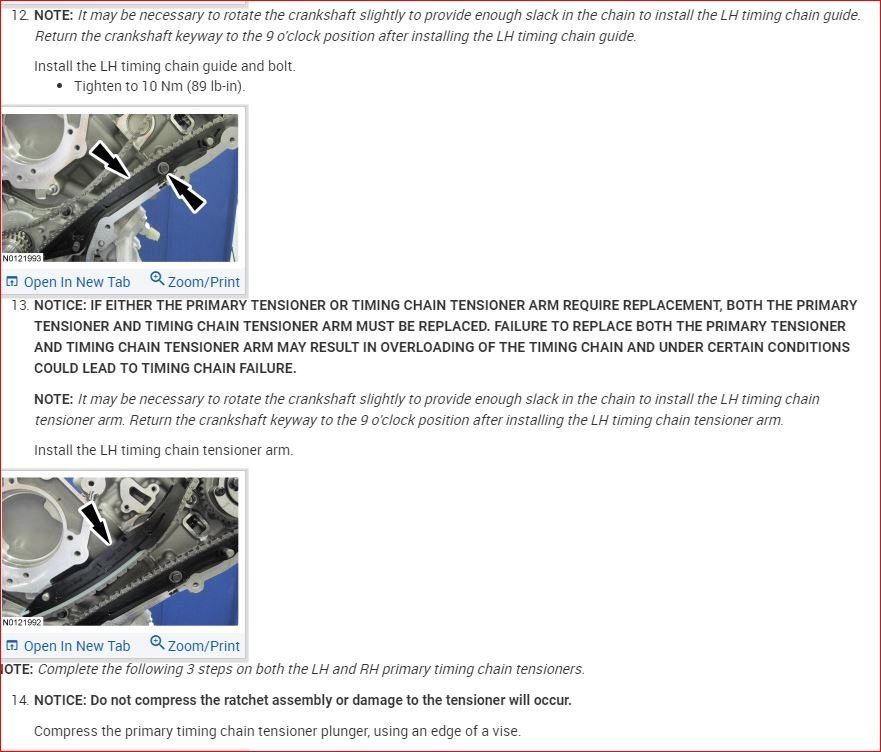

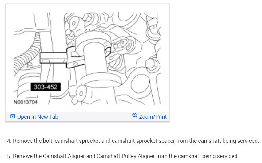

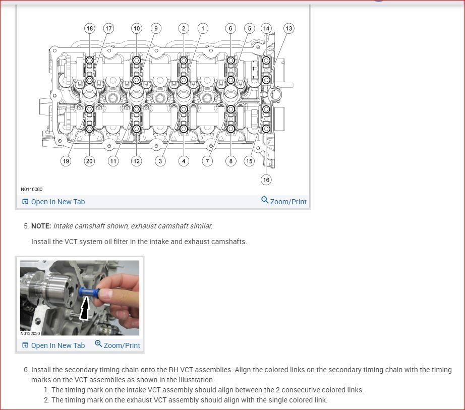

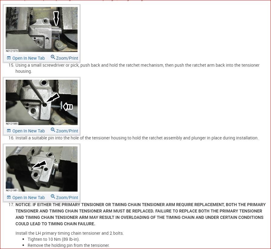

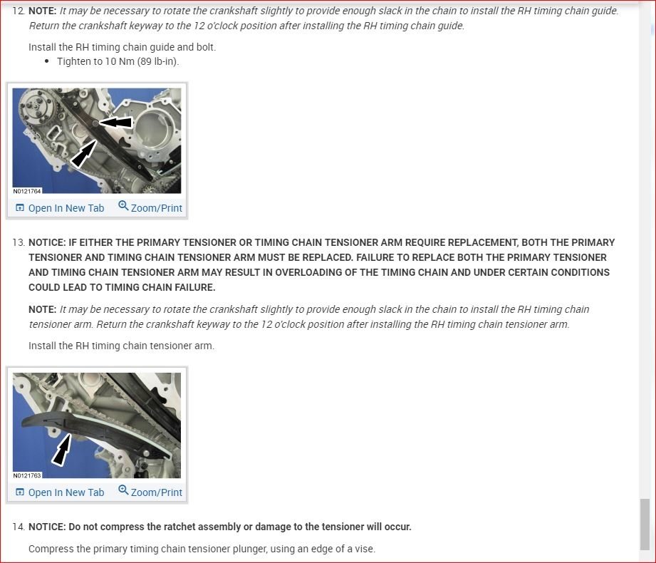

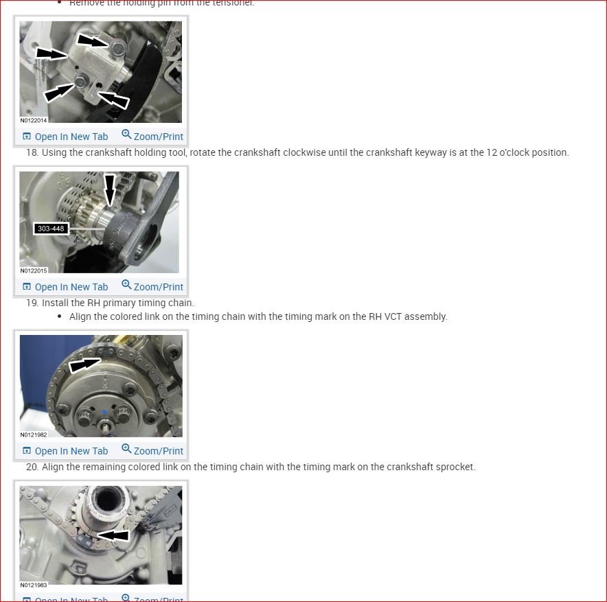

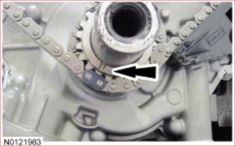

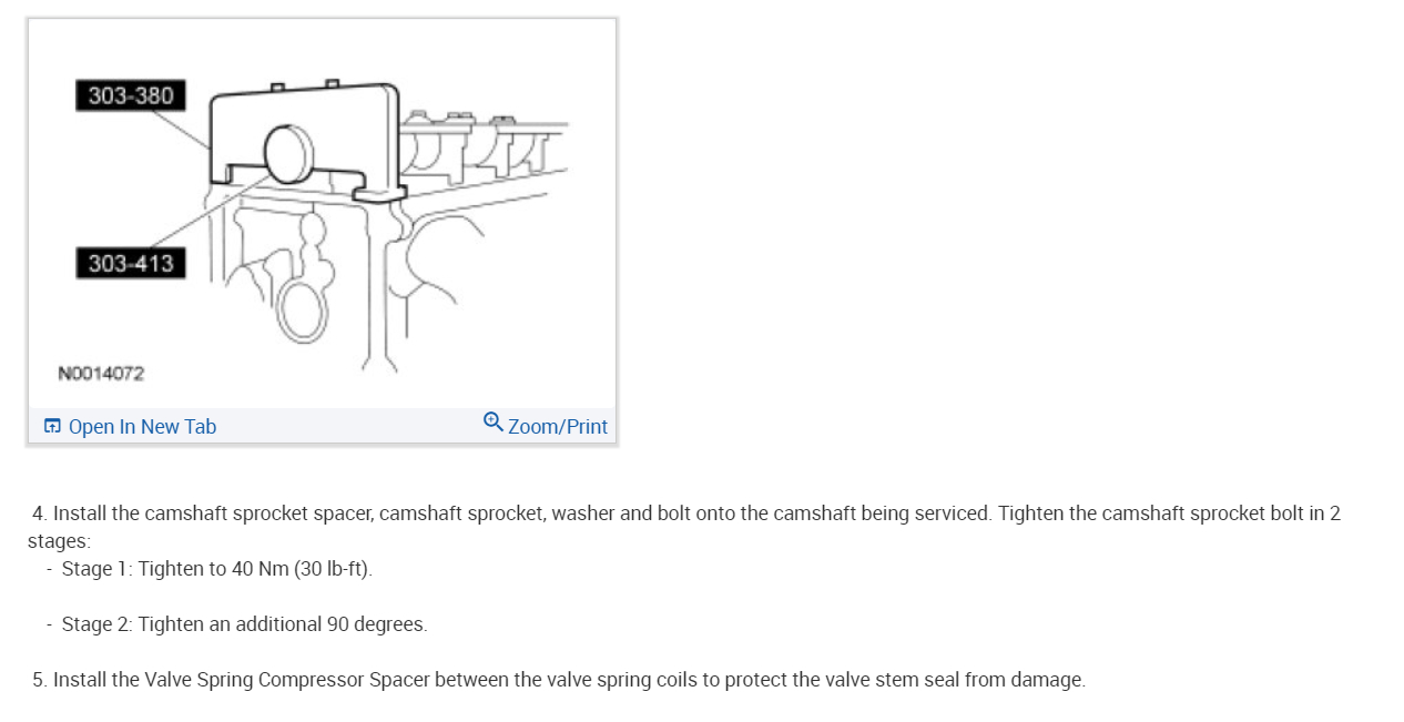

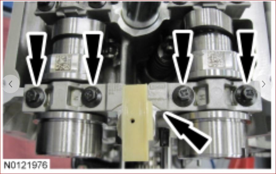

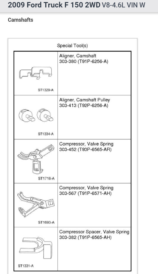

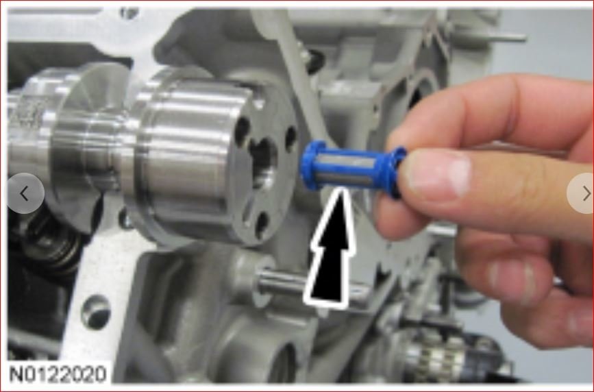

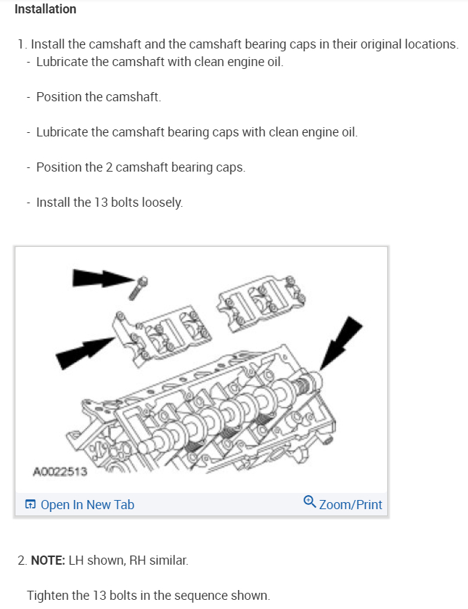

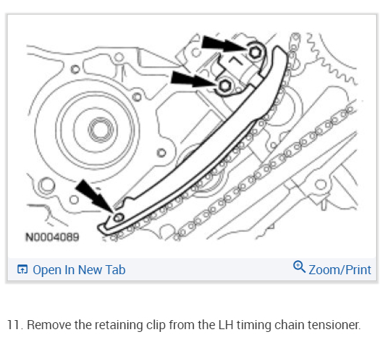

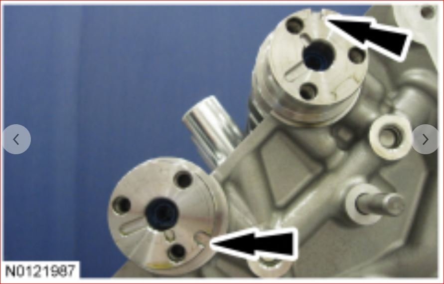

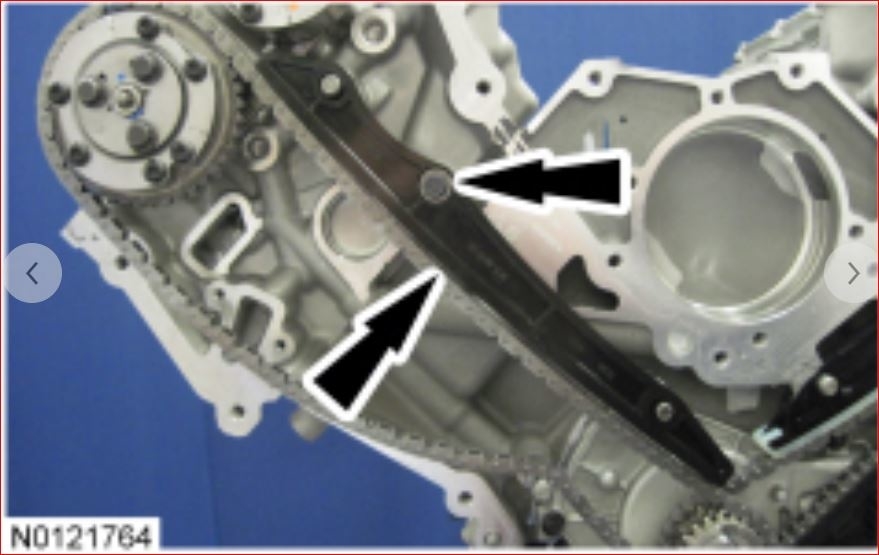

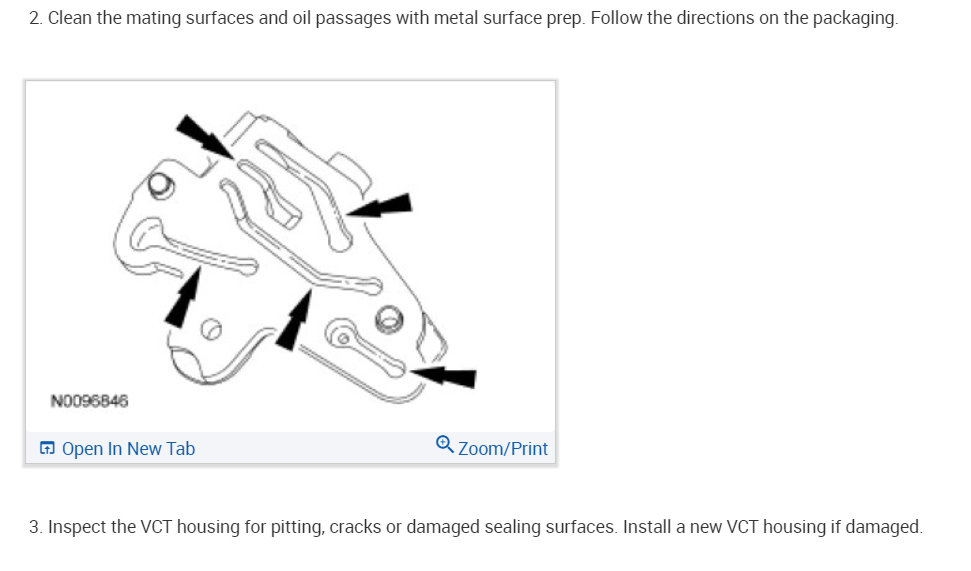

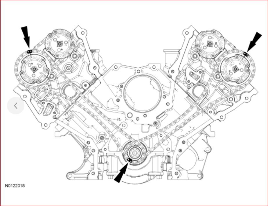

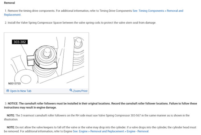

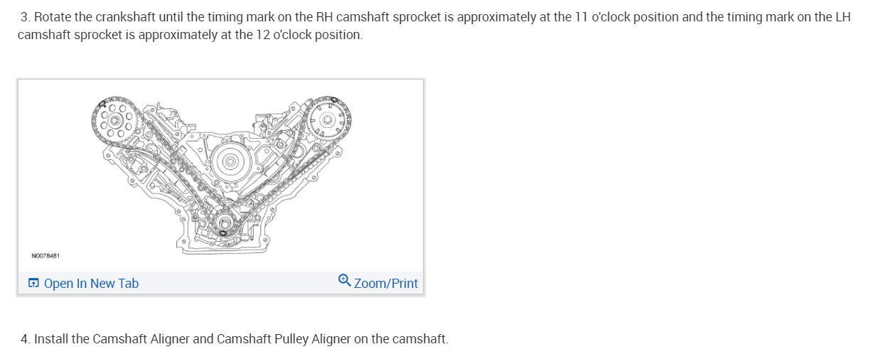

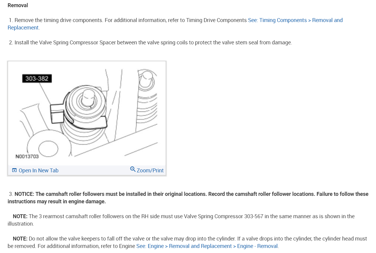

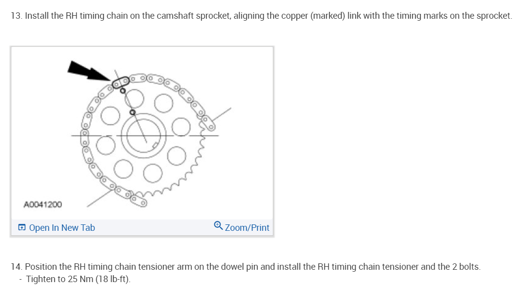

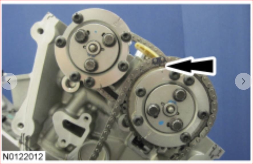

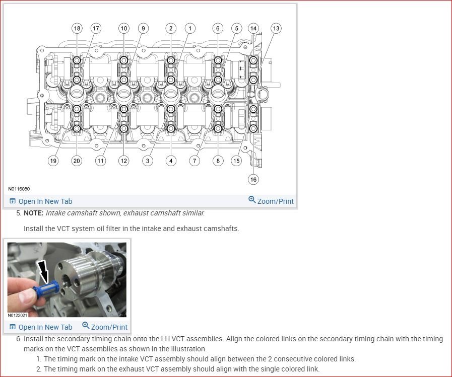

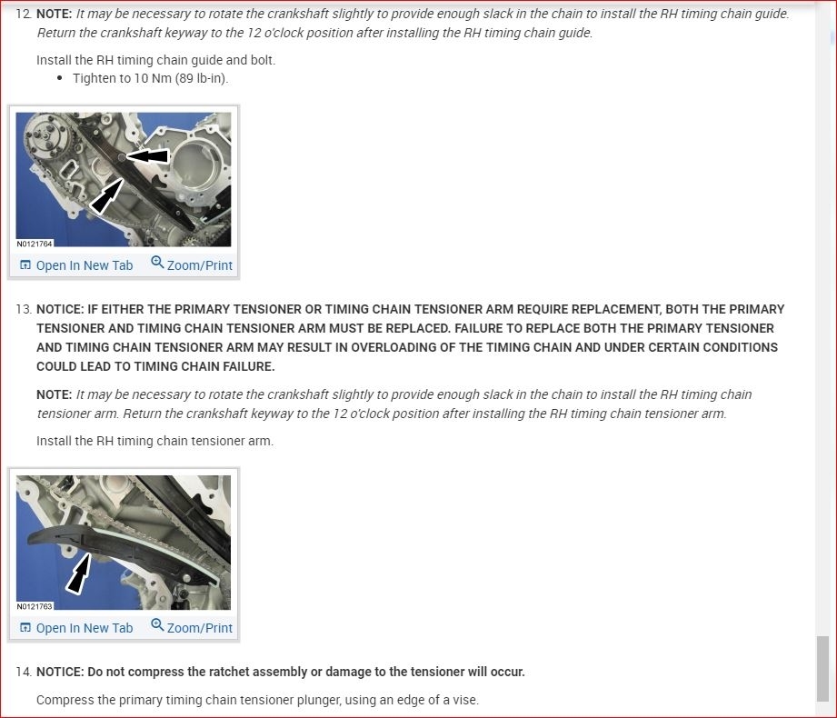

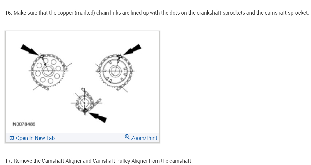

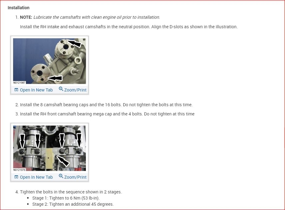

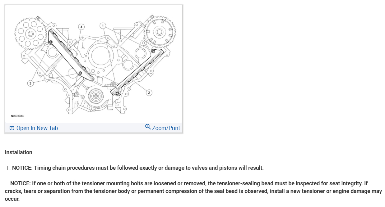

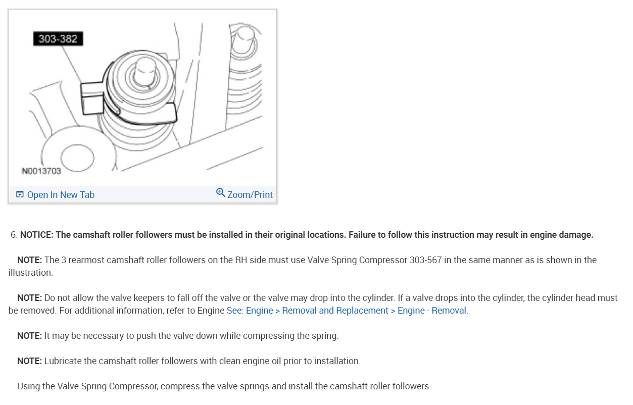

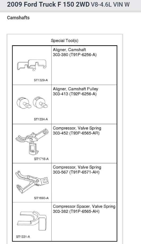

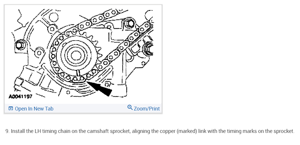

I need the correct timing procedure for both sides on this engine. Camshaft phasers.
Tuesday, June 4th, 2019 AT 3:59 AM
21 Replies
Hi Barnesbil,
I attached the process for reinstalling the cams for both sides. It includes all your timing marks to align everything. Let me know if you need something else.
+8
Tuesday, June 4th, 2019 AT 6:17 PM

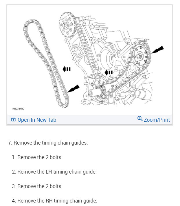

Want to replace timing chain, I need to know the timing chain diagram and where is the timing mark for a 2005 F- 150 with 5.4
-1
Saturday, September 19th, 2020 AT 1:51 PM (Merged)
WRENCHTECH
  • 20,761 POSTS
Here is the instructions on how to replace the timing chain in the diagrams below. Check out the diagrams (Below). Please let us know if you need anything else to get the problem fixed.

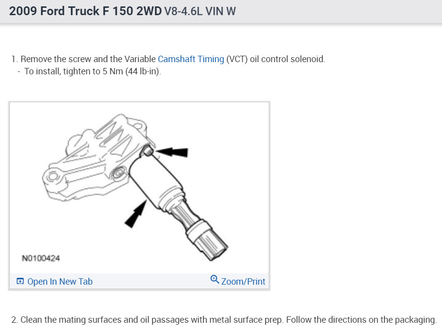

NEVER2FAST8704
  • 2004 FORD F-150
The vehicle cam in with a bad engine knock, engine was replaced with a jasper reman. Truck started and drove fine until you put it under a hard load. Check engine light cam on with po22 cam 2 overretarded. Replaced solenoid and was told phaser is new, we also checked oil pressure and is within specs. We changed the oil with synthetic and problem still exists.
MERLIN2021
  • 17,250 POSTS

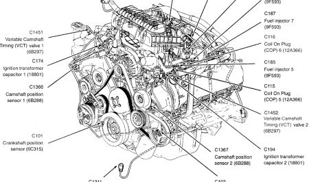

What engine does this one have? Also can you confirm this code? Bost are Pxxxx not Pxxx...?
HK15 KOER DTCS P0011, P1381, P0012, P1383, P0021, P1386, P0022 AND P1388: Ã Â Â CHECK the vehicle oil filter identification to make sure it is the proper type. Ã Â Â Engine at normal operating temperature. Ã Â Â Clear fault codes. Ã Â Â KOER Self Test. Ã Â Â CHECK KOER DTCs: Are DTCs P0011, P1381, P0012, P1383, P0021, P1386, P0022 or P1388 present? NOTE: Oil contamination in VCT systems can cause positioning errors. NOTE: VCT systems require an oil filter specific to the application. NOTE: CHECK the operation of the VCT solenoid and check for a stuck or sticking solenoid valve caused by contamination. If the valve is stuck, check the spider bracket for contamination prior to solenoid replacement.
https://www.2carpros.com/forum/automotive_pictures/62217_VCT_1.jpg
-2
NEVER2FAST8704
Yes the code is poo22, We changed the oil 2 times with mobil 1. The code will set with koer test. We removed the vct solenoid to inspect it and the screens were clean, we replaced it any way. Oil filter is a motorcraft for this app. The engine is a 3valve 5.4l sohc. I have seen ones that had vct problems due to sludge but this is a reman engine with no miles on it. I also grounded the solnoid and it appears to be working fine. I pulled valve cover and inspected the phaser and appears to be in time. Not sure where to go next with this.
+1
MERLIN2021
  • 17,250 POSTS
Did youi check the oil filter itself? It needs a specific type.
I am going to email you some testing info, let me know how you make out.
NEVER2FAST8704
It turned out to be a bad cam actuator, they said it was new, but upon inspecting found it was indeed a used one
+1

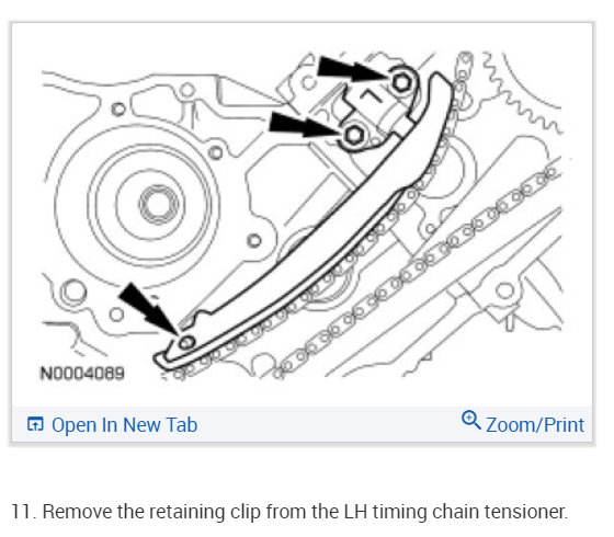

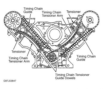

Are you sure the noise isn't coming from a tensionier? Here are the pictures I was able to find regarding the timing:
Driver's side
https://www.2carpros.com/forum/automotive_pictures/249084_4_2.jpg
Crank
https://www.2carpros.com/forum/automotive_pictures/249084_6_10.jpg
Passanger side
https://www.2carpros.com/forum/automotive_pictures/249084_1_7.jpg
Let me know if this helps.

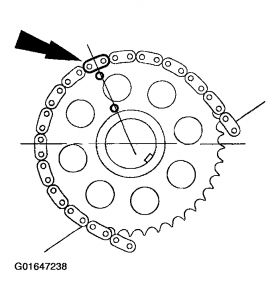

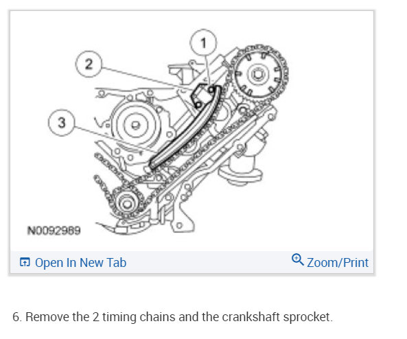

I can not find the copper link on my timing chain. Is there anything else I should be looking for. This is my first time trying to set my own timing. Didn't have a choice was layed off. I'm very worried that I'm not going to do this right.
Please help
Saturday, September 19th, 2020 AT 1:52 PM (Merged)
DAVE H
  • 13,384 POSTS

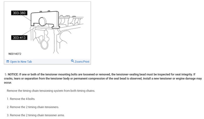

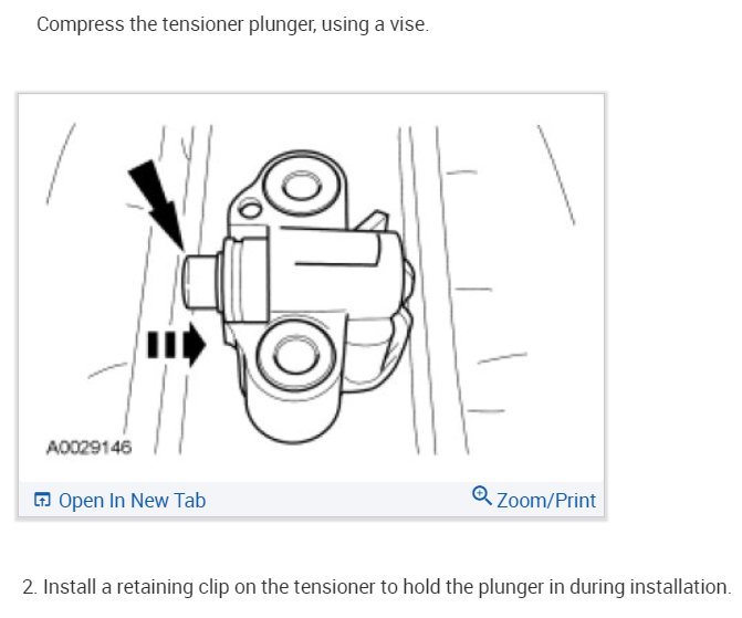

There are too many diagrams for me to show them all .. please re-post with any diagrams you require to see ? this is a very big job ... double check every step of the way ... let me know if ya need more assistance ..
https://www.2carpros.com/forum/automotive_pictures/266999_tools_2.jpg
Installation
CAUTION:Timing chain procedures must be followed exactly or damage to valves and pistons will result.
Fig. 282: Compressing Tensioner Plunger, Using A Vise
Courtesy of FORD MOTOR CO.

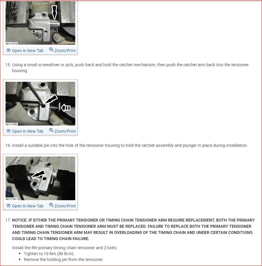

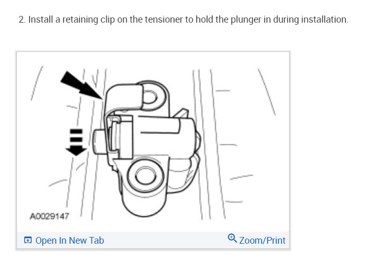

Compress the tensioner plunger, using a vise.
Install a retaining clip on the tensioner to hold the plunger in during installation.
Fig. 283: Installing Retaining Clip On Tensioner To Hold Plunger In During Installation
Remove the tensioner from the vise.

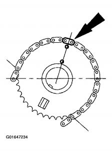

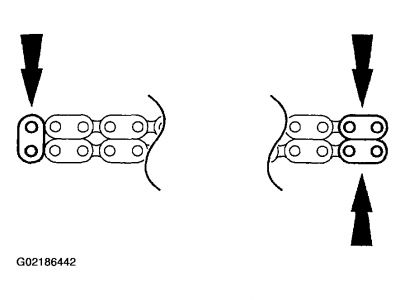

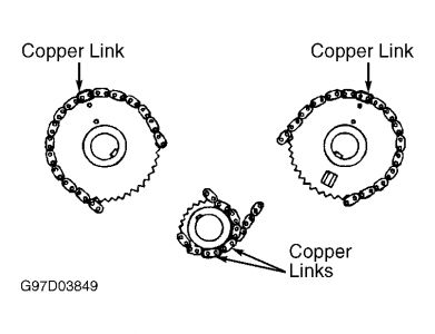

If the copper links are not visible, mark two links on one end and one link on the other end, and use as timing marks.
Fig. 284: Identifying Timing Marks On Timing Chain
https://www.2carpros.com/forum/automotive_pictures/266999_tim_1.jpg
Fig. 285: Installing Timing Chain Guides
Install the timing chain guides.

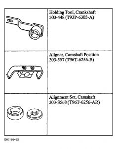

CAUTION:Do not turn the engine over with the camshaft positioning tool or damage to the camshaft sprocket or the bolt can occur.
Fig. 286: Installing Camshaft Positioning Tool
Fig. 287: Positioning Camshaft
Install the Camshaft Positioning Tool.
NOTE:Slightly loosen the camshaft holding tools to allow slight camshaft movement.
Pre-position the camshafts.
Rotate the LH camshaft with the Camshaft Positioning Tool until the timing mark is approximately at 12 o'clock.
Rotate the RH camshaft with the Camshaft Positioning Tool until the timing mark is approximately at 11 o'clock.
Tighten the Camshaft Holding Tools to maintain camshaft pre-positioning.

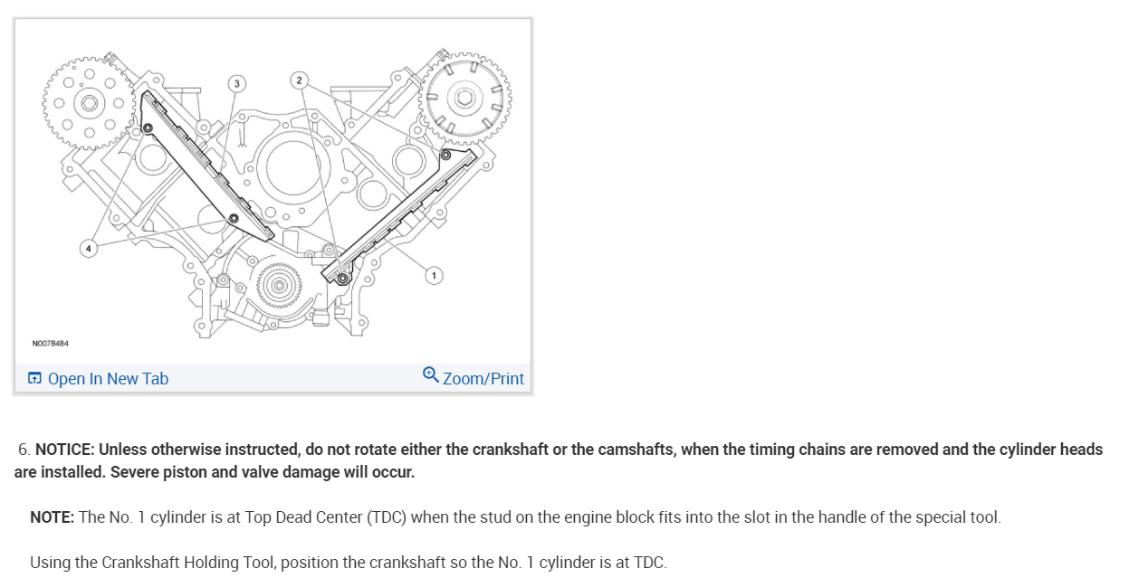

CAUTION:Unless otherwise instructed, at no time when the timing chains are removed and the cylinder heads are installed is the crankshaft or camshaft to be rotated. Severe piston and valve damage will occur.
CAUTION:Rotate the crankshaft counterclockwise only. Do not rotate past position shown or severe piston and valve damage can occur.
NOTE:The number one cylinder is at top dead center (TDC) when the stud on the engine block fits into the slot in the handle of the special tool.
Fig. 288: Rotating Crankshaft Counterclockwise
Position the crankshaft so the number one cylinder is at TDC with the special tool.

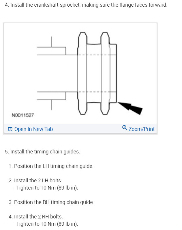

Install the crankshaft sprocket, make sure the flange faces forward.
Fig. 289: Identifying Direction Of Flange For Installing Crankshaft Sprocket

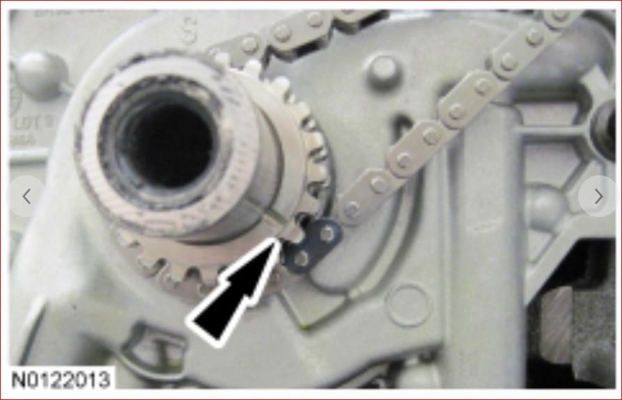

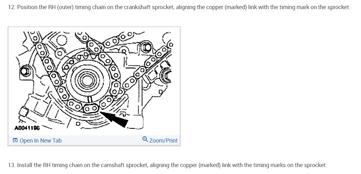

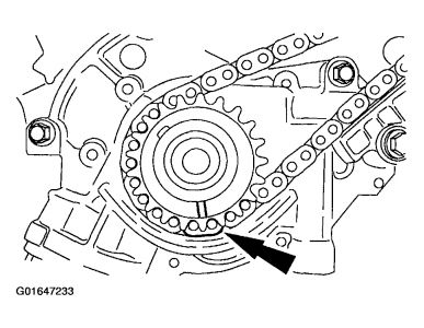

Position the lower end of the LH (inner) timing chain on the crankshaft sprocket, aligning the timing mark on the outer flange of the crankshaft sprocket with the single copper (marked) link on the chain.
Fig. 290: Aligning Timing Mark On Outer Flange Of Crankshaft Sprocket With Single Copper (Marked) Link On Chain
NOTE:Make sure the upper half of the timing chain is below the tensioner arm dowel.
NOTE:If necessary, use the Camshaft Positioning Tool to adjust the camshaft sprocket slightly to obtain timing mark alignment.
Fig. 291: Positioning Timing Chain On Camshaft Sprocket With Camshaft Sprocket Timing Mark Positioned Between Copper (Marked) Chain Links

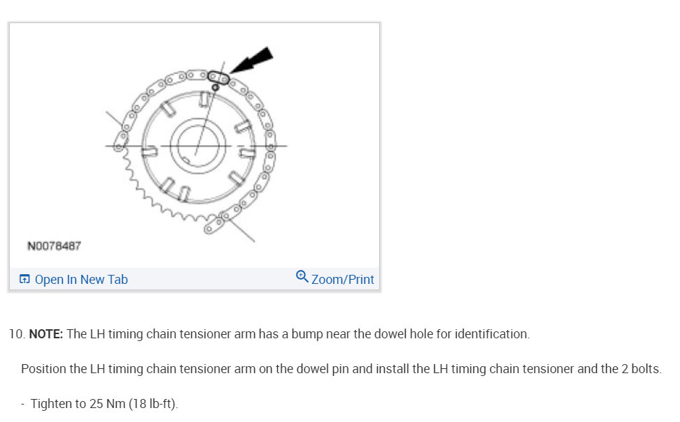

Position the timing chain on the camshaft sprocket with the camshaft sprocket timing mark positioned between the two copper (marked) chain links.
NOTE:The LH timing chain tensioner arm has a bump near the dowel hole, for identification.
Fig. 292: Identifying Tightening Torque Of LH Timing Chain Tensioner Bolts
Position the LH timing chain tensioner arm on the dowel pin and install the LH timing chain tensioner.

Fig. 294: Aligning Timing Mark On Sprocket With Single Copper (Marked) Link On Timing Chain
Position the lower end of the RH (outer) timing chain on the crankshaft sprocket, aligning the timing mark on the sprocket with the single copper (marked) link on the timing chain.

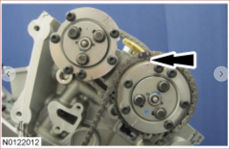

Fig. 295: Identifying Position Of Camshaft Sprocket Timing Mark
Position the RH timing chain on the camshaft sprocket. Make sure the camshaft sprocket timing mark is positioned between the two copper (marked) chain links.

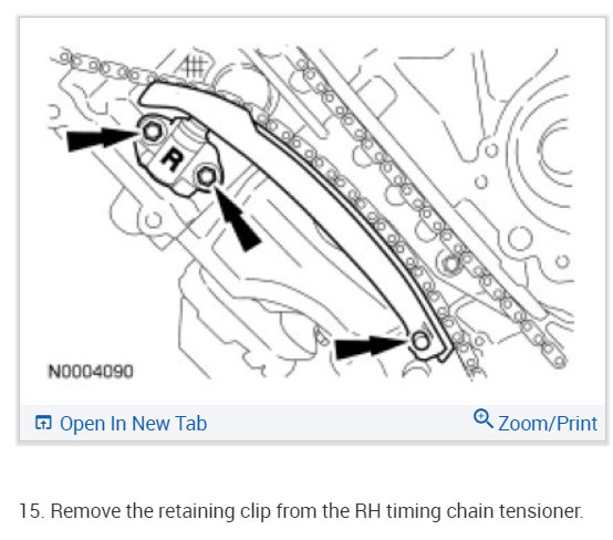

Position the RH timing chain tensioner arm on the dowel pin and install the RH timing chain tensioner.
Fig. 296: Identifying Tightening Torque Of RH Timing Chain Tensioner Bolts
Remove the retaining clip from the RH timing chain tensioner.
Fig. 297: Removing Retaining Clip From RH Timing Chain Tensioner
As a post-check, verify correct alignment of all timing marks.

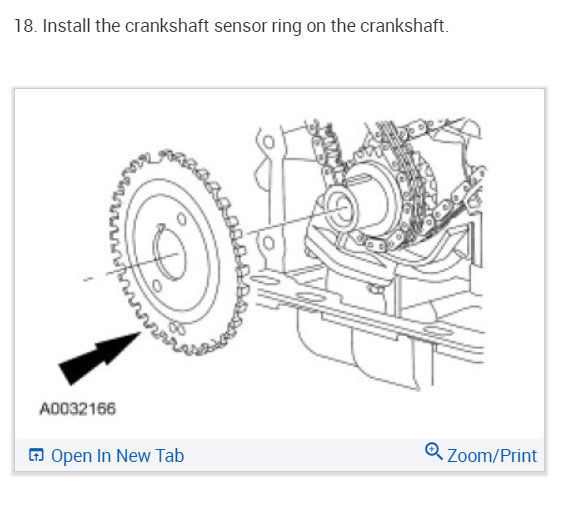

Position the crankshaft sensor ring on the crankshaft.
Fig. 300: Positioning Crankshaft Sensor Ring On Crankshaft
