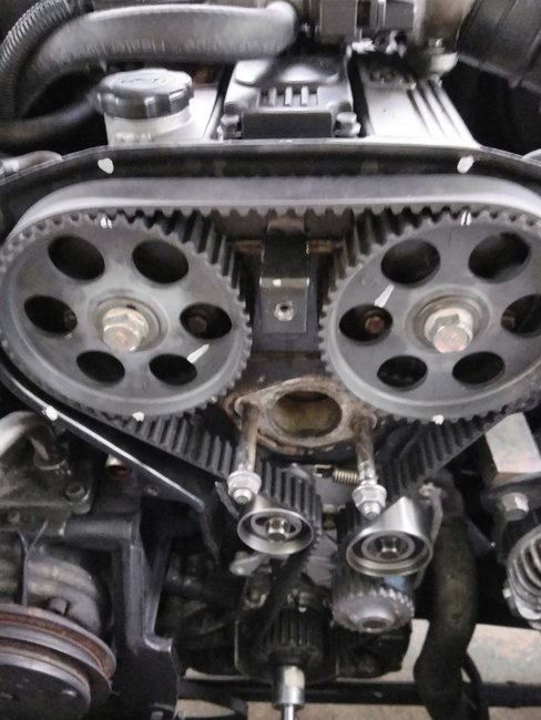

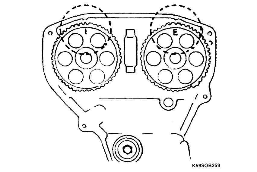

Tried three different times removing and adjusting the cam gears I even used clamps where the gears won't move marks. Are dead on then after the first rotation of the camshaft. The marks end up about half inch before the marks. Wish I'd have taken a picture before removing the belt for the fourth time. What am I doing wrong? I've followed the the example picture that were sent. So there is a click just as the marks line up. If not very careful it will click and be a little bit past the marks. So I've tried hard to stop the camshaft before it hits that click. Can I bend valves doing this? Thanks. JC

What marks?
Can you post a picture of the makes after 1 rotation?

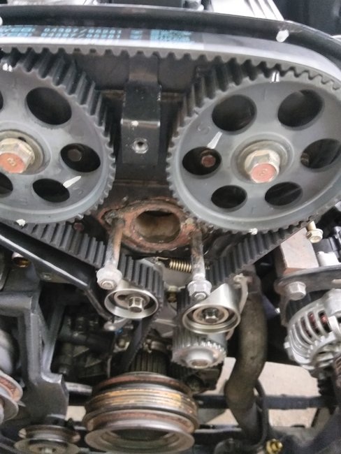

I have tried again this time the cam marks look pretty good but now the crankshaft mating marks are off by about 30 to 40 degrees past the marks after one rotation. I got a question for you when you turn the camshaft sprockets do you stop before the click
because it's hard too do. Just as you come up on the marks just a hair and there's a click and you've gone past the marks? JC Oh, yes it's raining so I had to quit, I'll get you the pictures of the marks.

Sprocket on the left intake is off.

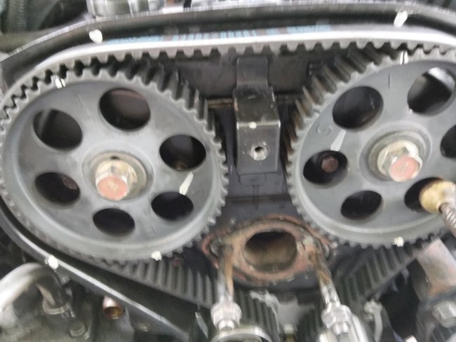

Another shot.
Apr 7, 2021 at 6:52 AM
Okay. Is that with the crank on its mark?
The belt is way too loose it should be taunt between the two gears.

Yes, if you enlarge the photo you can see the crankshaft gear and white mark at the bottom of the picture. Thanks
Okay. the belt is too loose and will not line up the cam marks.

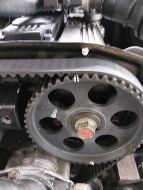

Okay, the spring is attached I put a cats paw behind the tentioner and put pressure on the tentioner while tightening the bolt down. It's got very little give at the top between the cam gears and the tention side of the belt. It's being kind of hard to start too and the exhaust side cam gear is a little before the mark where it should be. Could that make it hard to start? I noticed when I rotated the motor by hand and aligned the marks that way When I got the key it started right up. Could it be I need to loosen the belt back up and do the cam gears and all again? Crankshaft gear is dead on intake side is dead on but exhaust is a little off.
Apr 7, 2021 at 6:53 AM
Give me a picture.

It's a little before the mark.
It is off one tooth. Need to reset it exactly. That is why it does not start easily.

Great okay. just the cam gear by itself
Or turn the crankshaft gear one tooth?
No, if you turn the crank, the it will all be off.
Just turn the cam 1 tooth inside the belt.
