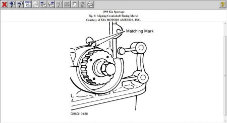

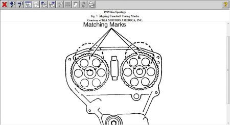

How do I time the camshafts to the crankshaft and make sure the crankshaft is not 180 degrees off
Monday, May 11th, 2009 AT 7:42 PM
MECHANIC
75,992 POSTS
Put the engine no.1 piston on its compression stroke/TDC align below then install the belt
