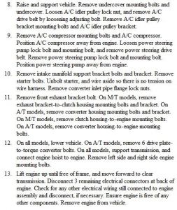

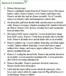

Four cylinder two wheel drive automatic 108,000 miles.

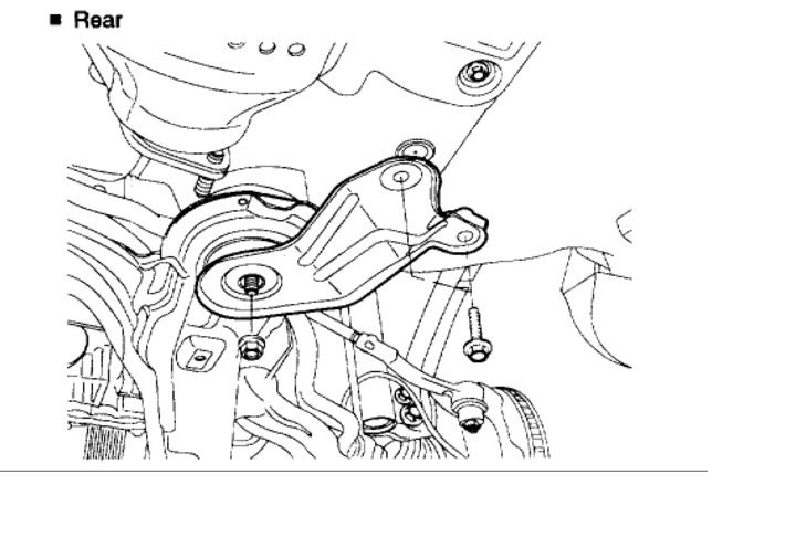

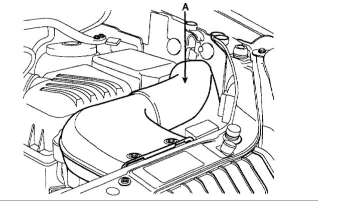

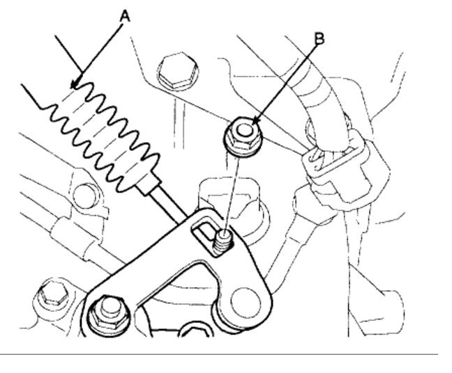

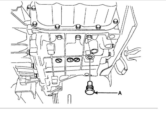

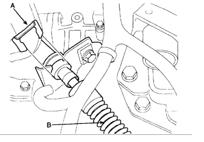

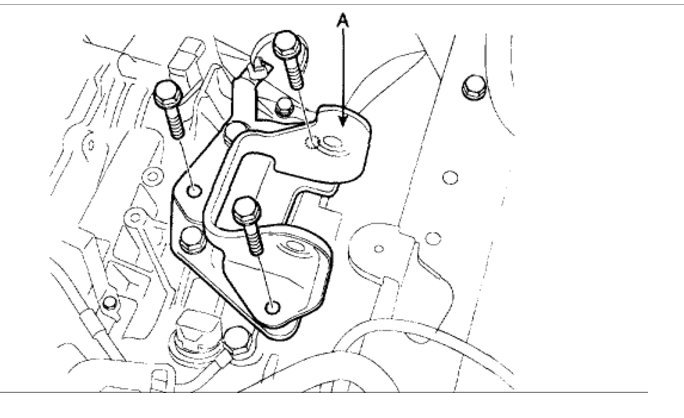

How to remove bolts from torque converter?
Monday, July 5th, 2010 AT 9:22 AM
BLUELIGHTNIN6
MECHANIC
16,542 POSTS
You access the torque converter bolts through the starter hole.
