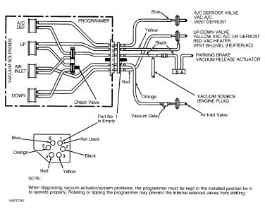

JULE ROBERTS
Air Conditioning problem
1995 Cadillac Deville V8 Front Wheel Drive Automatic 150K miles
When I first turn on the a/c, it may or may not blow out of the a/c vents. If it does, the first bump we hit, or acceleration and the a/c will blow only out the defrost vents at the front windshield, and there it stays. I have had the car at the Cadillac dealership, and two differenc a/c specialists, they say they have never seen this problem before, and don't have a clue. I am helpless. have you ever heard of this, and what could cause this. Cadillac said they checked the whole a/c system, and all of the modules. I am on disability and really can't take the heat here in Florida.
Jul 21, 2020 at 11:05 AM (Merged)
DOCFIXIT
  • 18,828 POSTS
Have them check out the check valve to controller see diagram
https://images.2carpros.com/forum/automotive_pictures/198357_Graphic_545.jpg

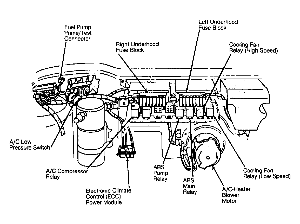

TRULOVE
Have 93 sixty special Cad. LED on ac won't come on. AC blows thru defrost until led comes on. Have noticed when it's cold or humidity is low (not often down here) it will work after car has run for awhile. System regulates to 75 degrees and will work once LED lights up. Fuel gauge does sometimes does the same. Appreciate ANY help I can get.
Jul 21, 2020 at 11:07 AM (Merged)
RIVERMIKERAT
  • 6,110 POSTS
It sounds like you have a low refrigerant issue. Open the hood and start the car. While the engine idles, turn on the AC. See if the clutch engages on the compressor. Check the relays in the system under the hood. High humidity areas cause electrodes to corrode. You might want to use some rubbing alcohol and an old toothbrush to clean the electrical contacts of the relays, switches and connectors.
WRENCHTECH
  • 20,761 POSTS
I think your issue is electrical in nature and would have to be troubleshooted while the problem is present.
TRULOVE
Where are the relays, switches and connectors to clean? Thx
RIVERMIKERAT
  • 6,110 POSTS
Refer to the attached image. The relays are (facing the engine from the front) at the right rear of the engine compartment.
The compressor coil connector is on the front of the compressor behind the pulley. The switches are the ones on the dash you use to control the A/C.

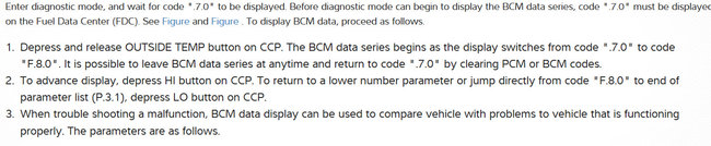

HMAC300
  • 48,601 POSTS
because you have automatic temperature control do what is listed in picture and get back to us with codes. it will be an F code.
OSEPHUS
  • 19 POSTS
hmac, I have a lot of codes they are all e26-30-53-70-91-98.
HMAC300
  • 48,601 POSTS
those are all PCM codes for engine if no codes are coming up with F then you will have to find someone who can read them for you. if engine runs okay and no check engine light is on then these are stored codes so you can disregard them if not get back to me.
