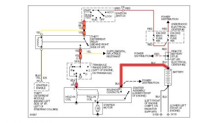

My car has been starting and running good for a long time and just two days ago. I went to start it and nothing happend. The battery has a ggod charge. Starters ok, alt. Is good, all my fuses are fine. I turn the key and all I hear in a clicking sound coming from the dask in the area of the glove box.

The clicking noise you're hearing is the theft deterrent relay-Probable causes could be the ignition switch, the relay,transaxle range switch, and starter itself
https://www.2carpros.com/forum/automotive_pictures/12900_starting_circuit_2.jpg
