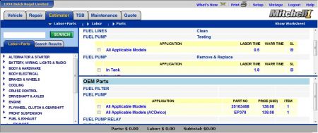

THERE IS NO FUEL PRESSURE, IS THE FUEL PUMP IN THE TANK?IF IT IS HOW DO I EMPTY THE FUEL TO GET TO THE FUEL PUMP. HOW HARD IS IT REMOME THE TANK?

Get a siphoning device and drain it-drop the tank-its alot of work to do here. If you haven't done it best bring her in.

Sir I love your intention but am just too far away from you I'm in the big blue pacific ocean. The costs here varies could range from 70.00-125.00 USD per hr.
https://www.2carpros.com/forum/automotive_pictures/12900_fuel_pump_28.jpg

MY SON CAME HOME TODAY AND THE BUICK STARTED. THE CAR IS FINE NOW BUT I AM CONCERN THAT IT WILL DO IT AGAIN IS THERE ANY REASON WHY THIS WOULD HAPPEN OR CAN YOU TELL ME WHAT I SHOULD LOOK INTO NEXT TO SOLVE THE PROBLEM BEFORE IT BECOMES A PROBLEM

Could be the fuel pump relay or the fuel pump is getting tired-
