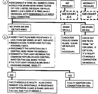

Disconnect a sparkplug wire or 2 and ground it to the engine -have helper crank engine over-do you have a snapping blue spark? If so-you have a fuel related problem, check the fuel pressure to rule out the fuel filter/fuel pump/pressure regulator and listen to the injector/s are they pulsing or hook up a noid light. No snapping blue spark continue to troubleshoot the ignition system-power input to the coil/coil packs, cap and rotor /distributor pick-up coil, ignition control module, ECM, Ignitor cam and crank sensors- Note: If it doesn't apply disregard it

Next time it refuses to start don't wait for it to make up its mind-do below immediately to determine if its fuel or spark problem
Get a helper disconnect a sparkplug wire or 2 and ground it to the engine atleast 3/16 away from ground-have helper crank engine over-do you have a snapping blue spark? If so-you have a fuel related problem, check the fuel pressure to rule out the fuel filter/fuel pump/pressure regulator and listen to the injector/s are they pulsing or hook up a noid light. No snapping blue spark continue to troubleshoot the ignition system-power input to the coil/coil packs, coil's resistances, cap and rotor, distributor pick-up coil, ignition control module, cam and crank sensors and computer Note: If it doesn't apply disregard it and keep testing

First of all thank you so much for your donation. When the car doesn't start is the security light on or flashing?Also does the car turn over when it doesn't start?If it does turn over when it doesn't then I need you to check for spark and what the fuel pressure is. Also what is the 8th digit of the vin?

I emailed you some trouble tree's one for crank's but won't start and one for security light stays on solid or flashes plus a wire diagram.I would print them all out so there easier to read and portable. You will also need a multimeter to do the testing. Let me know what you find.
