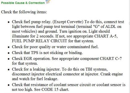

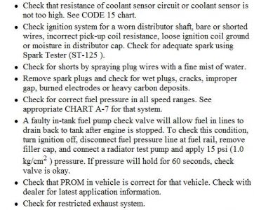

Even though there are 100K+ miles thereon, she's been, how do you say, super powered. I bought her in 1995.
She's now refusing to start right away: new battery, new alternator, maintenance up-to-date.
COULD IT BE THAT SHE NEEDS A FUEL INJECTOR CLEANING?
HOW ABOUT IF WE CLEAN THE GAS TANK, since it could be particles clogging the fuel injector.
I have other concerns, but this is the main one. After she starts, she runs like a "jet."
The alternator was a "car salvage" replacement. Could it have gone bad already?
Thanks.
Friday, April 3rd, 2009 AT 4:54 PM
ZACKMAN
  • 4,202 POSTS
It is not your alternator. Follow this diagnostic instead. If you don't have it, it may not apply to your vehicle.
https://www.2carpros.com/forum/automotive_pictures/55316_89lesabrehardstart1_1.jpg
https://www.2carpros.com/forum/automotive_pictures/55316_89lesabrehardstart2_1.jpg
