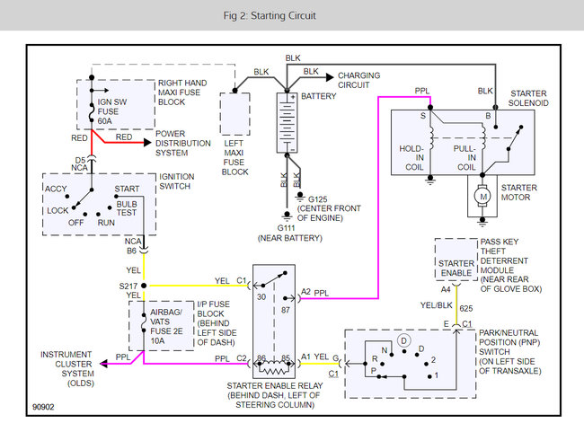

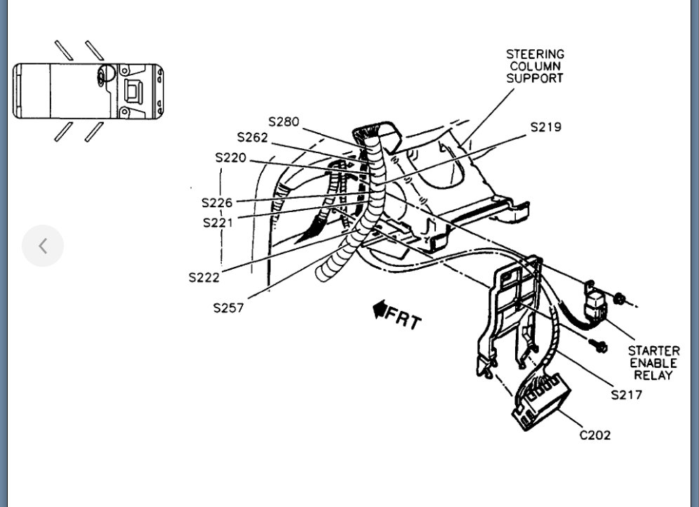

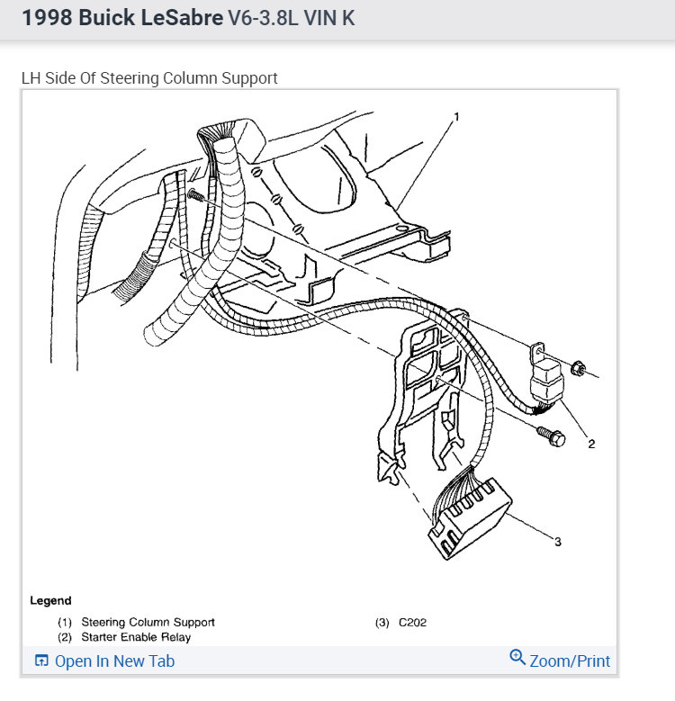

Car failed to start, found starter had an open on the field windings. Replaced starter, no improvement. Haynes manual schematic shows a starter enable relay in the circuit. I cannot locate this relay to check it. It provides the 12 volts to initiate the holding circuit to allow the starter motor to turn the engine. I need a location for this relay and any other suggestions about this problem.

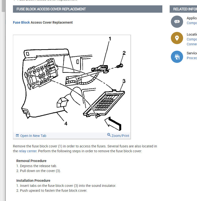

Under the left hand of the instrument panel, above the instrument panel fuse block. Look just left of the steering column support and on a bracket beside the main wiring conduit. You will have to remove the fuse block cover and panel.
Starter Enable Relay Behind left side of dash, left of steering column.
This guide can help as well:
Here is the starter wiring diagrams as well. Check out the diagrams (below). Please let us know if you need anything else to get the problem fixed.

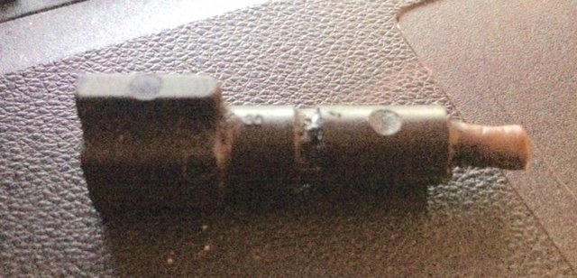

I replaced the starter with attached solenoid. Unfortunately I broke the connector on the small wire, not the battery one.
Can I just get a copper crimp on ring terminal and crimp it on the end of the cable? Concerned that the piece shown has something important in it?
Nov 18, 2020 at 12:13 AM (Merged)
  • 110,248 POSTS
Yes, you can do what you suggested. However, make sure you get a quality part and replace any covering the original wire may have to eliminate the possibility of a short.

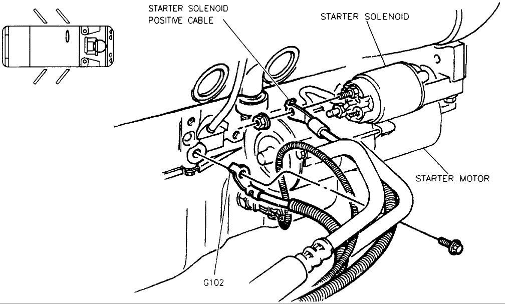

  • 75,988 POSTS
1997 Buick LeSabre V6-3.8L VIN K Starter Replacement: Starter Motor Mounting
https://images.2carpros.com/forum/automotive_pictures/12900_sm_1.gif
REMOVE OR DISCONNECT 1.Negative battery cable. 2.Raise vehicle. 3.Splash shield. 4.Bolts to flywheel inspection cover. 5.Flywheel inspection cover. 6.Starter wiring. 7.Starter mounting bolts. 8.Starter. INSTALL OR CONNECT NOTICE: Before installing starter motor to engine, he sure electrical terminals are secure by tightening nuts next to cap on solenoid battery terminal and on the SD-255 "S" terminal. If these terminals are not tight in solenoid cap, the cap may be damaged during installation of electrical connections and cause starter to fall later. 1.Starter. 2.Starter mounting bolts. Tighten *Bolts to 43 N.m (32 lb. ft.) . 3.Starter wiring. Tighten *Nut on solenoid battery terminal to 16 N.m (12 lb. ft.) . *Nut on "S" terminal to 2.5 N.m (22 lb. in.) . 4.Flywheel inspection cover. Tighten *Bolts to 7 N.m (62 lb. in.) . 5.Splash shield. 6.Lower vehicle. 7.Negative battery cable. Tighten *Cable bolt to 15 N.m (11 lb. ft.) .

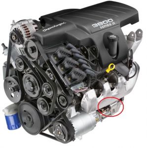

Raise the vehicle. If you lie on your back, it will be in the very front of the motor, on the driver side. This is not your motor, but the starter location is similar.
https://images.2carpros.com/forum/automotive_pictures/55316_gm3800_1.jpg
Suggested Repair
Locate the starter enable relay behind the left side of the dash, left of the steering column and above the instrument panel fuse block. Remove the fuse block cover and panel, then verify that the relay supplies 12 volts to the starter holding circuit.
Conversation Summary
The owner of a 1998 Buick LeSabre replaced a starter with open field windings, but the engine still would not crank. They could not find the starter enable relay shown in the Haynes schematic. An expert said it is behind the left side of the dash, left of the steering column and above the fuse block, and referenced starter wiring diagrams and a replacement guide.
