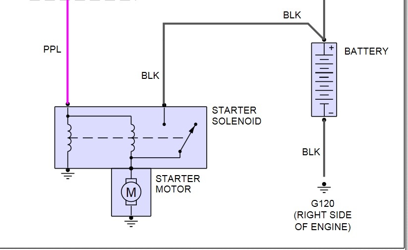

1993 buick lesabre 130,000 miles 3.8 engine. does anyone have a good diagram or picture of where both the positive and negative cable attach to the car opposite of the battery post end.

Note the diagram for battery cables. It shows two positive cables, one goes to the starter solenoid, the other circuit goes to underhood fuse box. The negative cable attaches to right side of engine.
Sometimes the battery ground cable, at engine, is buried and hard to get at. Sometimes I make a new ground cable and attach that end to the alternator bracket. Seems to work ok. Just make sure the cable doesn't interfere with pulleys--belts--exhaust manifold or anything. If you crimp a battery cable end, make real sure you get a good crimp on it, You don't want a battery cable end coming loose, under the hood.

Trace the two positive battery cables to the starter solenoid and the underhood fuse box. The negative cable attaches to the right side of the engine. If that ground is hard to reach, a new ground cable can be attached to the alternator bracket, routed clear of belts, pulleys, and the exhaust manifold, and securely crimped.
