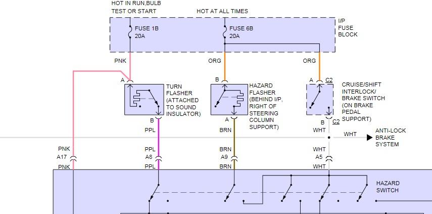

Buic LeSabre'95
Bows signal circuit lights fuse every couple minuts, sometimes even i don't touch the turn switch, replaced multi switch and there was no problem with fuse for about half a year, problem came again recently, fuse keeps blowing

If you think the problem is the wiring circuit, splice in a new wire, That is faster than trying to find the faulty place. To splice, you leave a pigtail at both ends, splice in a new wire. You don't have to properly route the new wire till your sure everything works ok.
You may have to check the back of fuse box to make sure nothing burned or melted.

Suggested Repair
Splice in a new turn-signal circuit wire using pigtails at both ends, and inspect the back of the fuse box for burned or melted connections.
Conversation Summary
The owner of a 1995 Buick LeSabre reports the turn-signal fuse blows every few minutes, sometimes without using the switch. Replacing the multifunction switch stopped the problem for about six months, then the fuse began blowing again. The expert suggests a wiring short and recommends splicing in a new wire rather than hunting the fault, plus checking the fuse box for heat damage.
