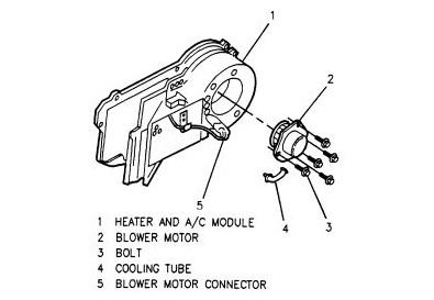

I have a 1997 Buick Lesabre (120000 miles, auto) and I need to replace the heater blower fan as it no longer works, but I have one problem... I am not quite sure where the fan is located and I don't want to have to tare apart the whole dash looking for it. Where abouts would it be located and what is the easiest aproach to removing it?

Don't worry about the dash. You remove blower motor from engine side of firewall. Found this picture.

Replace the heater blower motor by removing it from the engine side of the firewall rather than disassembling the dash.
Conversation Summary
The owner of a 1997 Buick LeSabre with 120,000 miles needed to replace a non-working heater blower fan and asked where it is located and the easiest way to remove it. The expert advised against tearing apart the dash and said the blower motor is removed from the engine side of the firewall.
