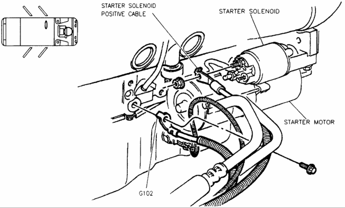

DANTE
where is the starter on a 97 buick lesabre?
Nov 18, 2020 at 12:12 AM (Merged)
  • 75,992 POSTS
The starter is on the left side of the engine block down low here is a guide and a diagrams below to help you change the starter motor out.
if the start is not working this guide will help
Cheers

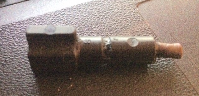

NYHUNTER
I replaced the starter with attached solenoid. Unfortunately I broke the connector on the small wire, not the battery one.
Can I just get a copper crimp on ring terminal and crimp it on the end of the cable? Concerned that the piece shown has something important in it?
Nov 18, 2020 at 12:13 AM (Merged)
  • 110,244 POSTS
Yes, you can do what you suggested. However, make sure you get a quality part and replace any covering the original wire may have to eliminate the possibility of a short.

  • 75,992 POSTS
1997 Buick LeSabre V6-3.8L VIN K Starter Replacement: Starter Motor Mounting
https://images.2carpros.com/forum/automotive_pictures/12900_sm_1.gif
REMOVE OR DISCONNECT 1.Negative battery cable. 2.Raise vehicle. 3.Splash shield. 4.Bolts to flywheel inspection cover. 5.Flywheel inspection cover. 6.Starter wiring. 7.Starter mounting bolts. 8.Starter. INSTALL OR CONNECT NOTICE: Before installing starter motor to engine, he sure electrical terminals are secure by tightening nuts next to cap on solenoid battery terminal and on the SD-255 "S" terminal. If these terminals are not tight in solenoid cap, the cap may be damaged during installation of electrical connections and cause starter to fall later. 1.Starter. 2.Starter mounting bolts. Tighten *Bolts to 43 N.m (32 lb. ft.) . 3.Starter wiring. Tighten *Nut on solenoid battery terminal to 16 N.m (12 lb. ft.) . *Nut on "S" terminal to 2.5 N.m (22 lb. in.) . 4.Flywheel inspection cover. Tighten *Bolts to 7 N.m (62 lb. in.) . 5.Splash shield. 6.Lower vehicle. 7.Negative battery cable. Tighten *Cable bolt to 15 N.m (11 lb. ft.) .
