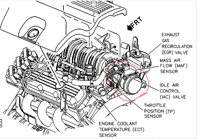

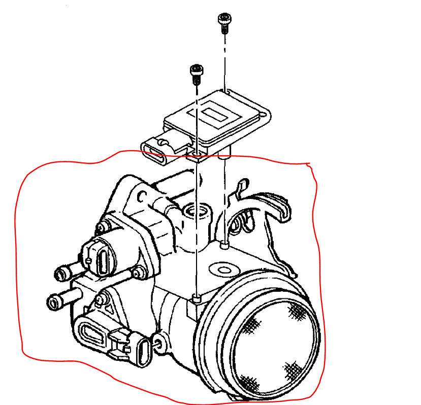

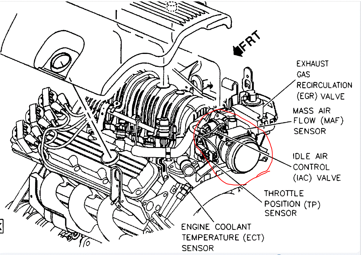

Yes, I agree. I don't see them causing a no-start. By chance, did you try the starting fluid trick to see if it starts? You mentioned not knowing where the throttle body is located.
From the air filter box, follow the air induction tube to the engine. (Large tube). It mounts to the front of the throttle body. Remove it and have someone press the throttle to the floor, spray starting fluid in it (a small amount), release the throttle, and see if it starts.
I attached two pics of the throttle body below. Try this. I read back through the last few posts from you and noted running it low on fuel several times. The pump may be bad, and this will help us determine it.

1. Fuel filter-- I left this alone, for now, lest I force something and compound my problems. The fuel line-to-fuel filter nut still resists and can be loosened by only the right flare nut wrench. I continue periodic applications of Liquid Wrench.
2. Starting fluid test-- Even before receiving your message (thank you!), I had located the air filter and its large hose clamp, which I was able to loosen enough to permit a full jet of starter fluid. As you advised, I should have somebody floor the accelerator pedal during start to open the throttle to the starter fluid. For better understanding, exactly what will a successful start and brief run with starting fluid indicate? The fuel pump remains suspect-- doesn't the starting fluid operation simply bypass the fuel pump? If so, how to test the fuel pump itself?
3. Rather than use a length of wire to show a sparking ignition module-to-ground connection, I bought an inexpensive "spark plug tester'. The tester connects the OEM spark plug wire to a bright incandescent bulb, which then connects to the spark plug The advantage is that any ignition current malfunction will show up immediately as the bulb flashes.

My spark plug tester (described above) flashes, and the engine starts briefly with starting fluid, then stalls.
Tomorrow, I'll try to replace the fuel filter.
Joe, I have not heard from you since June 15.
BG
Friday, June 17th, 2022 AT 9:41 PM
  • 109,885 POSTS
If it starts with starting fluid, then it is a fuel-related issue. Before replacing parts such as the fuel pump, I recommend testing fuel pressure. That way we know if there is anything. For example, if it's low, then I would think it could be a filter. If there is no pressure, then I suspect the pump.
I'm sorry you are not getting my replies. I hope you get this one. Let me know how you make out with the test. Also, here is a link that explains how to test fuel pressure:
